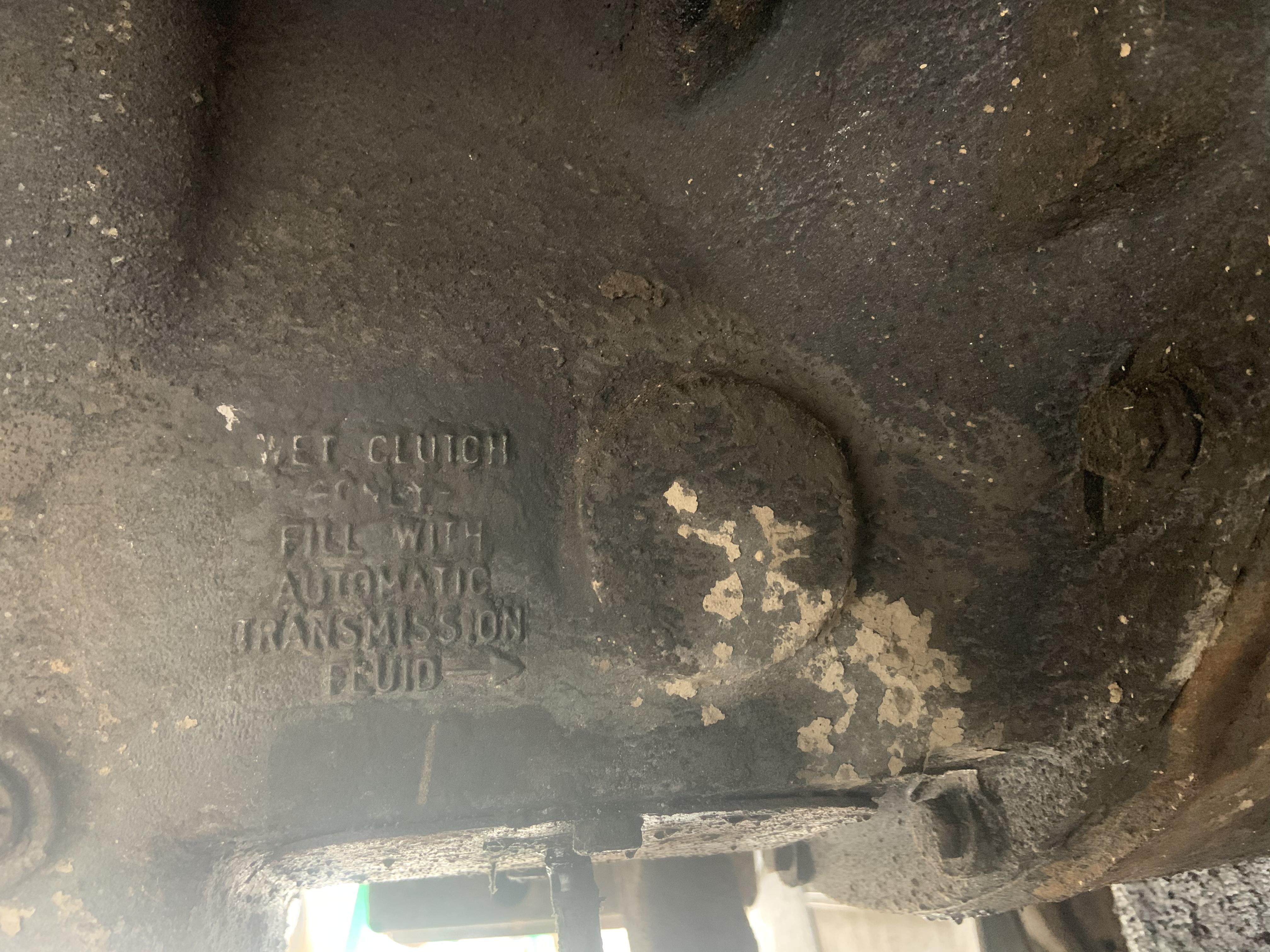

  7. Terry It is not a plug, prolly where a plug was supposed to go IF it had a wet clutch lol. I wasn't sure about it which was the reason for asking, the bottom plate and grease tube threw me off, just dbl checking since its my first big truck . Thanks everyone.
  8. Recently purchased a R686ST that has a Mack T2090 Mack reman transmission. On the passenger side near the bell housing it says, wet clutch only fill with automatic transmission fluid. What reservoir is it referring to? And will appreciate any tips or info on maintenance/dos and don’ts Thanks.

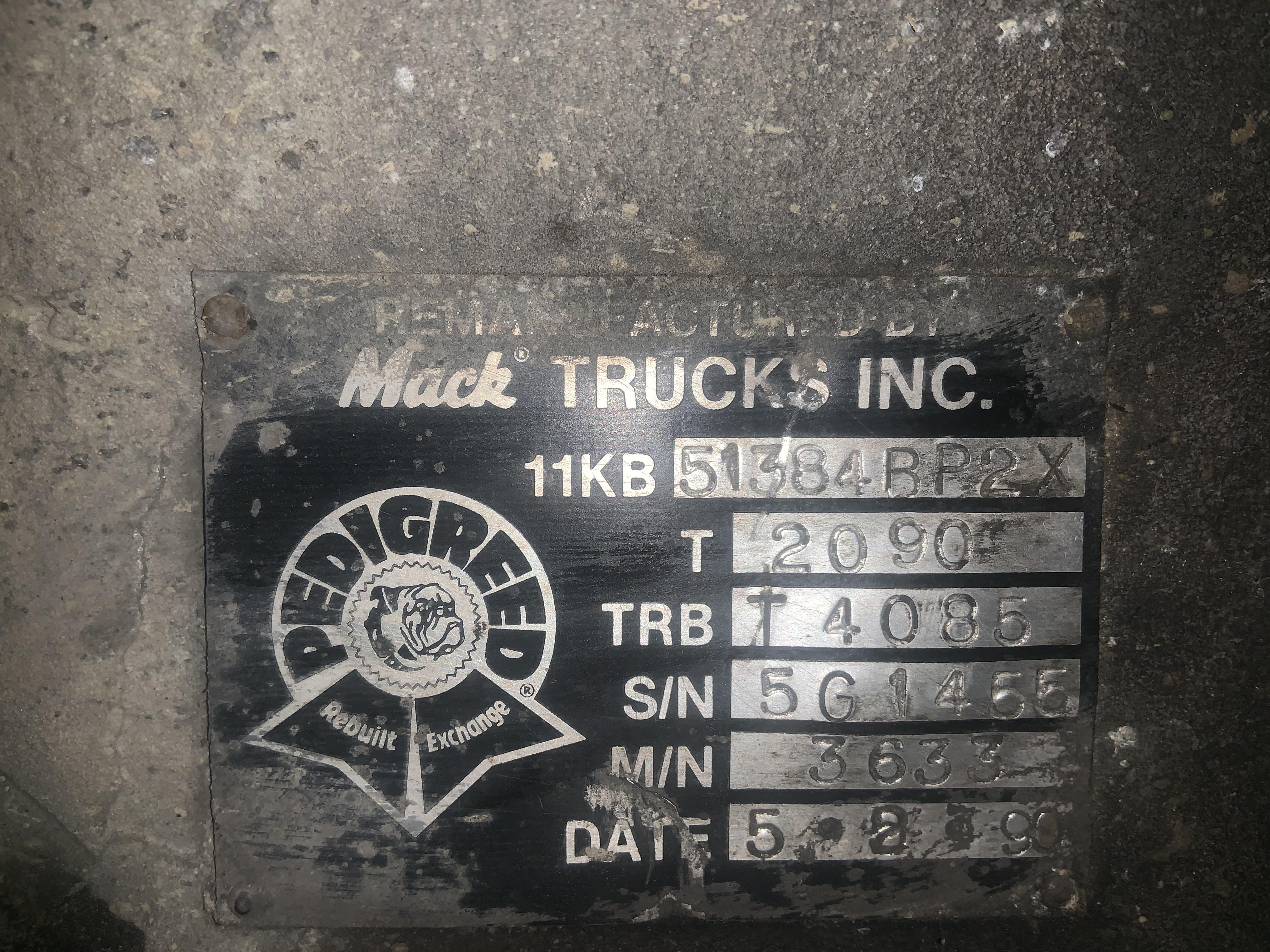

  10. Well fellas just wanted to post that I’m a owner of an r model Mack. The Mack dealer said the motor it came out with was an E6 300 the transmission was a T2090 9 speed OD and the gear ratio was 464. Transmission has a tag that confirms it is a T2090 Mack reman on September of 1990. Looking to get started on a complete fluids change and service. It runs great and is really fast. The rpms at wide open throttle are at 2350-2400 I read somewhere that it should be 2100. Is that an indicator of a air leak or a turned up fuel pump and do I need to be concerned and have it set back? Thx
