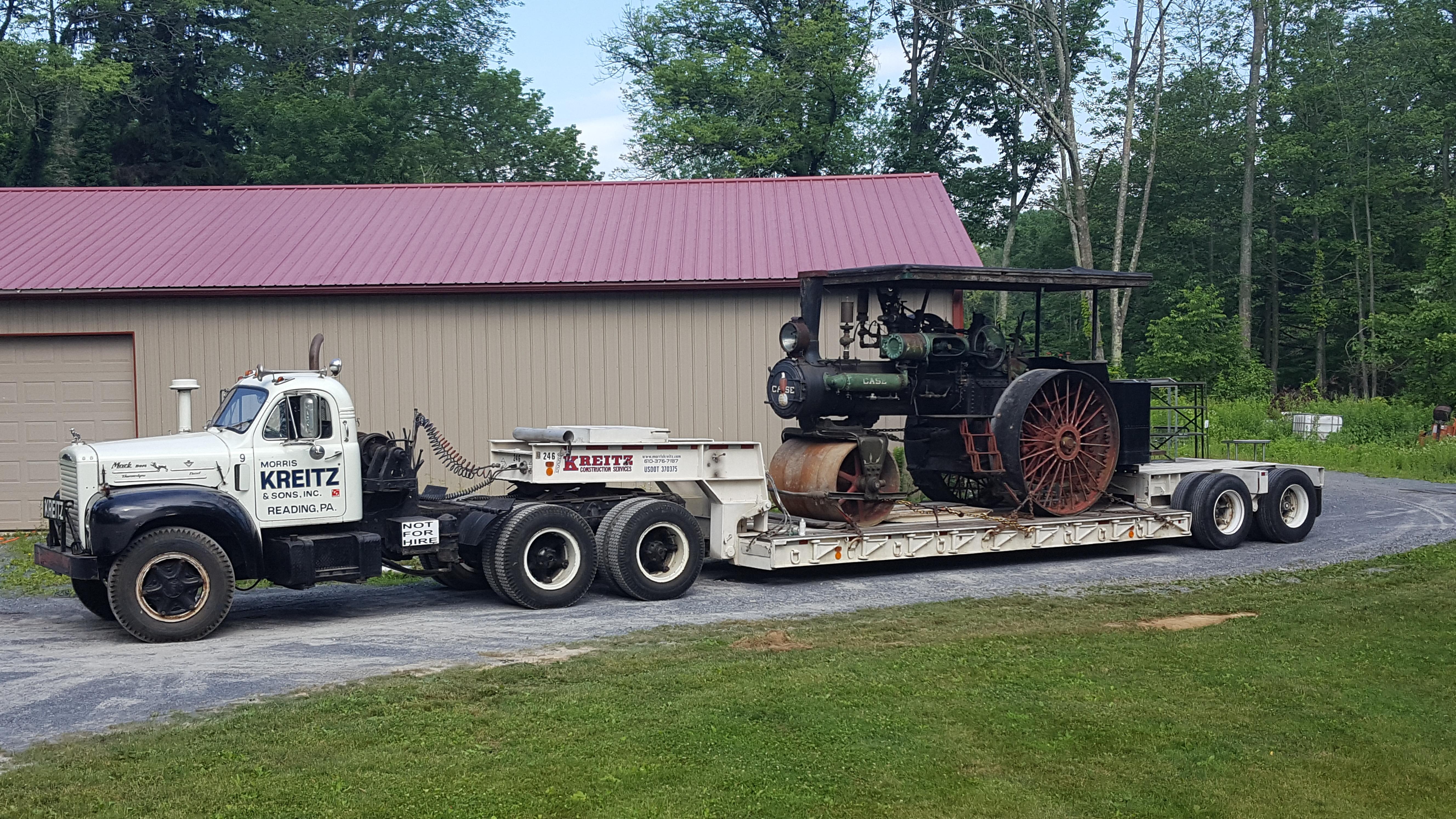

  4. Can you fill me in on the TYPE 20 Chambers. I did pull my chamber apart and found just like you said. Seal Wagner # AD29-56 and a rusted/corroded cylinder. I did find the $235 rebuild kit online.

  8. Thank you all for the wishes and the solid info you gave me. Thank you Fuzzy Buzzard for those numbers, that makes it super easy. The next trip I make will be this week to take the steamer to Hay Creek festival. I will have the truck and roller at the show all weekend. Thanks again!
