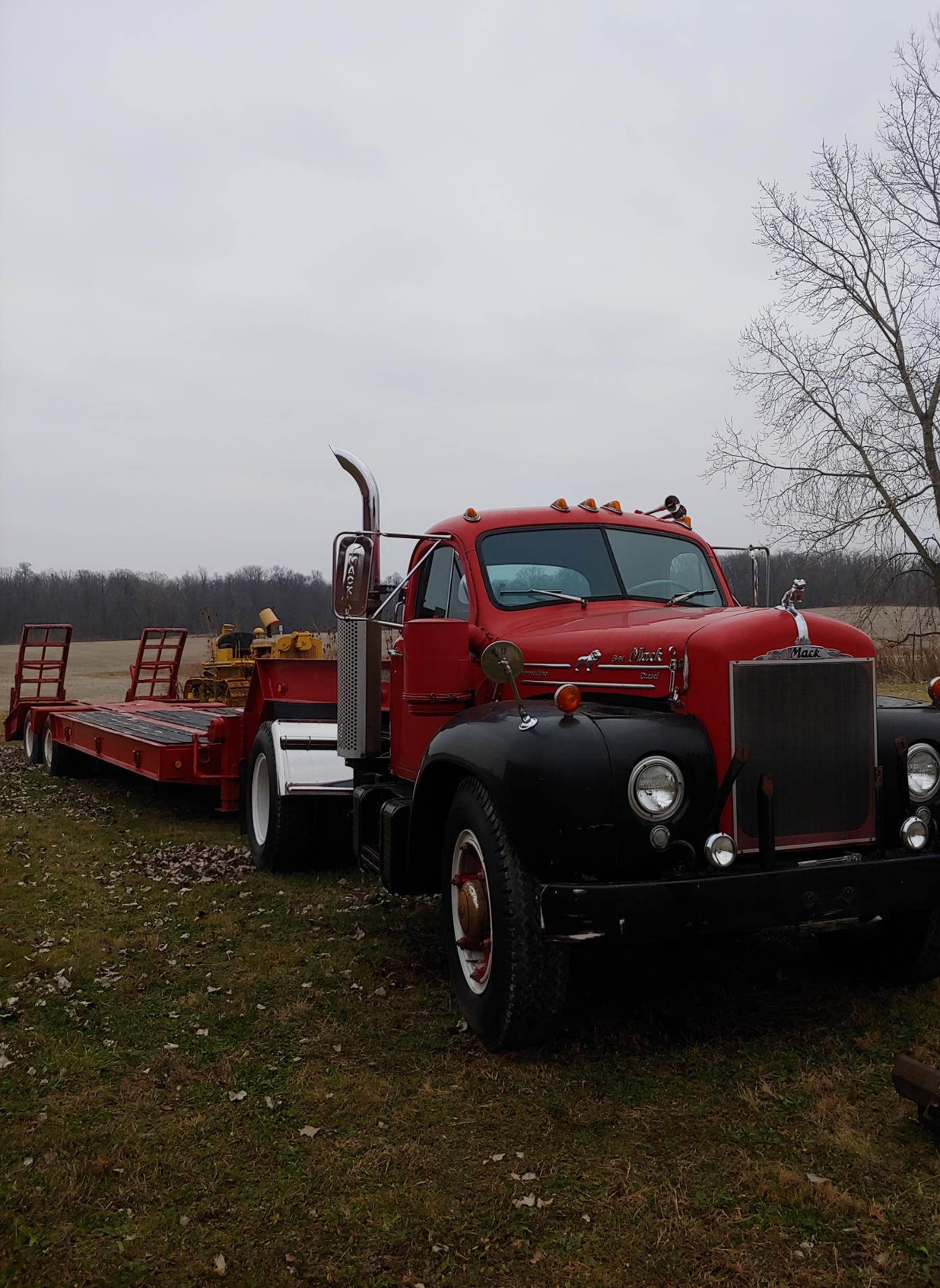

  1. I had mentioned in an earlier post that I may have one for sale. Here are some pictures. I can send more pictures but this was the max allowed. Thanks 502-640-2065

  3. For what it's worth, the trailer may be able to be pulled but it has been sitting. It looks good but I know there are some spring brackets that are questionable. I am adding a picture of both.
