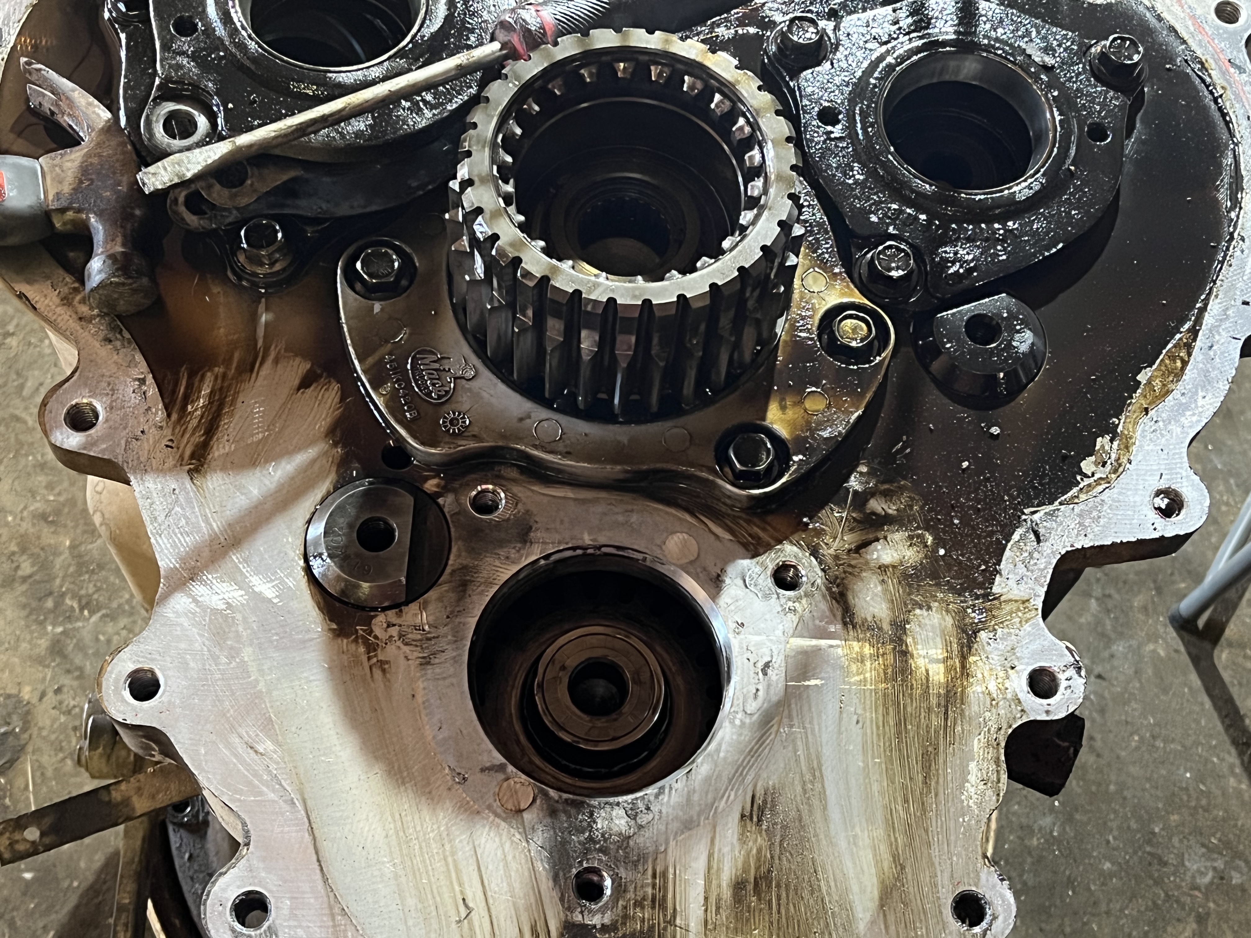

  12. The 18 I have came out of a Mack chu with 3.56 rears I believe, so it has the correct bell housing an top plate. I know the drive shaft with need to be redone an that’s no biggie. Only difference between the truck it came out of is mine has 3.63
  13. It’s just a standard T310 (105yx). I’m just thinking why rebuild it when I have to perfectly good transmissions laying in the shop, a 13 and 18 Eaton. All my out Mack’s have either the Mdrive or Eaton. I swapped one years ago in a 2004 ch. it had same transmission an I put a 8ll in its place.
  14. The 18 I have is a RTLO18918B. Yeah when the ground is really soft we normally push with dozer or skidder.
  15. Ok thanks, this is the only Mack I have with the Mack transmission besides the Mdrive. The others have Eaton. I’ve got a 13 and a 18 was hoping to be able to use one.
