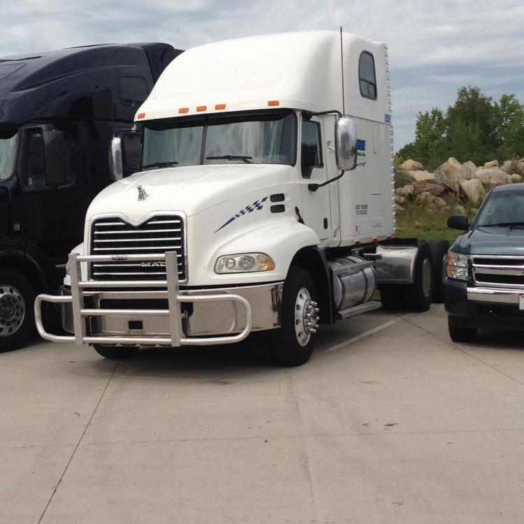

  3. 2007 Mack CXP-613 MP-7 2 pedal Ultra shift 10speed 3:55 rears, 860000 miles new turbo, engine harness, fuel pump/power steering pump, EGR DELETE PROGRAM, clutch done at 550000 miles, has a good Dyno, and oil samples, still running truck but need to sell in next couple weeks.. $17,500 OBO call or text 715-892-3013 Thanks
