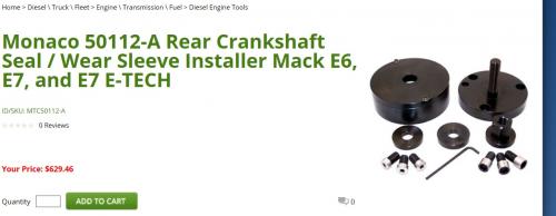

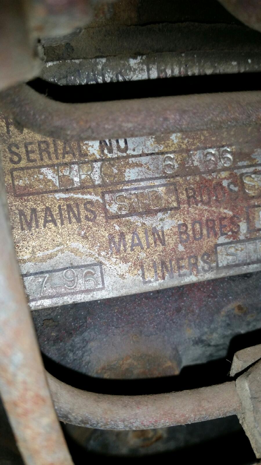

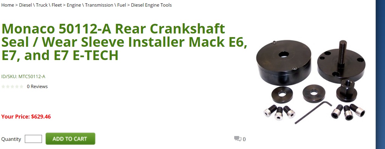

  5. Hey Folks! I posted a couple of these tag pictures before, but... Is this the tool I need (okay, can probably do it without it) to put in my new rear main seal/wear ring?

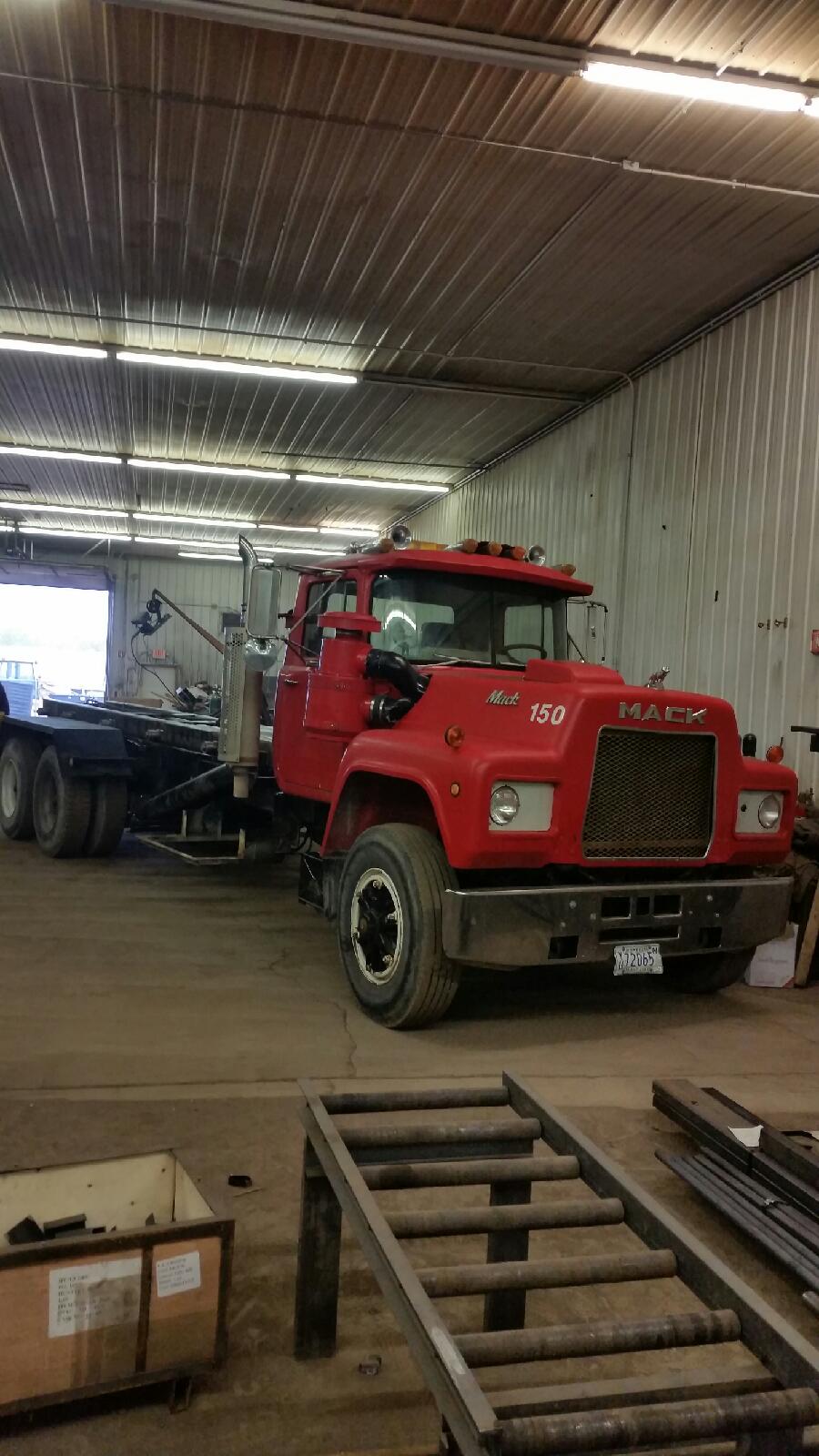

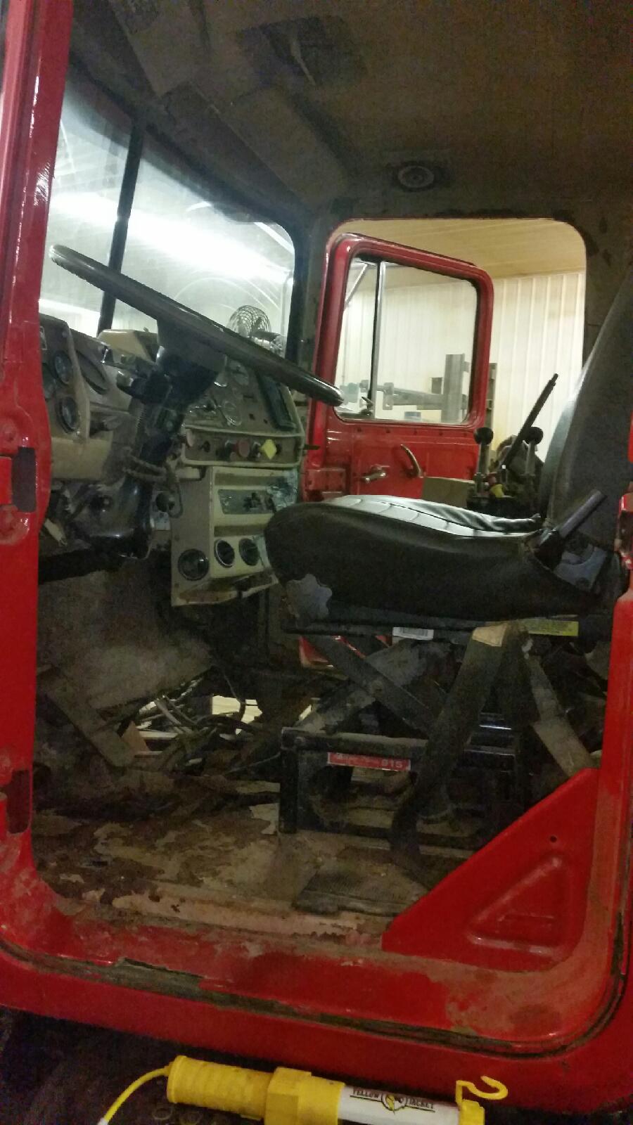

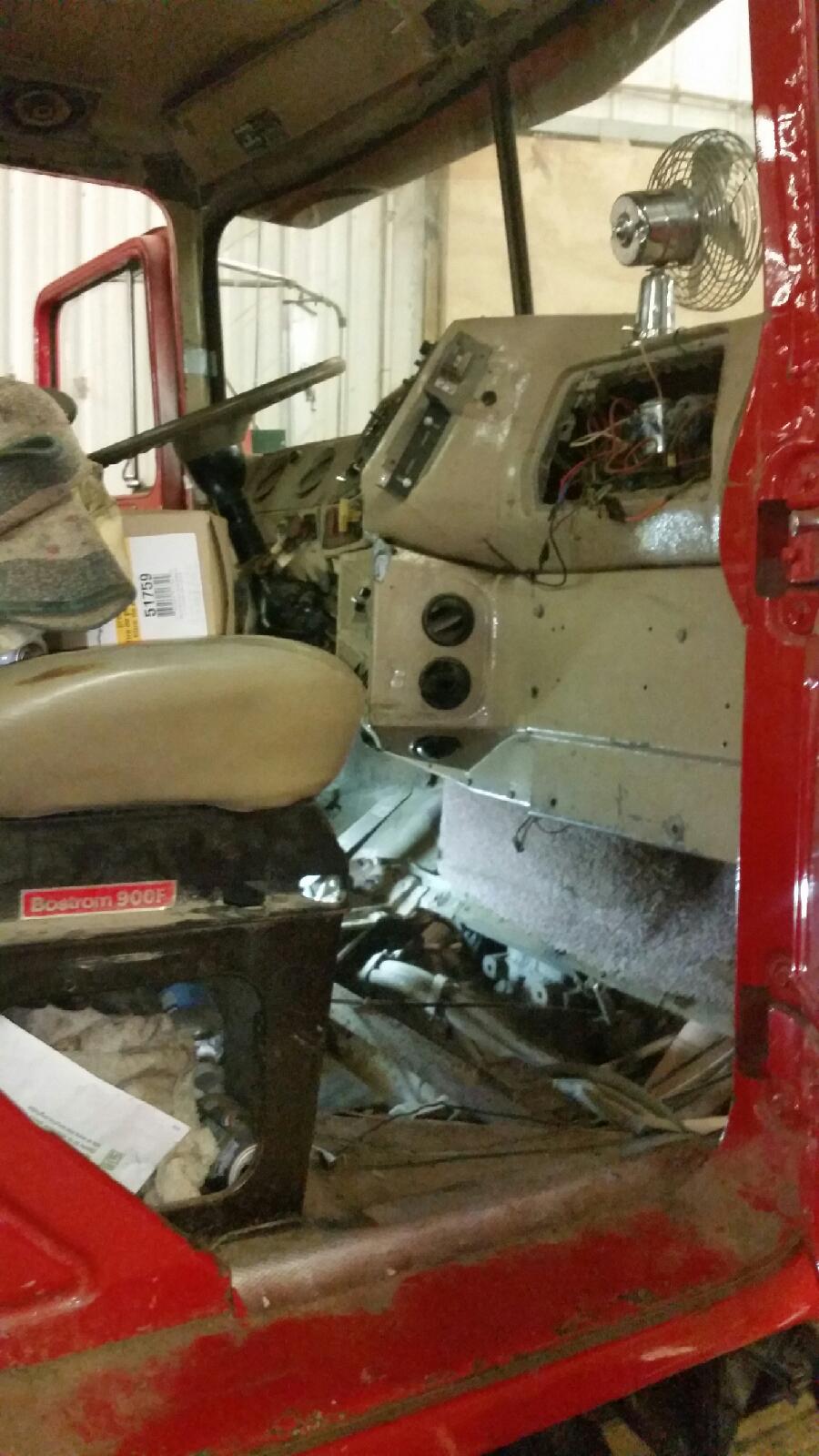

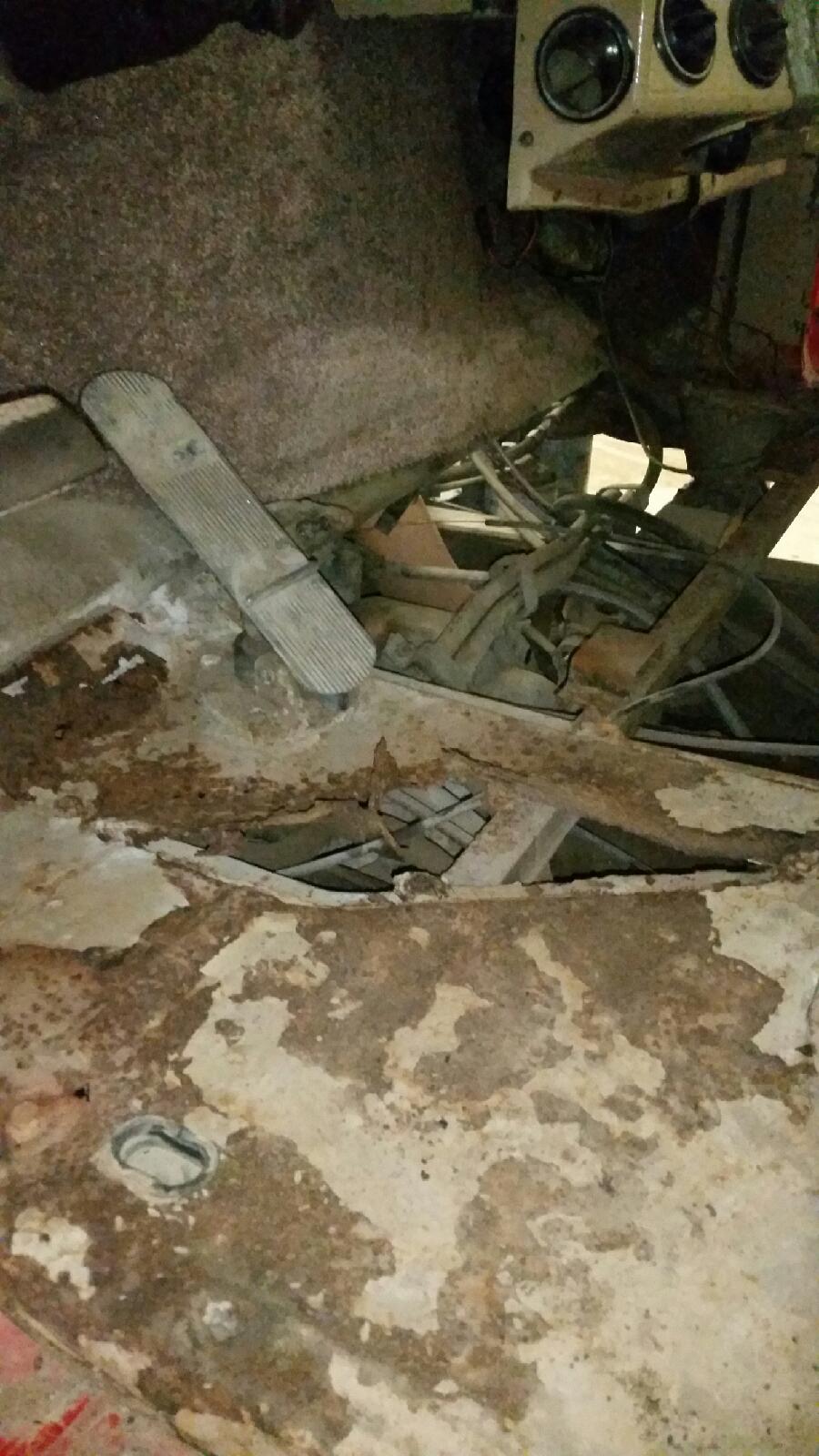

  8. Unfortunately, I haven't had a whole lot of time to get far on it... But I'm "kinda sorta" working on my RD. I built a new roll off hoist for it... Needed a clutch, trans front and rear seal were leaking, pto was leaking, rear main was leaking... So... If a guy has to pull the floor boards out to get at the trans mounts, may as well keep going, right? =) Whats my point? heh I'm looking for ideas for what to do with the interior! I've looked through some of the pictures here on bigmacktrucks, but I still have a long ways to go! I'm going to dynamat (or equivalent) everything inside, and the "kick panel" may be a good place to use that piece of aluminum deck plate that has been leaning up against the wall for 6 months! Don't think I care too much about keeping anything original (part of me thinks it would be cool, but part of me thinks it would be awesome to have the exterior of a '80 RD, but the interior of a plush high rise condo) Attached is the start... Hopefully I can spend some time with it... Charlie

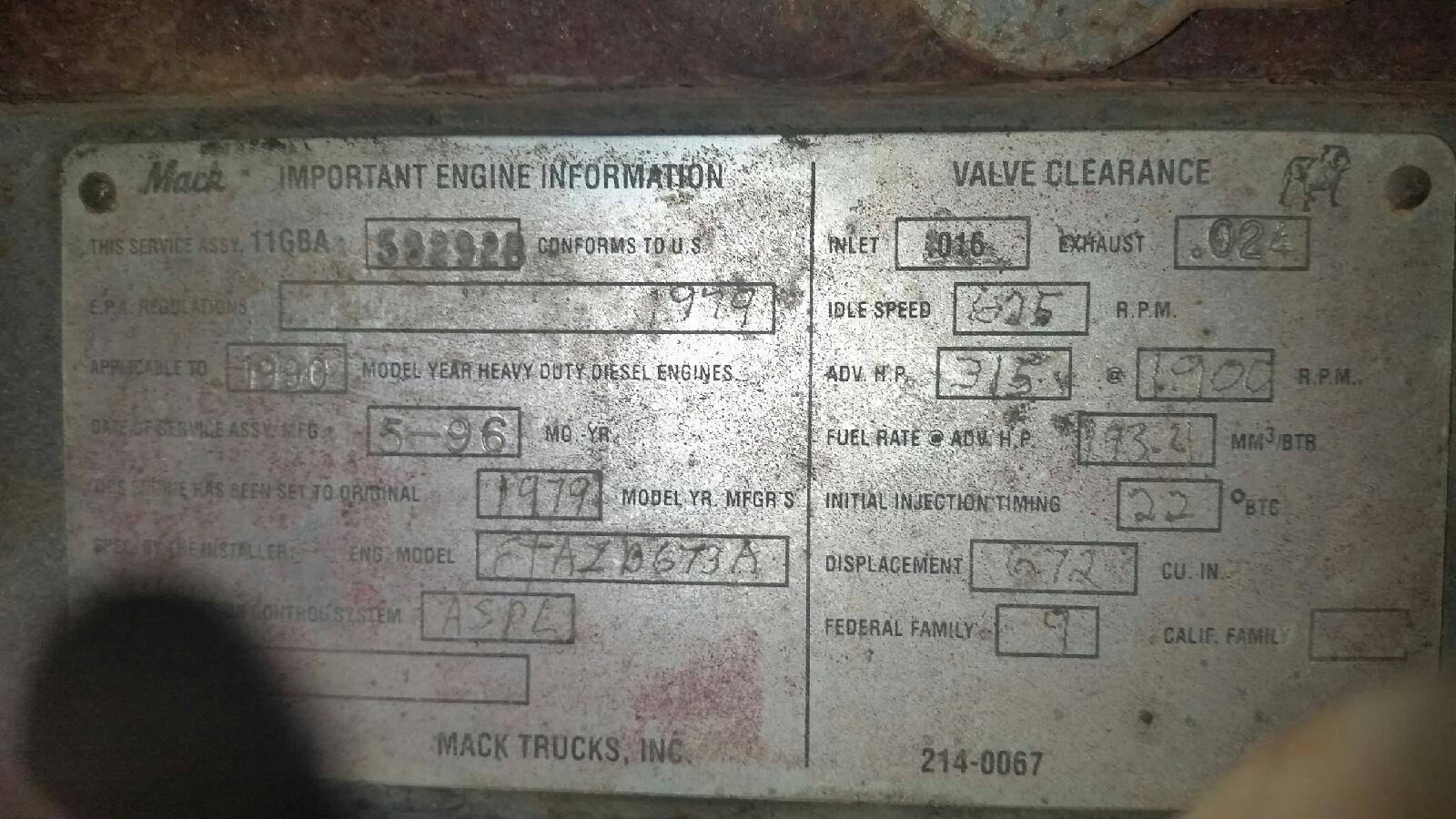

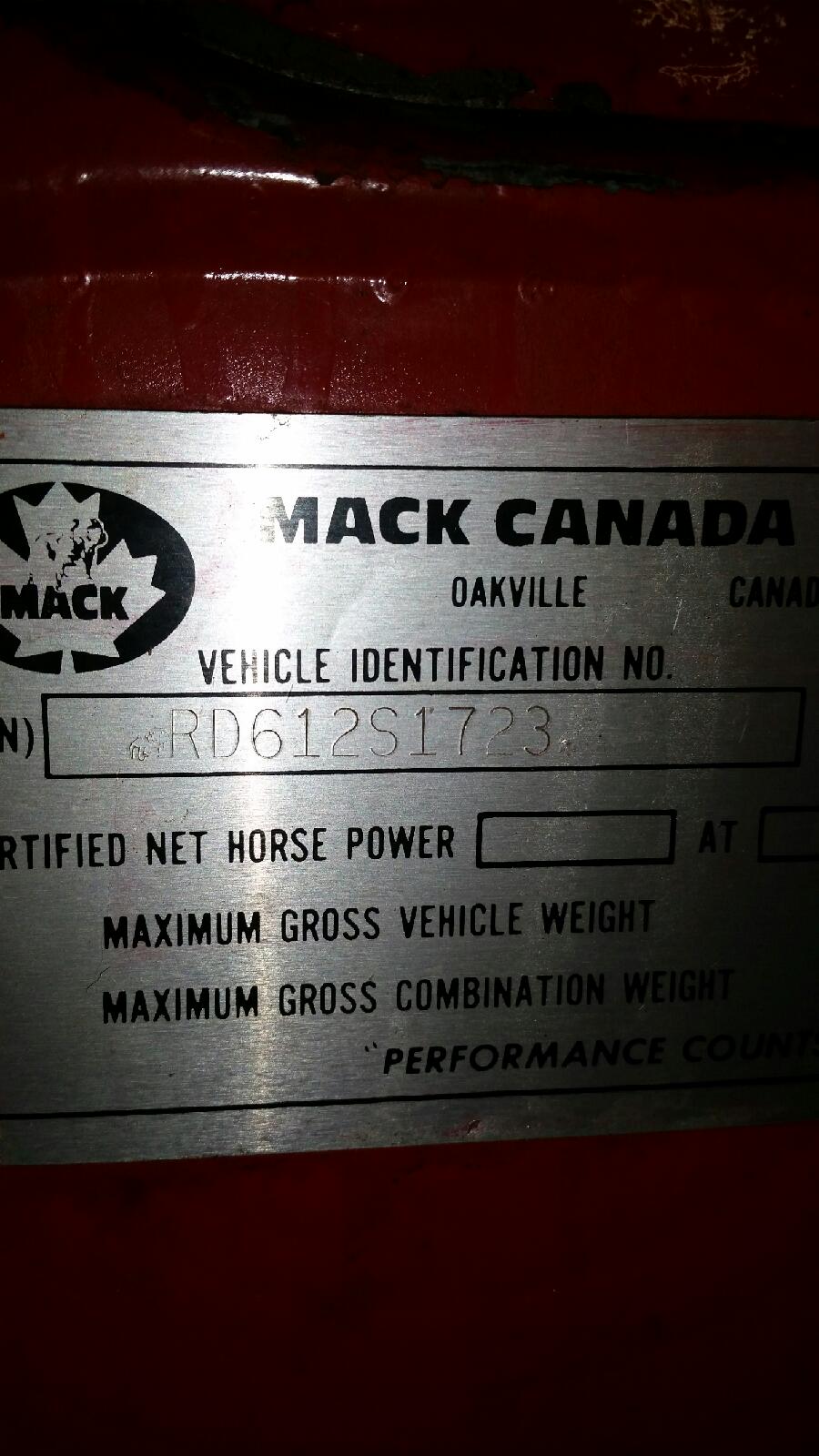

  9. Hey folks! Attached should be the engine tag from my 1980 Mack RD. It currently has 4" exhaust on it, and I have to re-do the exhaust. My question... Is there a power gain going from 4" to 6" exhaust? IF I was to do it... It would have to stay 4" just over 3 feet past the turbo (no room to squeeze anything bigger in there), then it could go to 6".. It would be 6" for another 2 feet, and then go to dual 6" if I was to do it. If all that makes sense.... Half the truck guys I talk to say I wouldn't notice the difference... The other half say that the first half is nuts, that I will notice the difference for sure. If I was to do it, now is the time... I would do it if I know for sure that there would be any gain at all, no matter how little. Question is, would there be? My gut tells me I would not notice a difference, but I'm thinking if I could do it closer to the turbo I might... Whatcha think? Thanks, Charlie
  10. And another thing... Going off the vin#, this truck is only supposed to be a single axle.... But its not! I'm not sure how much of it has been changed/modified from its glory days...

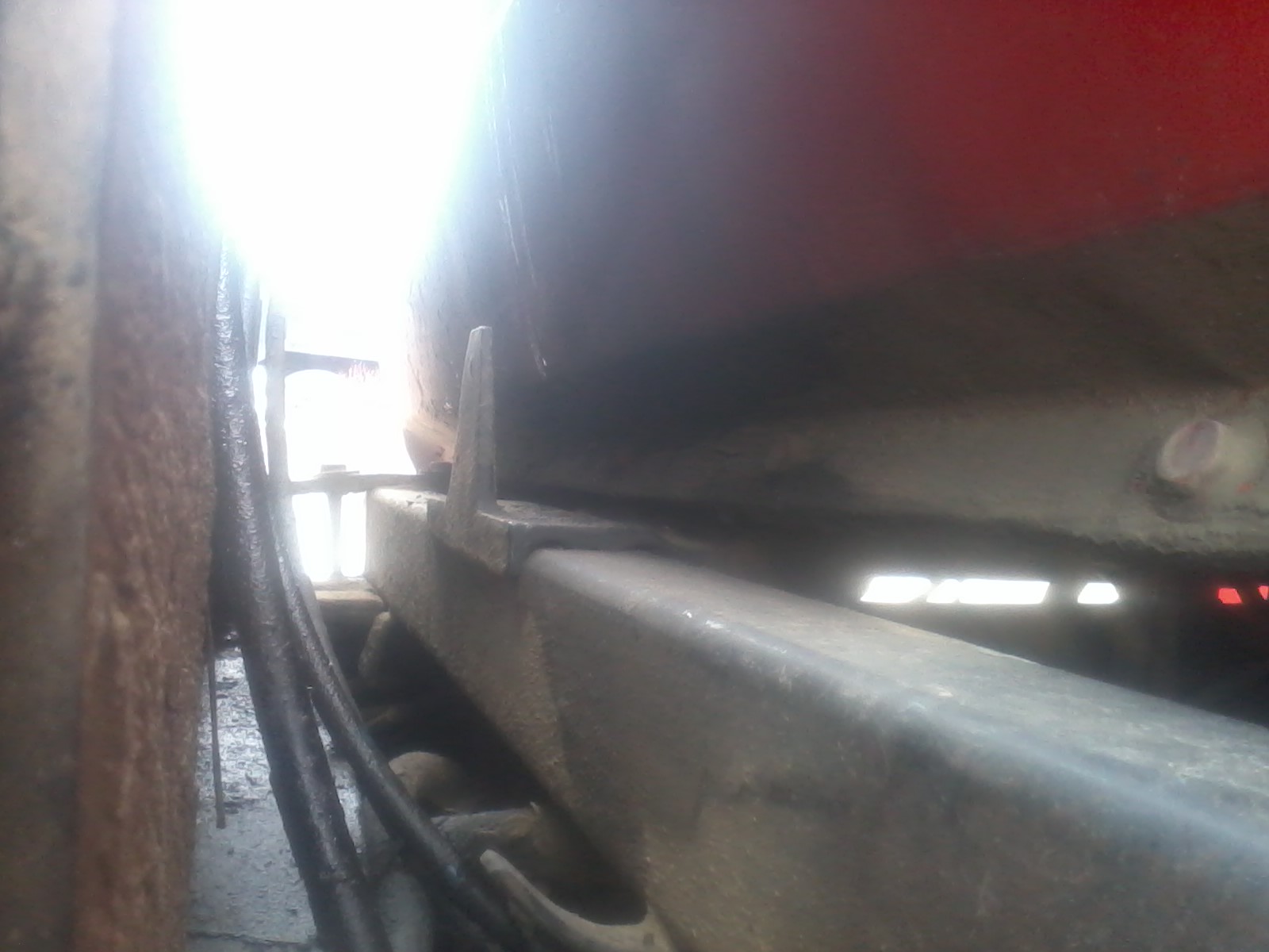

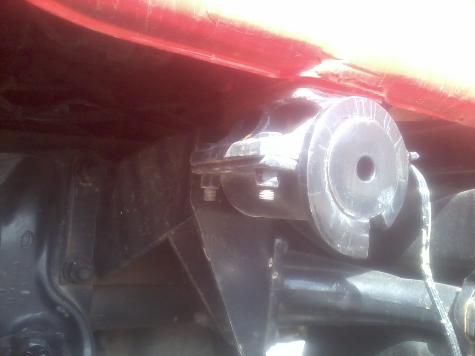

  11. See if those pictures work... The front of the cab has what I would call pivoting mounts... Second picture is the back of the cab. (if they load) The radiator does have rods going to the firewall, but the radiator is mounted on the bottom, with rubber mounts, almost like it is supposed to pivot... But, that's just my impression. The hood to cab rest... The hood has a rubber block, the cab has a 4"? diameter round plate at an angle. Once again, giving me the impression that its there to allow movement.
