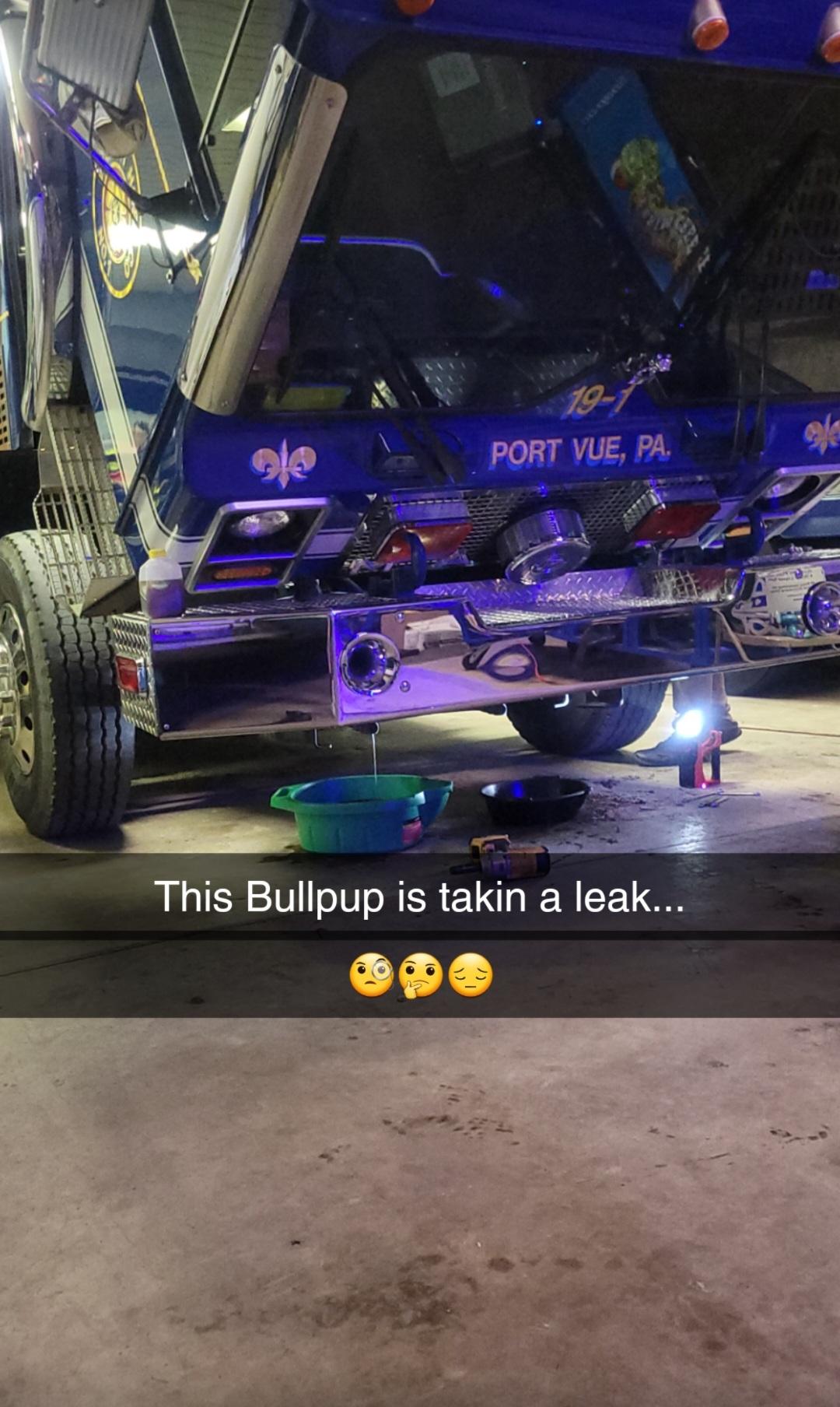

  3. No sir we changed the gasket with the radiator still in the truck. That was the only thing wet and place that coolant was coming from. So the more I'm thinking here the worst is it possibly a headgastet? Did the system over pressurize and push the gasket out? The radiator cap looks factory but if it did over pressurize why wouldn't it of pushed out the cap? Sorry for rambling but just trying to think of a few possibilities. We are 100% volunteer, 100% self funded, with quite a few mechanically inclined people within our department. So we'd love to fix this in house before sending it the a shop.
  4. Question, has anyone ever changed the lower radiator gasket on a MR before? We changed our 1995 due to it leaking. Changed it with a new cork gasket from Mack, everything was good and it lasted a few days and it just started leaking from the sides again.
