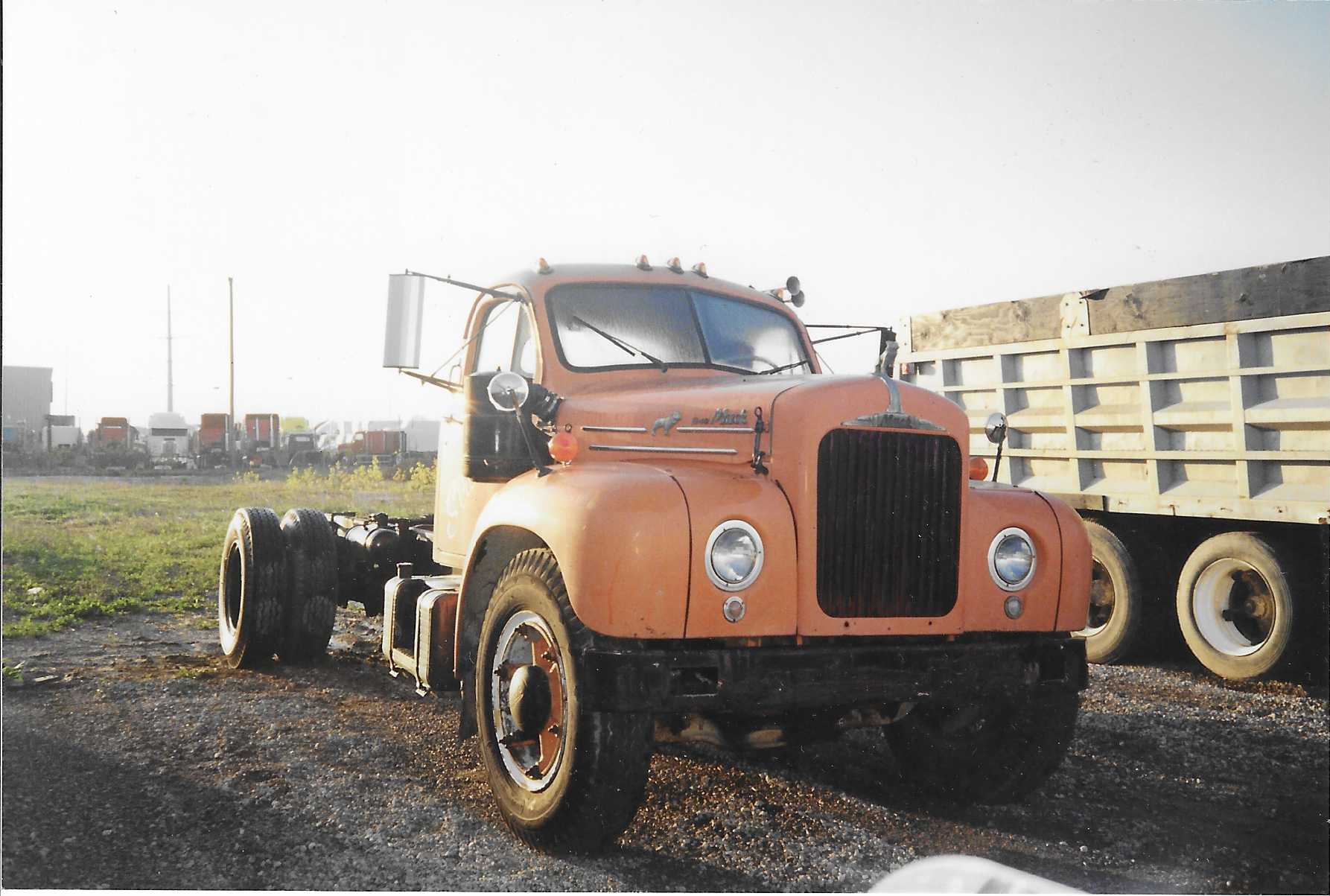

Photo I found of a Yellow Transit Freight Lines EUHT in the Yellow Dallas shop mid 1940's. Little bit before my time at Yellow.

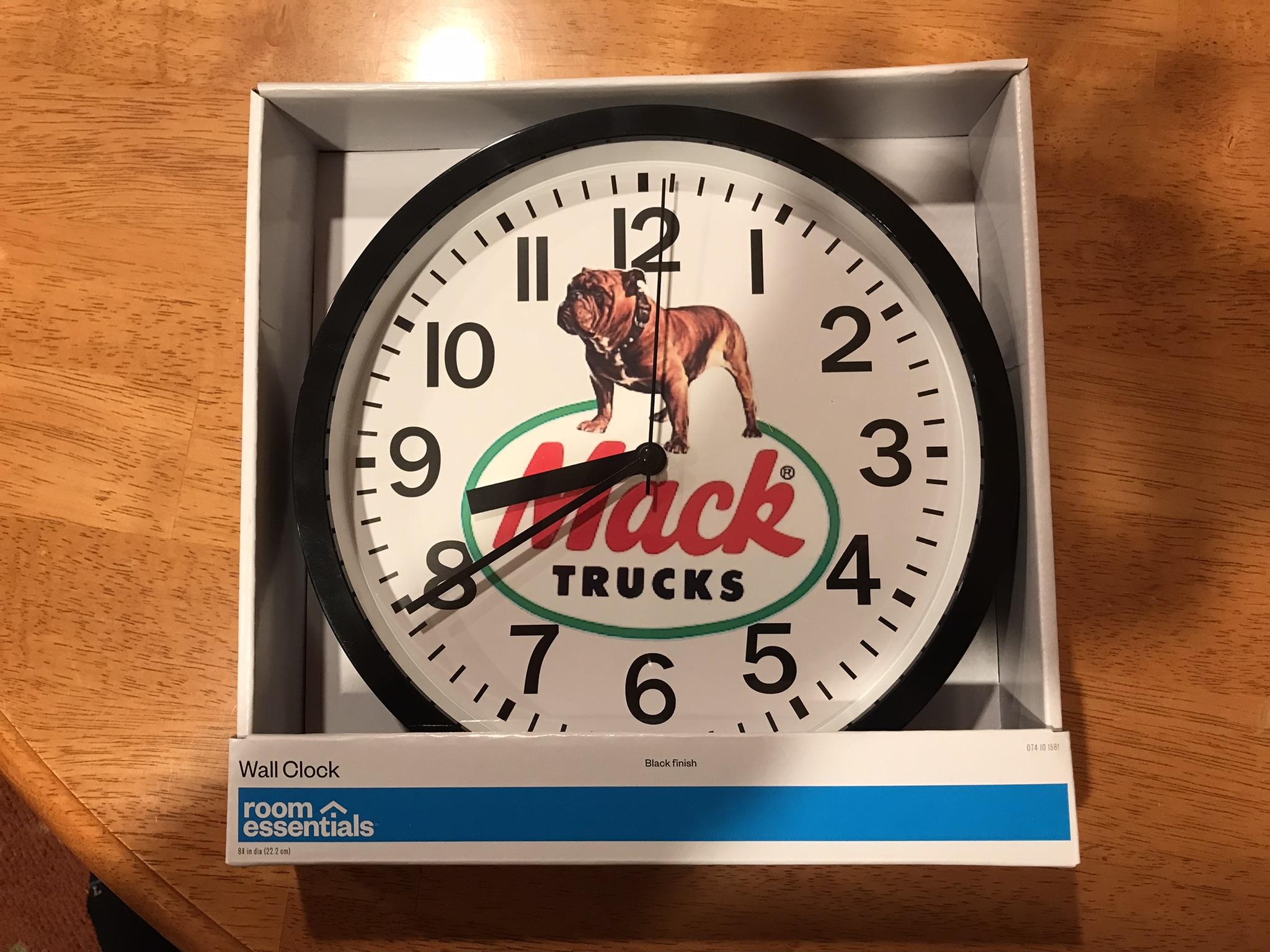

Something to keep you busy on a cold dark winter's night. Target sells a plain 9" battery wall clock for $4.99. 5 screws and the glass and cover is off. Gently pry off the hands noting their original position. Pick up a pack of vinyl sticker paper either at Target or Walmart. Below I have attached the Mack logo properly sized for this clock (double check size by printing on regular paper first as you may have to slightly resize it after download). Set you inkjet printer to the highest quality. Print it out and let it sit for a few hours to completely dry the ink so you don't smudge it. Carefully cut it out and punch or cut a 7/16" hole in the center. Apply the decal/sticker to the face, install the hands, assemble the cover, install a single AA battery, set the time and you'll have a great addition to your shop. I have done this on larger clocks and even circular outdoor thermometers by resizing the logo. Also have done a few other makes for friends by searching the web and downloading their logos.
