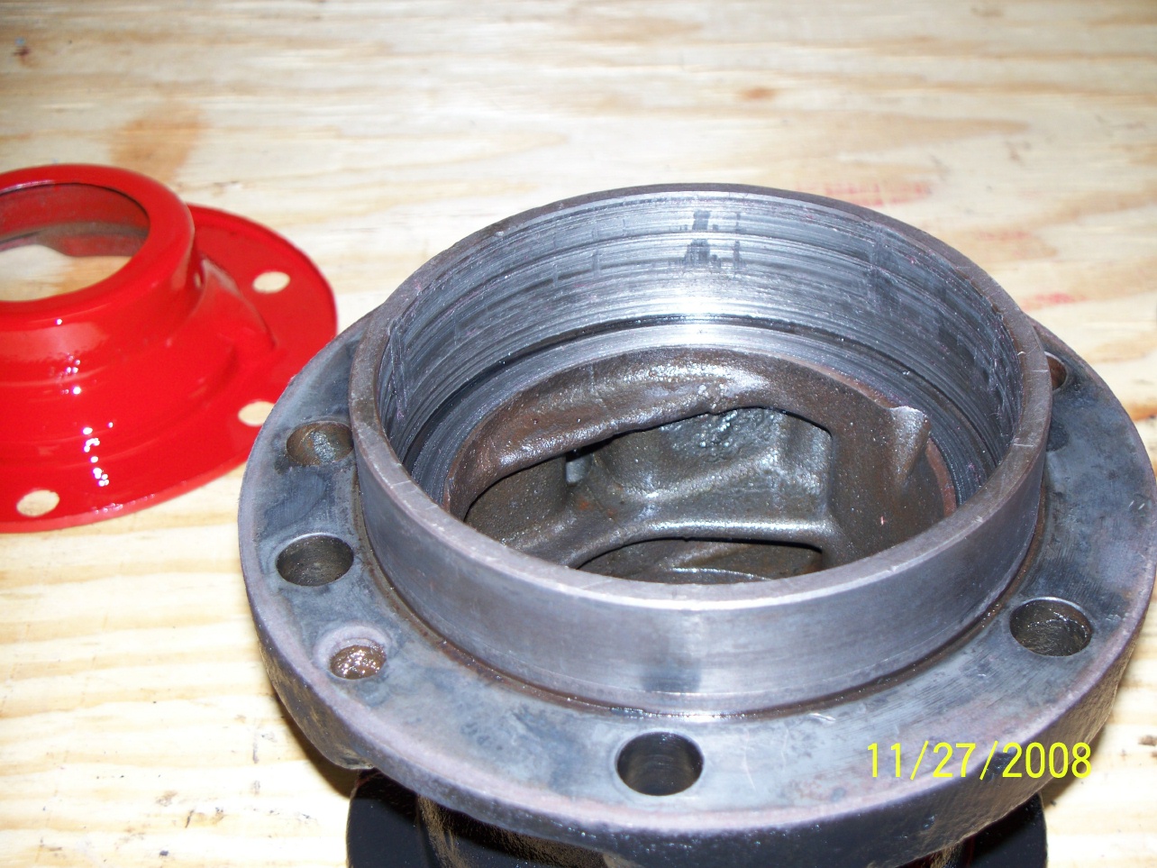

	of course as things go it could not have been a quick fix to replace the bearing/race. I found that the race for the inner pinion bearing had spun in the housing and also the inner pinion bearing spun and welded itself to the pinion. the removel of the old bearing was interesting had to use the hot wrench and carefully cut it off found some small gouges and high spots on the pinion, cleaned it up in the lathe and installed the new bearing all good there, now the pinion housing, the new race just dropped into the housing, this was not good so i cut down all the rough spots in the housing so the race would sit level there was some side to side play ~.0005 of an inch, two choices either bore the housing and install a bushing around the race to be able to press fit the parts or JB weld the new race in, i took the easier of the two... JB welded the race in, assembled pinioin/bearings to center the race and allowed to dry, installed pinion assembly this morning, filled with GO-J and were back on the road.... see pic of pinion housing where the race spun
	Hey All, pulled center section apart today i found that it was the inner pinion bearing that failed, the cage that holds the roller bearings in place got shredded somehow and a few of the rollers got out, it appears that 4 were missing and were getting chewed up, found two rollers and alot of metal shavings in the bottom of the carrier, fortuneatly all the gears are intact with the exception of one that has a small chip out of it hopefully i can just replace the bearings/races and get back on the road Mike
