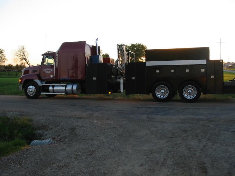

This CH 613 has been done for about 7 months now sorry it took so long to post the completed truck hope everyone enjoys the pictures. My wife and I had a lot of fun working on this truck. We bought an OTR truck and stretched it 12 in the middle doubled the frame and built the bed ourselves. The Air compressor, Plasma torch and welder are built in to the front cabinets. The front curb side cabinets contain two sets of snap on tool boxes. In the upper cabinet a where the air and lube reels are stored. The cabinets over the wheels contain slide drawer tool bins. Rear cabinet contains Drill Press, fire extinguishers, and Wheel chalks. The driver’s side front cabinet has welding supplies in it with the face of a Trail blazer exposed to the inside of the cabinet. The second Back has a bolt bin in it. Over the wheel cabinets contain DOT air line fittings; hi pressure steel fittings, wiring supplies, Hydraulic adapters and fittings. The rear cabinet contains Torch set and all welder leads, and extension cords. On the upper cabinets all metric bolts and a full line of hydraulic crimp fittings and the machine to crimp them are stored. thumb.gif
