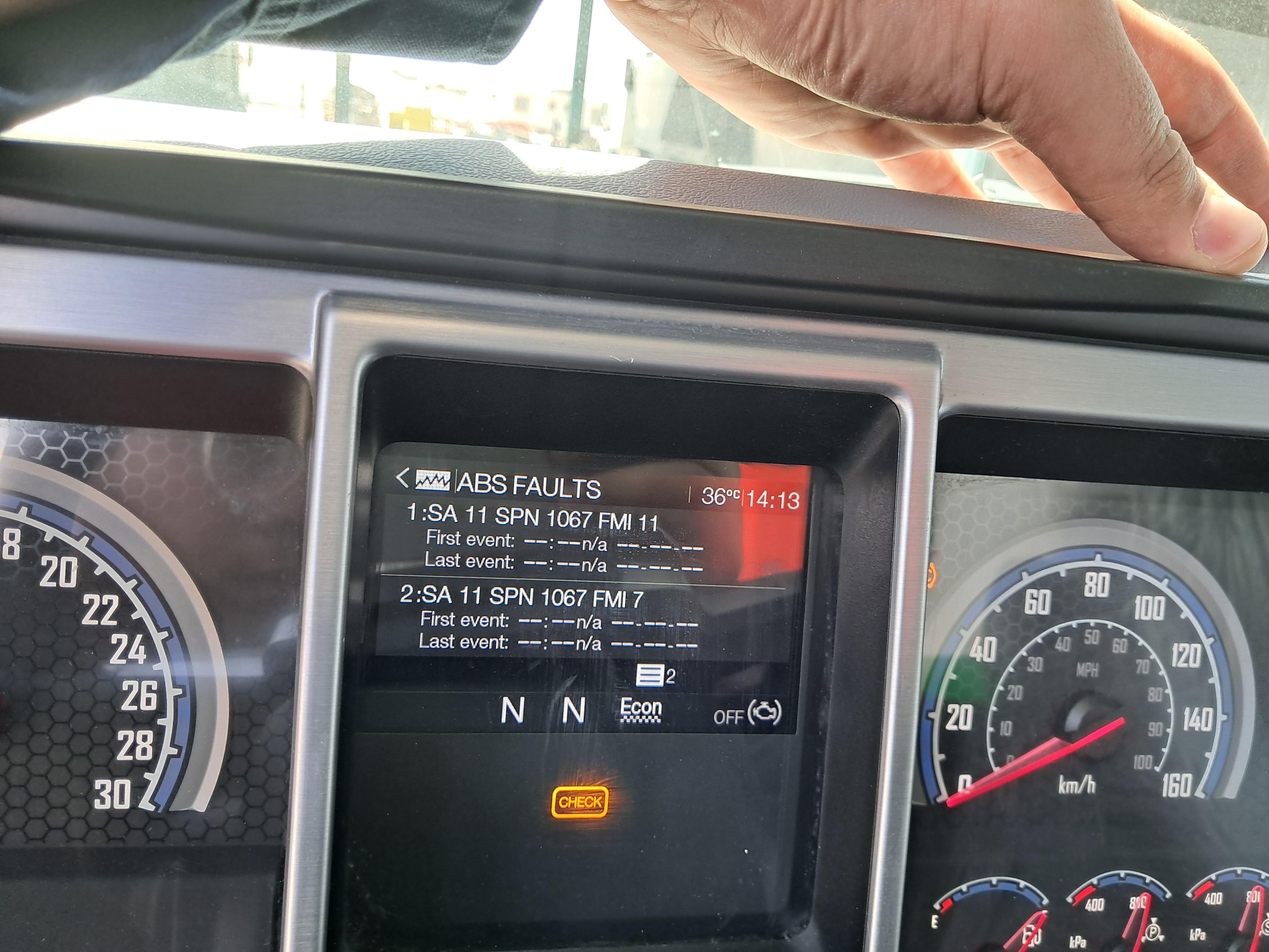

Hello
I have two error codes on my truck as seen in the attached, I tried to use the Acom but its no help I can't connect through VOCOm ii or DB xl, I replaced the ABS ECU and both brake sensors SP1, SP2
But it's no use, I'm still having the same issue.
Can any body help please

A little in the wrong spot, but it's alright. It's not 100% because I can't diagnose anything over the air, but I can't help but wonder if your ABS "transducers" are faulting. They're the pressure sensors in the passthrough, usually near the brake pedal.
image.png.103184126373cb44d4882c9836cdca35.pngThey look like this, US part number is 22443498. Don't know if that's the same for Jordan or not!
