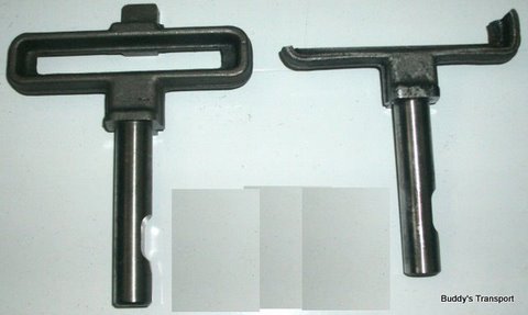

The air piston the actuates that low gear is to the drivers side of the shift tower. The low hole will only work in 1st speed as there is a lock out preventing it to engage in any other gear. I had a simular problem so i removed the shift plate on top of tranny wich is the one that the shift tower connects to and low and behold the lock out was broke and the broke piece was probaly chewed up by the tranny. if i can figure out how to post a pic i have a good lock out mechanism and i will post it up. I learned a lot about this tranny in a very short time. Some of the experts on this site guided me through it so you came to the right place. HOOOAH!

Okay, they look like the same kind of lock out I remember from the first MaxiTorque transmissions. I'm guessing that the notch in the shaft somehow locks into something when you engage low and prevents you from shifting to another gear. Looks like someone tried to override the lockout.
Had a driver many years have a truck run away on a hill, said he tried to down shift but never got it to go in gear. Funny thing the spiral twist in the drive shaft and the crushed lifters in the engine and exploded clutch tell me he sure did get it to go in to a lower gear!

this is a broken and a good lock out

that notch is where the detent ball sits!!
Well I did get a little time to work on truck Tuesday. Removed air line from rear of the cylinder that is next to the shift lever and now when toggle valve on dash is put in the "Extended Range" position it snaps in and shift lever is locked into low gear by the lock pictured in above post.

Ken, the constant air coming from that air line returns the shift fork to the normal position when you flip the air switch on the dash. The trick is the air pressure coming from the air switch has to be greater to engage the low hole shifter. Once you flip the switch to normal position that air pressure returns the the shift fork to direct hence the lock out releases the shifter. if that makes any sense :pat:
