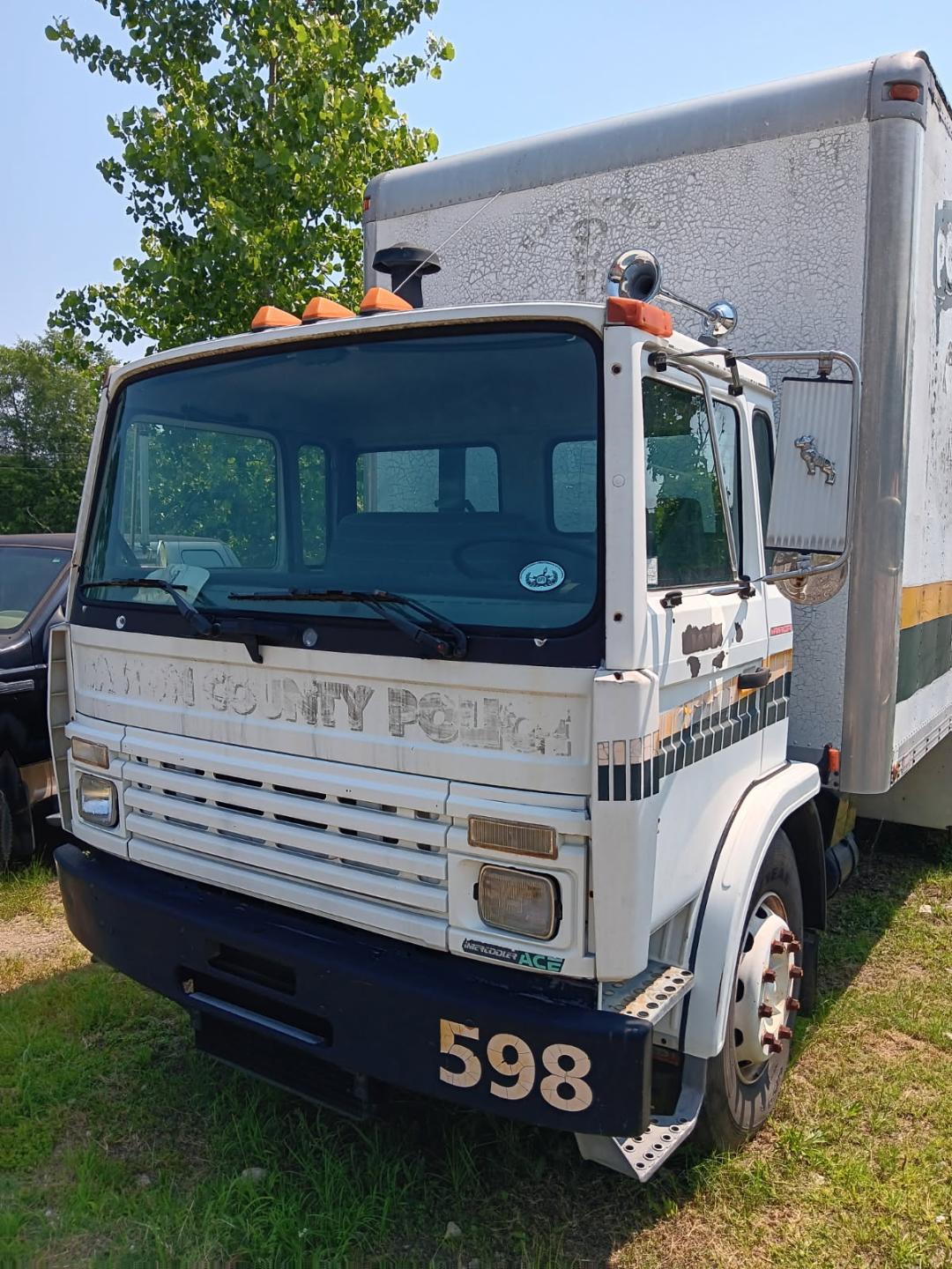

  4. @mechohaulic My 98 MS 200P does not have any Mack Logo on the cab only the Bulldogs on the Mirrors was the give away, but the earlier models1st Gen Midliners did in the 80's looking at picture of them. When I 1st saw what is now my truck from about 100 yard away I 1st thought it was a old Volvo cabover.
  5. Oh I was wrong its a MS 200 P
  6. 1998 MS 200

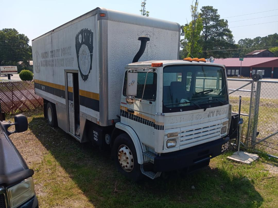

  7. Well the Midliner has landed< I gave her a quick once over checking fluids, coolant and for leaks of anything and tire pressures and added 15 gallons of fresh diesel into the tank along with Lucas Fuel additive. Add with the plate secured on the back we set off with my buddy following behind in my HD3500 just in case we had some issues. But other than the tach & some lights not working and the the trip was uneventful. She ran fine rides surprisingly well, I think that body is heavy.... But not going to set any land speed records in this rig that's for sure... But I also don't know if maybe they have the throttle limited cause this used to be a County Truck. We shall see after I really start digging into her. But she does have some neat decals inside that will have to stay. But the wood shelves on the left side are the 1st to go... Might also see if I can rig up a (shore power) plug for the rear body. She has AC/heat in the back all wired in but I guess the Gen set was removed before she went up on auction but has plenty of lights and outlets already wired into the box. Which will reduce my workload to making her an RV. @Joey Mack Yes I'm in North Carolina still didn't stray too far from Ft Bragg after being medically retired in 2016. So any copies of anything from your manuals would be amazing and thank you for the offer.
