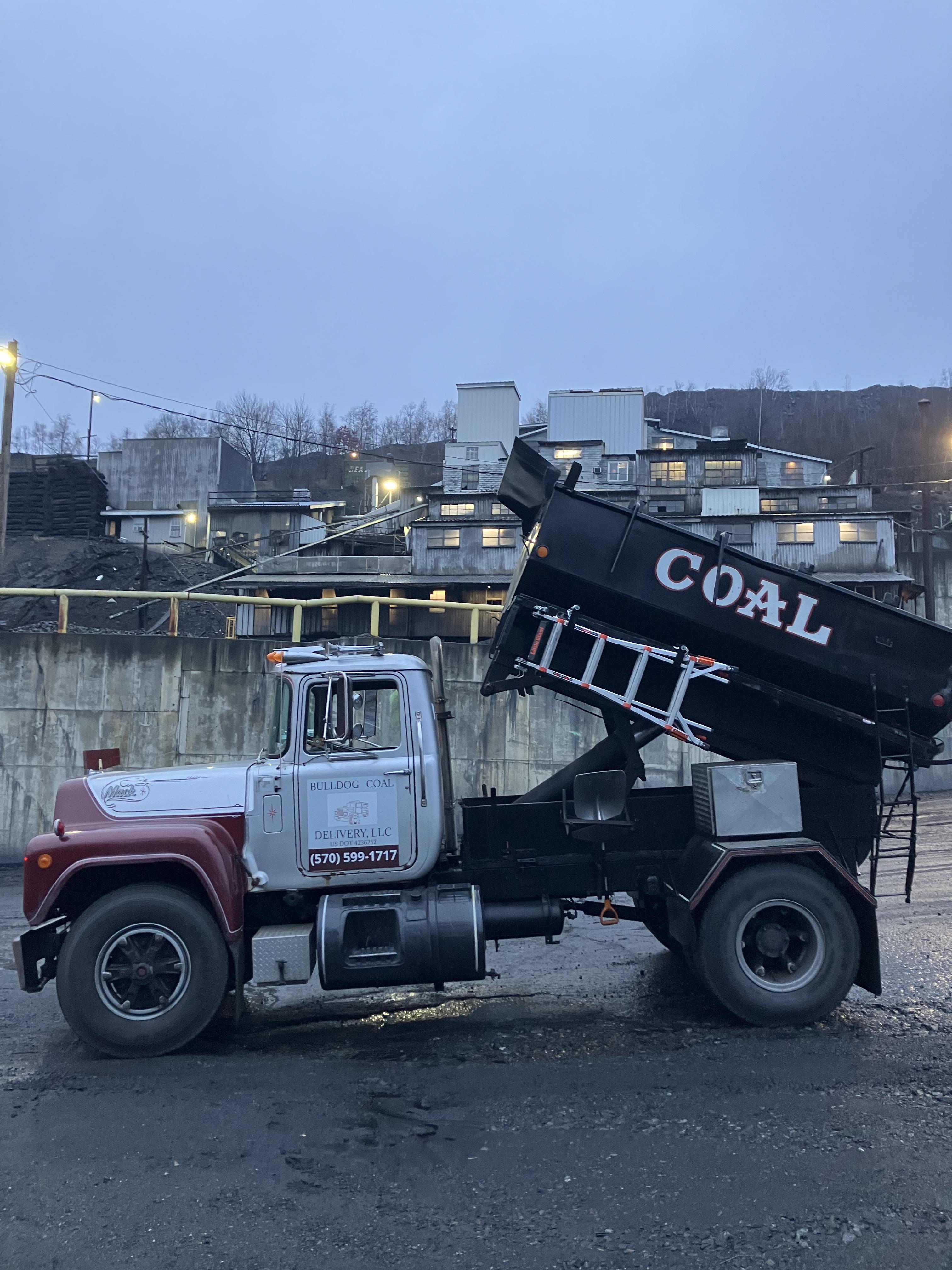

  11. My profile R 487p. Is my coal delivery truck. It does have a scania engine with an automatic trans.
