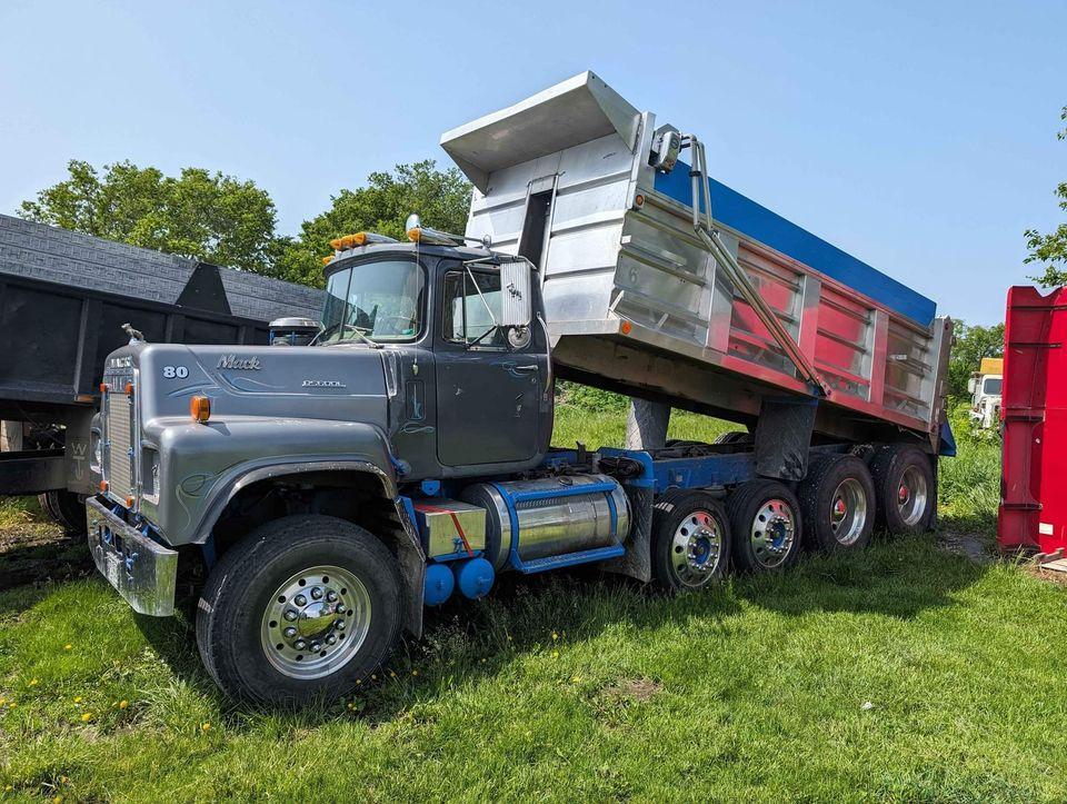

  2. Your are correct, about those loosing signal, I read a few reviews on them. I ordered one for now to get me by. As far as I can tell this transmission where the speedo goes has a plug for im guessing electronic speedo. I am not a transmission guy but learning. Im local at the moment with my dump so im hoping to come up with one for this transmission in the near future.
  3. Thank you! I have never seen one of these, man if i had invented this I wouldn't be dump trucking LOL
  4. Did a trans swap to an 8LL and all finished now. went in a a 78 RS600, I am needing the speedometer and wire/cable for this transmission. If anyone can point me in the right direction It would be greatly appreciated. Trans is an RTO16908LL Thank you
  5. Thank you for the replies! I would have kept my twin stick if they still made parts to fix it, it just isn't efficient trying to work and your aux box wont release out of reverse even tho it clicked out lol For anyone else doing the same swap as me in the same truck here is what I did for the cheapest and right route. I did end up drilling the frame mounts, had to stretch the drive shaft 2in. front u joint had to be changed to a spicer 5-676x which is two for straps two for bolt caps so I didn't have to change the rear yoke or my driveshaft, thank the lord! Clutch bracket was all the same as its cable driven, Only had to take a couple inches to the right and back on floor for the stick to clear in all gears, All that is left is to reroute the dump lever as its hitting the speedo plug, and she's ready roll. I would like to find a speedometer out of 2000 or so truck so it would work, or what would really be nice if someone made a gps speedo to install in the same place as the original.... wishful thinking In closing, like I have read on here, everyone said try and get a trans out of a Mack, its the best advice you'll get when taking on a project like this. I priced out both options, mack trans vs non mack trans and it was almost double to put a non mack trans in. So far I'm into this swap under 5k, which being on a tight budget I did most the work myself. I am glad I didn't listen to a friend and just go buy a fuller, everything would have had to been fabricated. Again thanks for all the help everyone on this forum had provided.
  6. I have almost finished my 8LL swap into my 78 R600L dump truck. The only issue are the transmission mounts. I have a set on it, of course only one hole is good, the other is a half hole. Does anyone have a source on a set of mounts that would line up, or am I just going to need to drill the holes out. The 8LL is a 2000 RTO came out of a Mack garbage truck from what I was told. mine is the ol twin stick 5x5. Thanks in advance for the reply's!
  7. 1978 R600 dump truck. looking for the rear shock mount brackets. thank you Gregg
  8. So my compound box is shot, 78 mack R 300 twin stick, reverse keeps hanging up even tho the stick feels like it pops out gear, causing lots of problems working. Spoke with shop that used to rebuild the duplex and do these swaps all the time, says the parts for the compound box were obsolete about 10 years ago. A member has reached out on here and has a 13spd mack and a 8LL mack transmission to do my swap. At 2000 rpms I'm at 68mph. I am leaning toward the 8LL just didn't want to loose any mph with it, I'm in Missouri so lots of hills, hollars etc. just looking for some experienced advice. Thanks!
