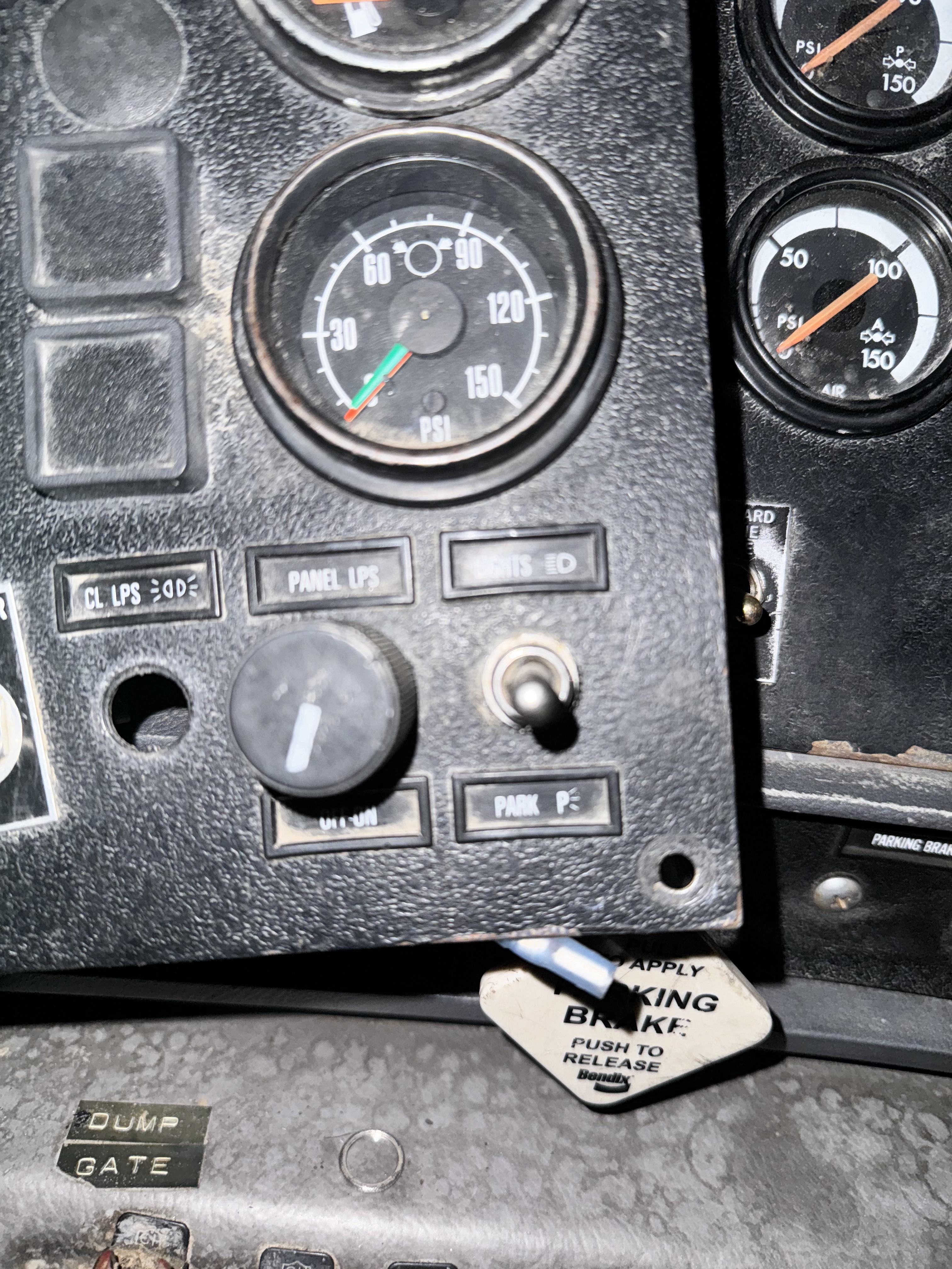

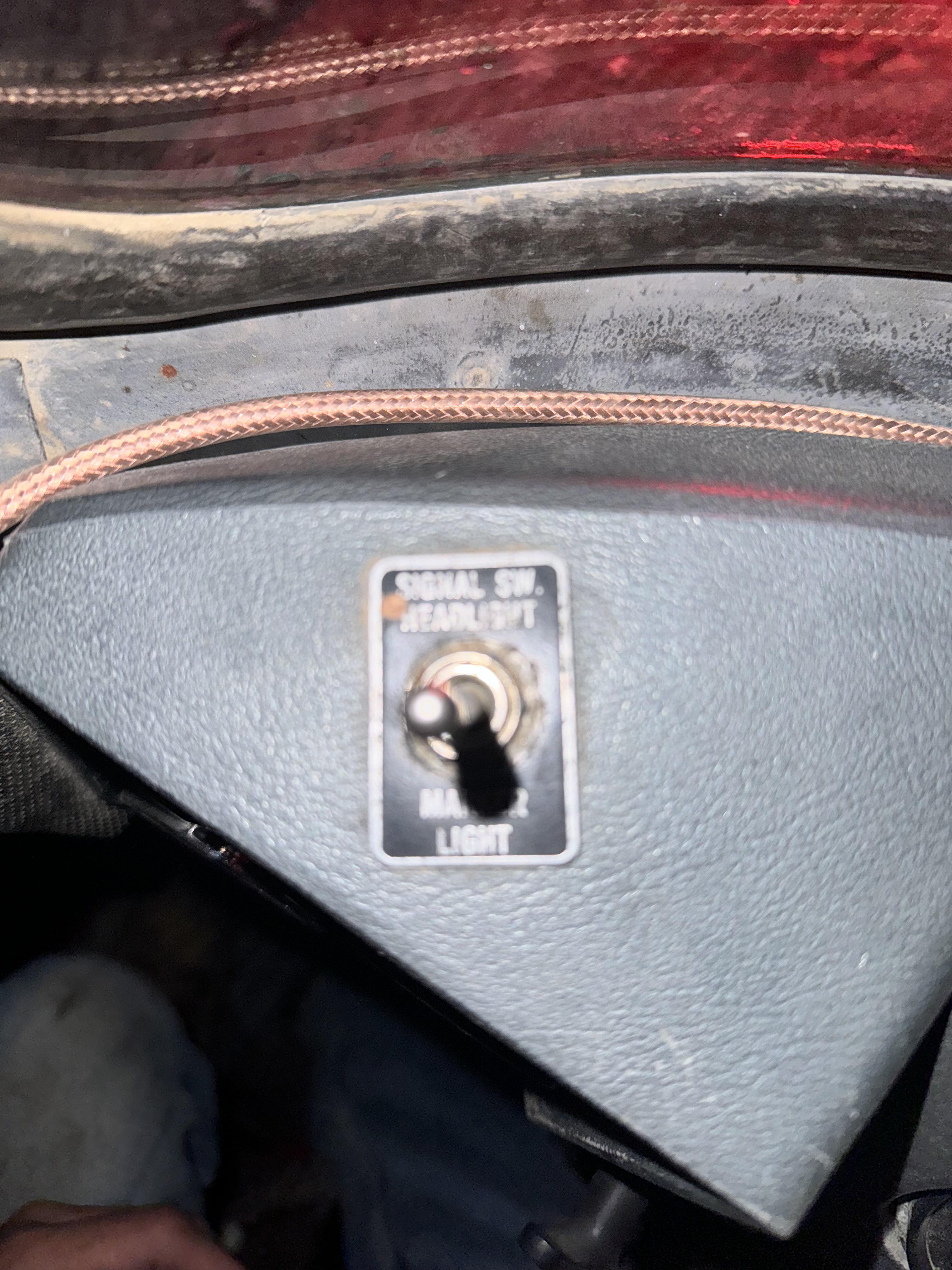

  8. Ok more info the headlight/parking light switch first pic seems to turn the headlights on in either position the second switch on top of the dash seems to do nothing

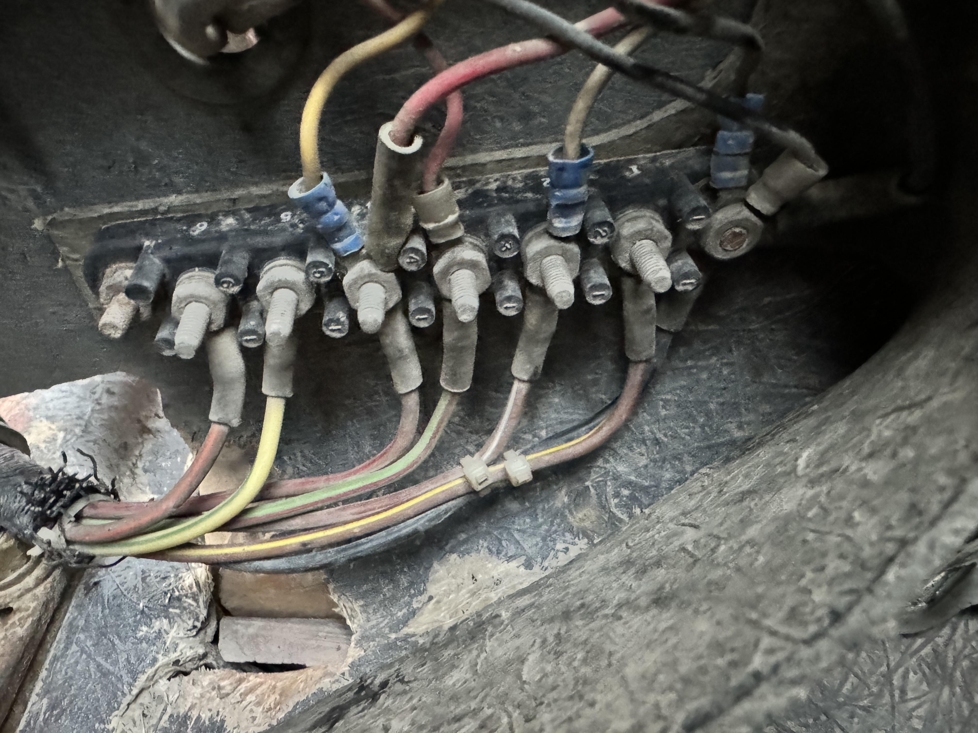

  13. So there is a harness that has brown and yellow (same on the dimmer) it shares another harness in the same loom that is a bunch of greens I think it piggy backs to the other headlight. If I disconnect I either lights got out. The green connects to bus next to steering shaft that is 10-14
  14. And one of this harness does connect to the bus on the firewall
  15. Looks like a harness comes out of fire wall splits into two harness and leads to a bus next to each headlight
