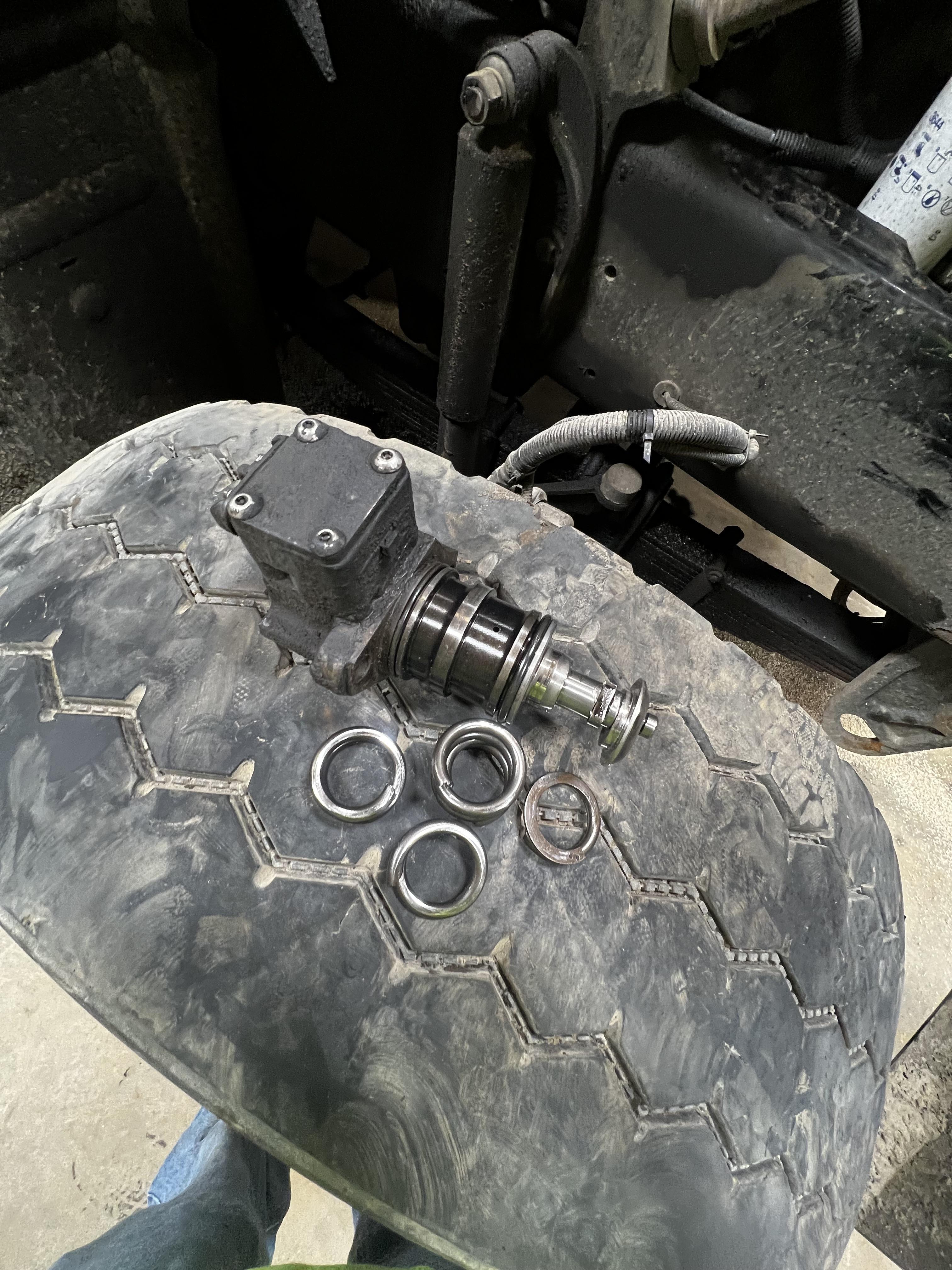

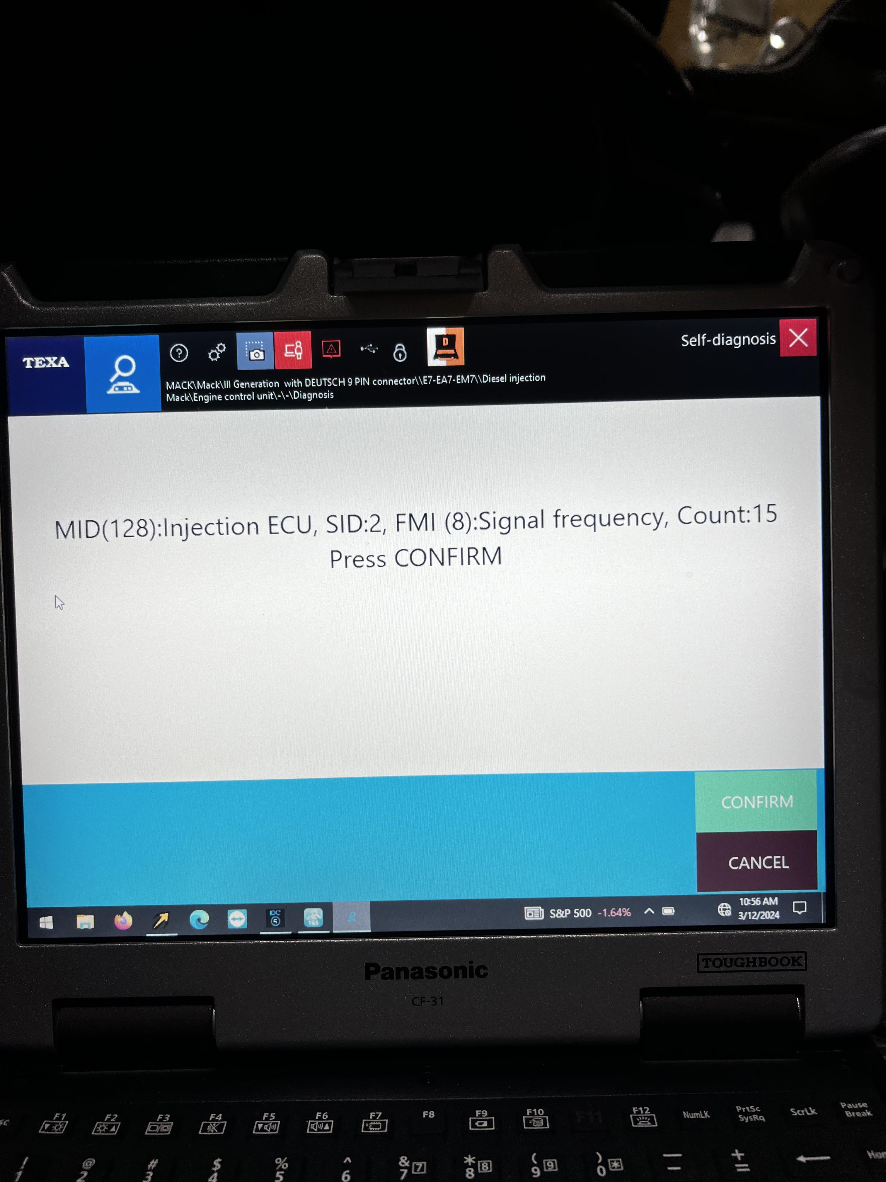

  10. Bad eup soleniod cyl 1 was the problem.
  11. ok thanks ill look into it
  12. ok would that mean cyl 2? and is that the second one back from front of motor. and any resistance specs i should be aware of?
  13. forgot about that part lol. mack granite 05 with a 400 in it
  14. Any input on this code would be greatly appreciated
