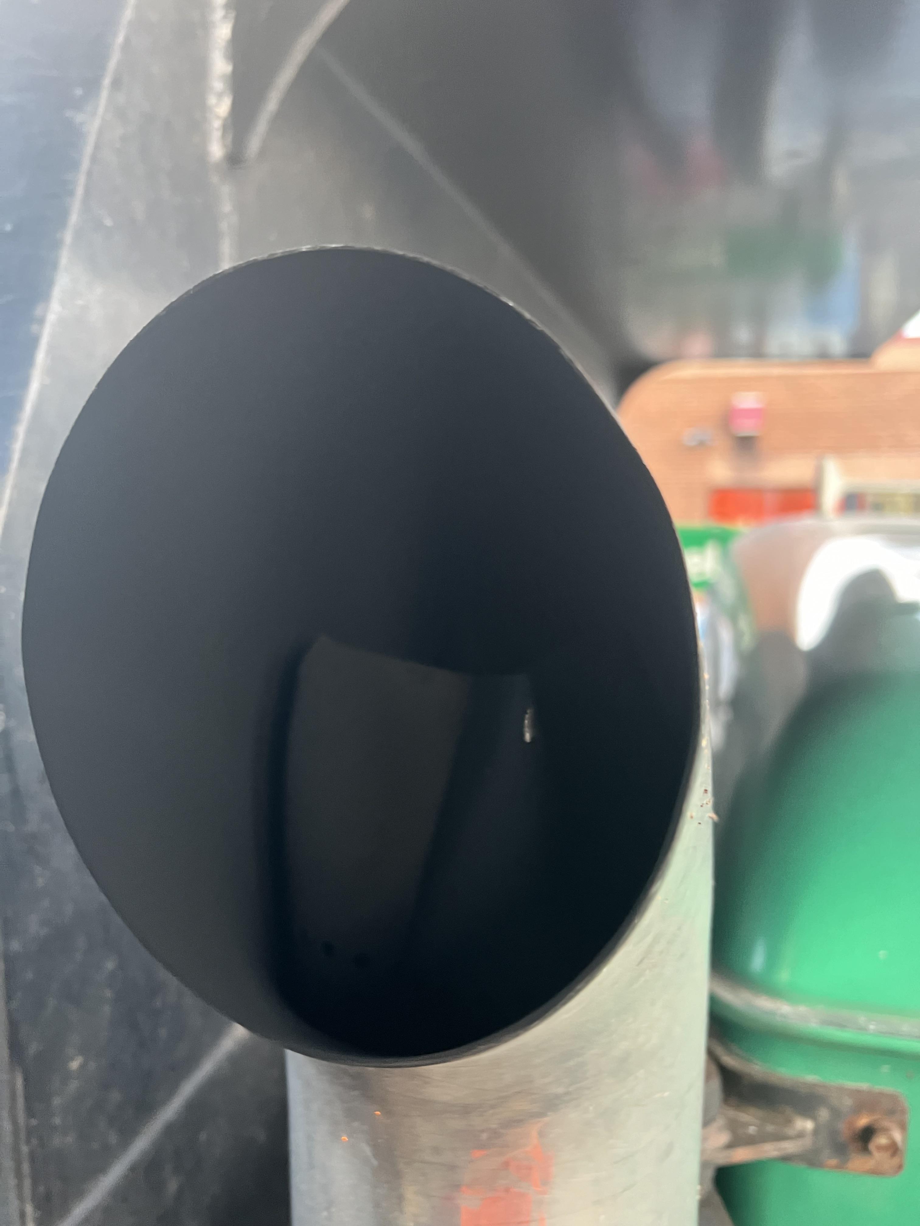

  9. Yeah I hate when people ask questions but they never post what fixed the problem. The muffler I put on it I don’t like it has a flat plate in the middle of it that the exhaust has to go around. I need to find something different.
  10. I need one like that with a 44” body 4” inlet 5” outlet. The one I put on here last night has a flat plate in the middle of it. You can tell it can’t breathe very good.

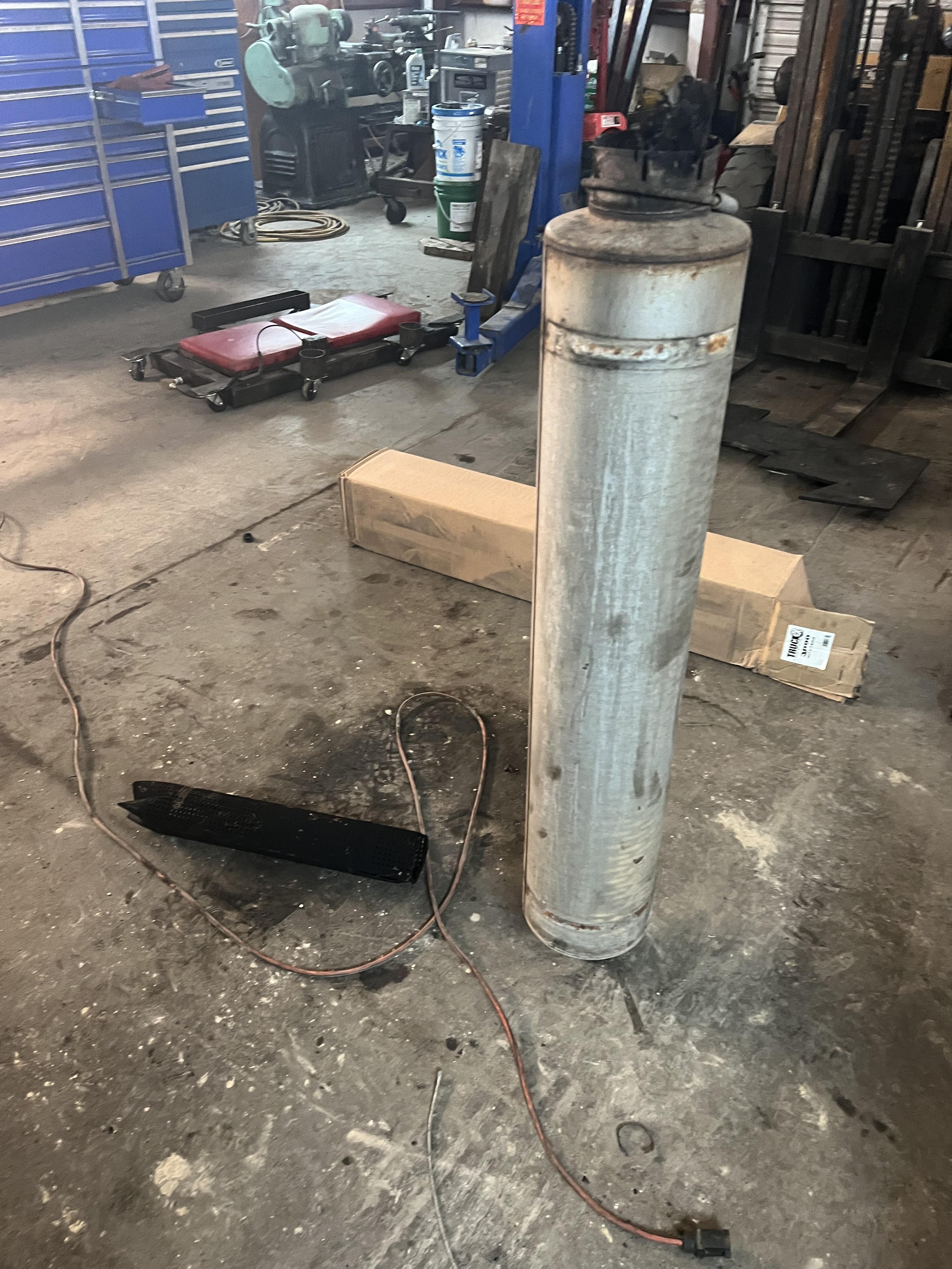

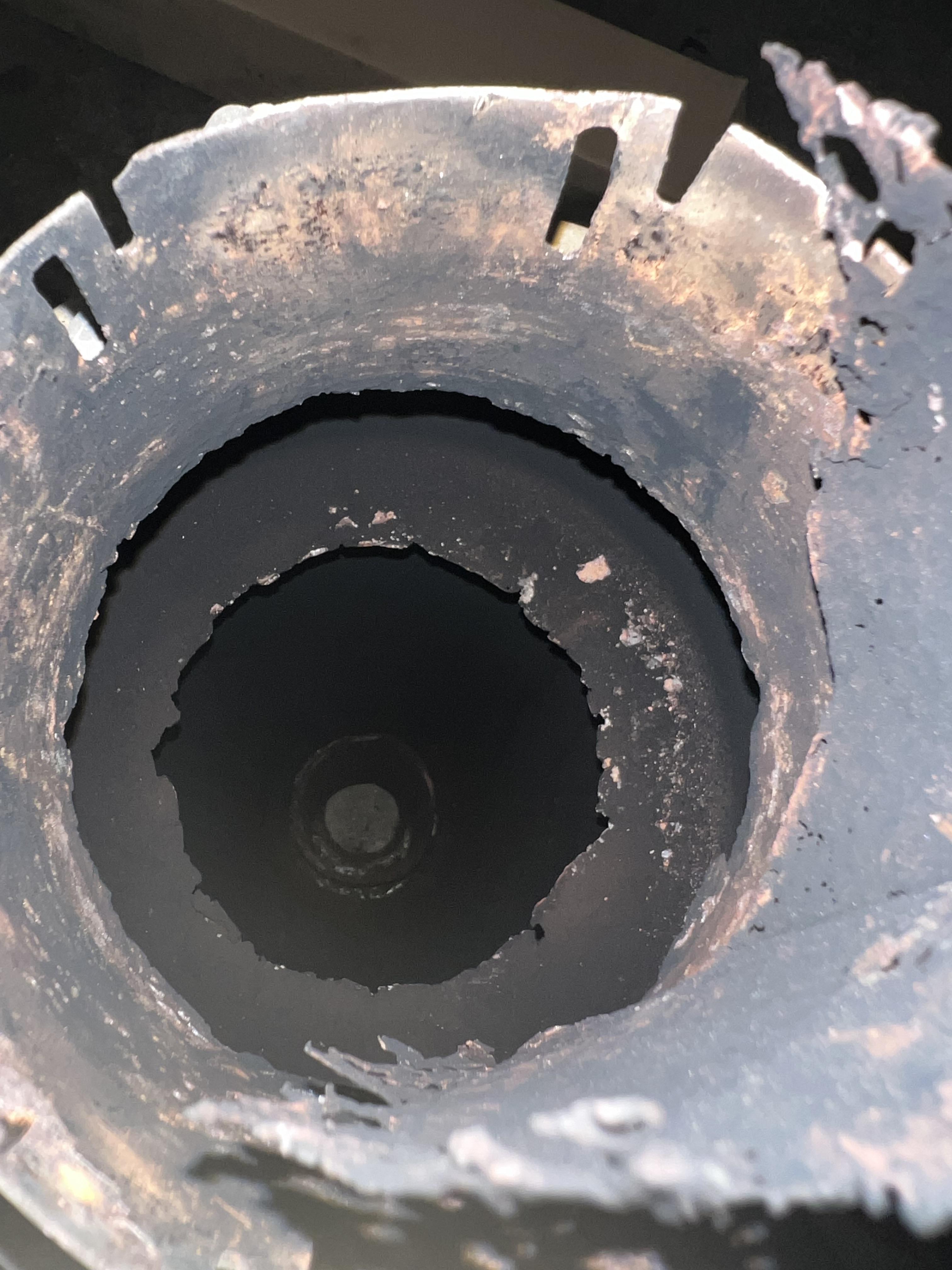

  11. No it didn’t I have hunted this problem but I finally found what it was today. The muffler had blown apart and the baffle had shot perfectly straight up was stuck In the exhaust tip. So the whistle noise that i thought was a turbo leak is were the exhaust was passing thru the little holes on the baffle. Not sure what was causing the poof noise but it sure sounded 100%!better after putting a new muffler on it. We will see how it does Tomorrow.

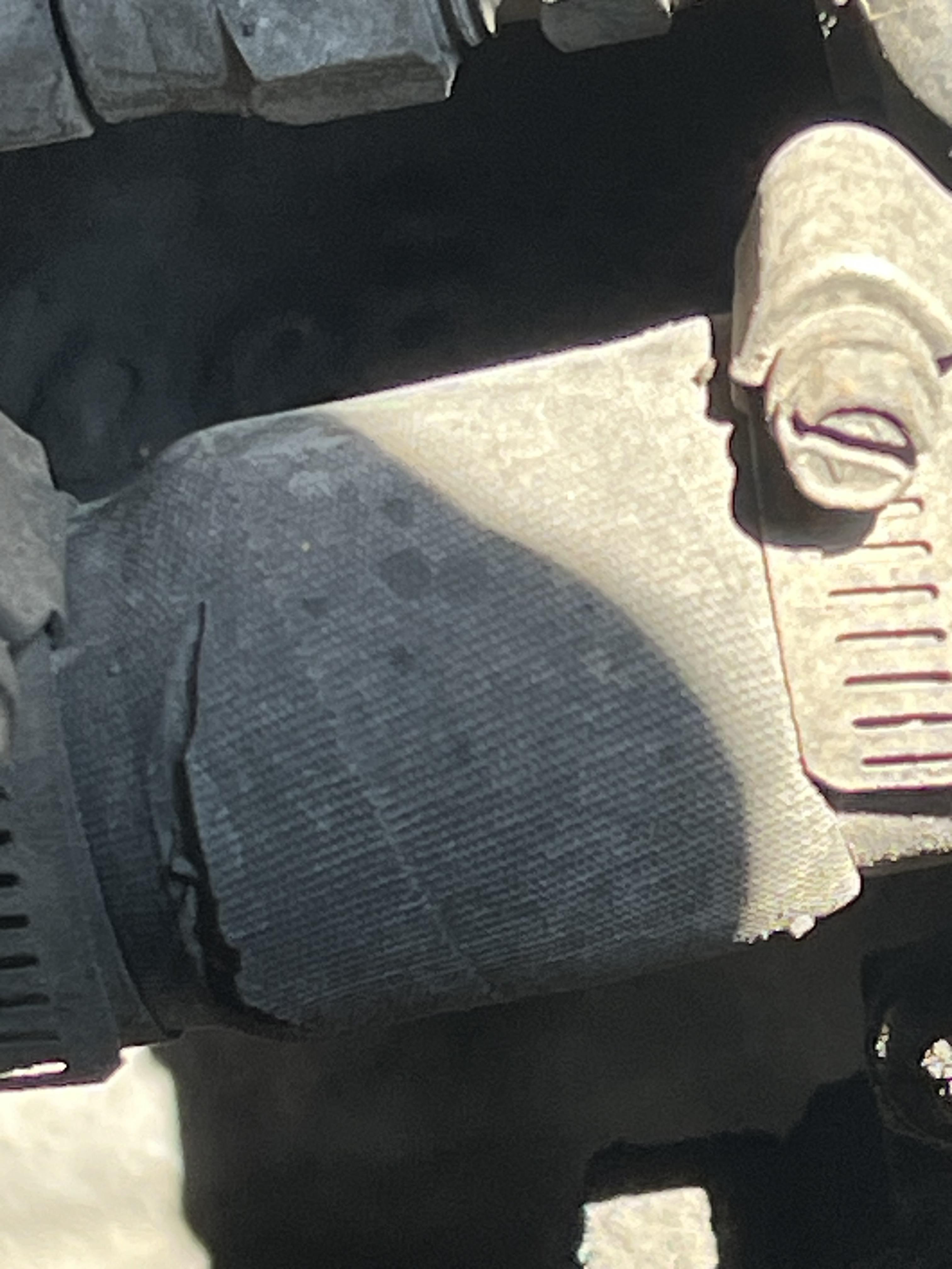

  12. I think I found it this the hose coming off the back of the compressor going to the intake. Only bad part is I am sitting in a parking lot loaded with asphalt. So I hope it holds up till I get in
