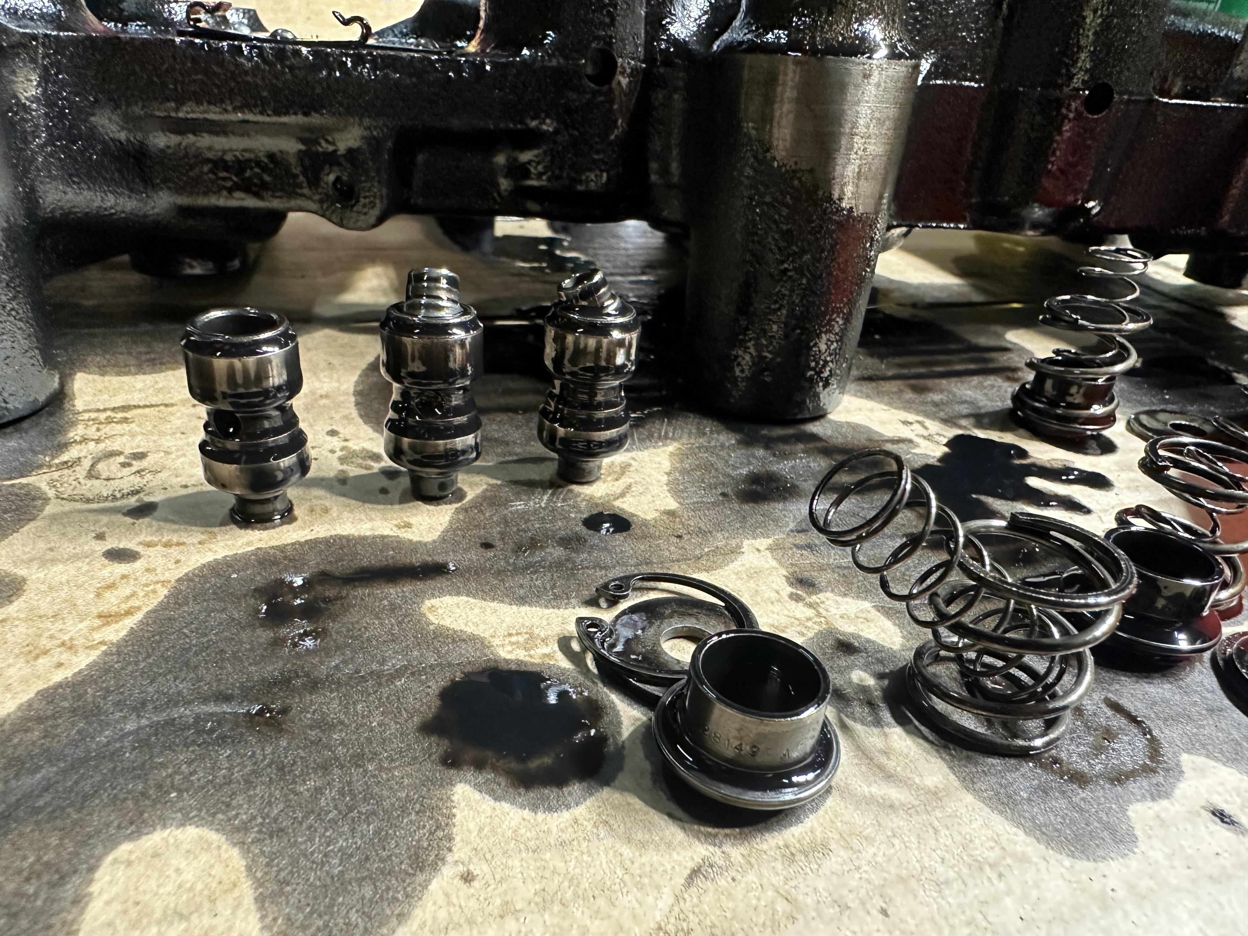

  4. Think I found my smoking gun. control valves are all totaled.
  5. Thank you fjh and Joey Mack. Mine does not have the upper feed, yet… but I do buy my parts from Portland now. This is the kit I got, I’m not seeing the pn you referenced, but it may now be a dirty Volvo number now. So far during disassembly I haven’t found a smoking gun, but some orings look pretty trashed. Only other thought I had was making sure the holes in the accumulator bore are not supposed to be plugged? Also I haven’t backed the slaves off in the picture, looks like an awful lot of adjustment left. Like they might have been way off? id settle for a weak jake, I’ve never had them function whatsoever in 4 years. Really appreciate the feedback!

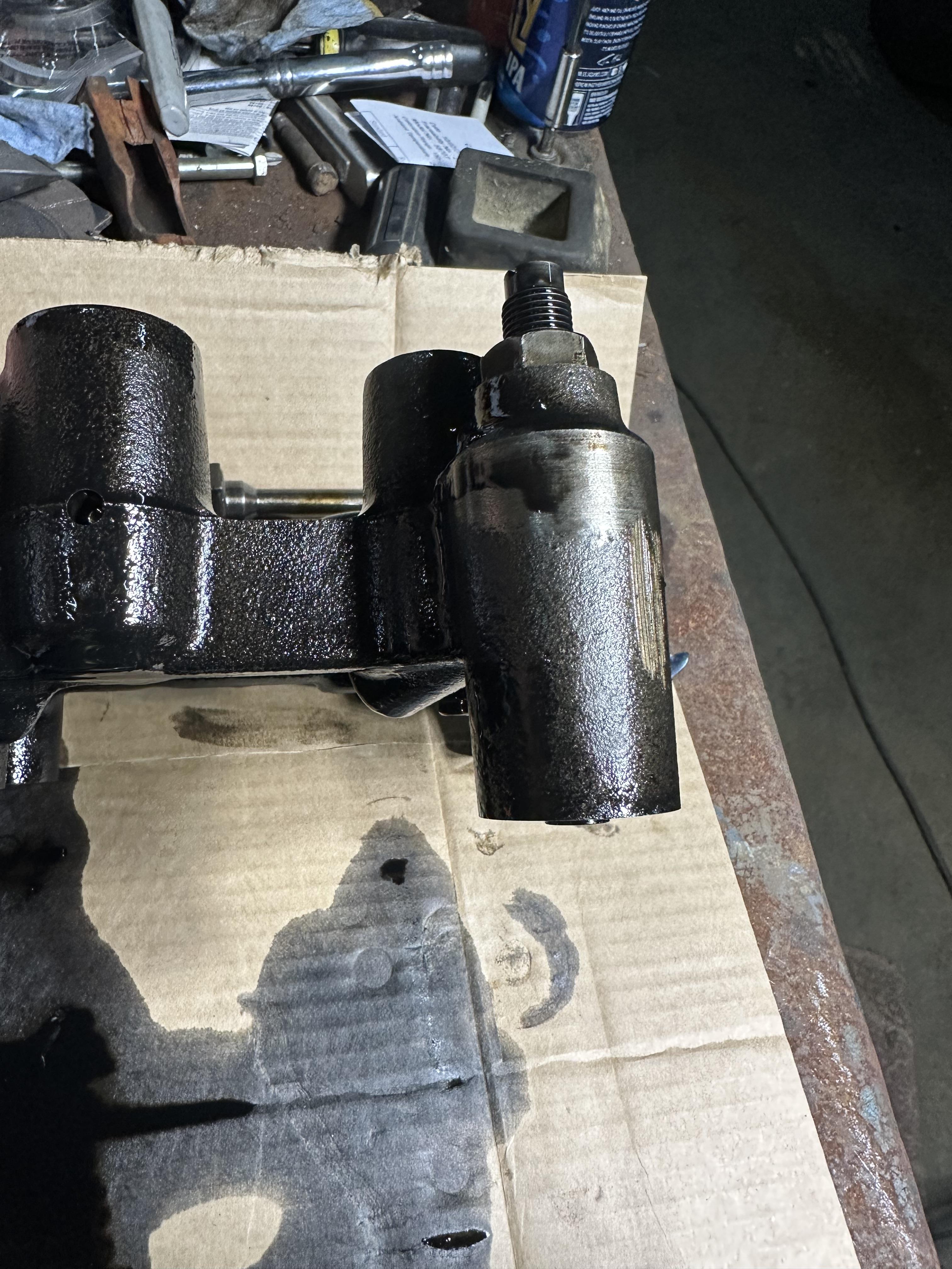

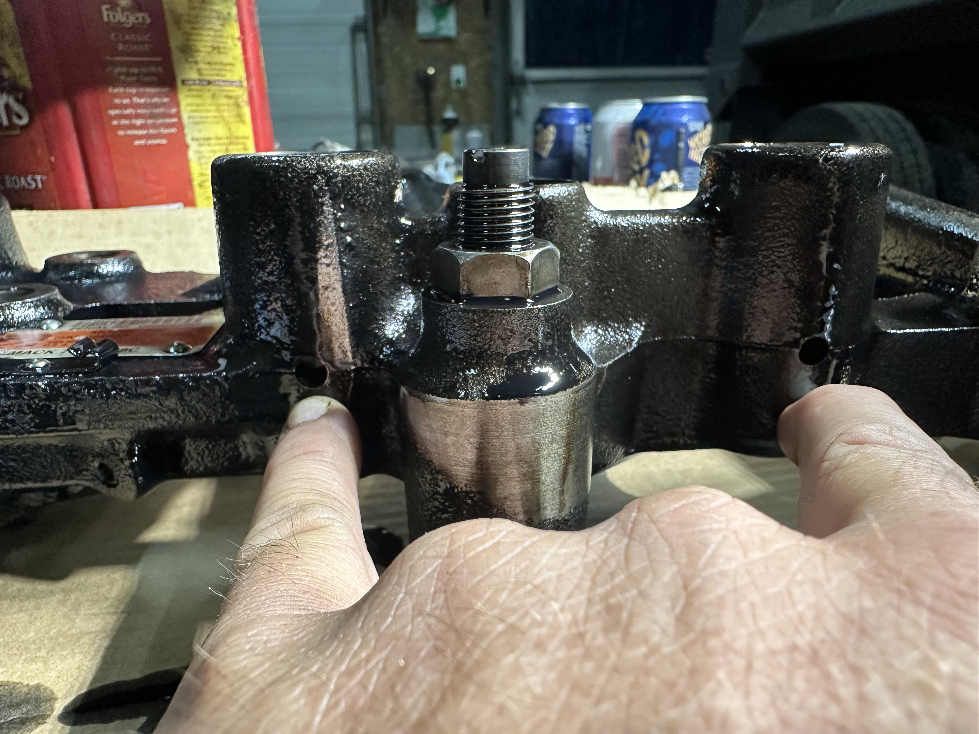

  6. Reviving my old thread for model 690 jake. I purchased the Jacob’s kit from Mack for almost $1400 with 2 new solenoids. Was told I got the “last kit in the USA” and they are out of production. My question is, am I missing something between the rocker assembly and the jake head for oil delivery? The 2 pictures are when I removed the Jake head, and nothing else. Doesn’t look like there is any o-ring or anything to seal it. There is also an open hole on the bottom of the jake head that looks like it’s missing something. (Shown in the first image to the far right) Any help is appreciated!
