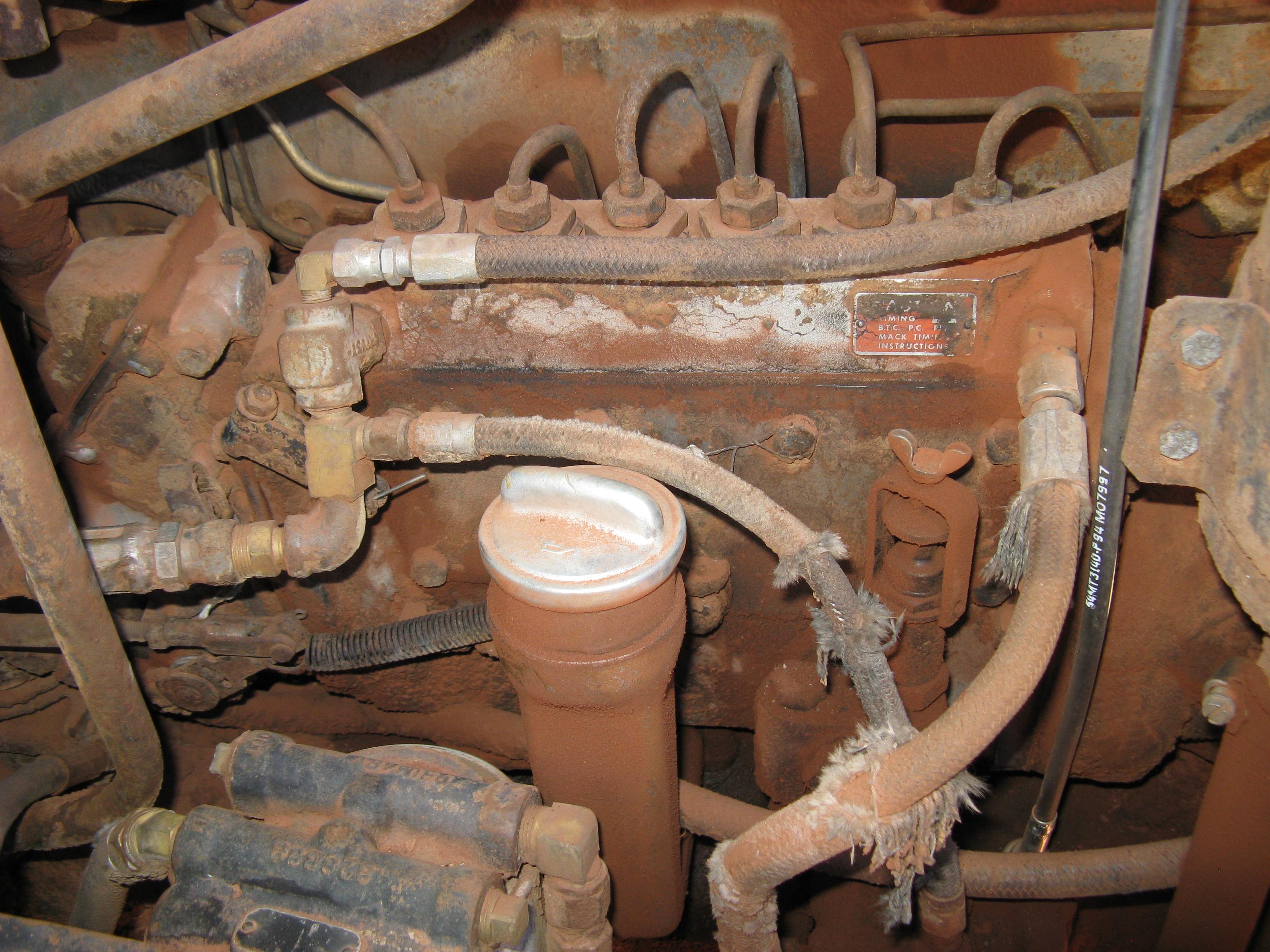

  2. My truck started loosing prime before I got to changing the filters. It had mysteriously died on me a couple of times, only to start again with 30-60 seconds of cranking. Finally gave it up after sitting for an hour shut down after a days use. Luckily I remembered this thread and cleaned up the hand primer, pumped it for a minute until there was noticeable resistance and the truck started right up. The hand primer leaked a bunch on the first few pumps but then sealed. Parts book doesn't show the lift pump / primer as having any internal parts available. Looks like PAI makes replacements for both the pump and primer. Anyone have experience with them? The parts book also shows no gasket between the lift pump and the injection pump housing. That can't possibly be right. Or do they expect you to slobber it with some sort of sealant?

  7. Have put off changing the fuel filters for way to long on my DM685 (1971) due to worries about getting it primed. It was well used and abused when I got it for cheap, but the fuel lines all look original and correctly plumbed. Suction through the coarse filter, into the lift pump / primer then out to the fine filter and into the injection pump. My question is, when I remove the filters, will the main injection pump wind up with air in it? Especially after removing the fine filter. I plan on filling the new filters before installation. Will I be looking at having to loosen the injection line couplings at the injectors to purge air from the lines or is the primer on the lift pump used to purge air through the top of the main injection pump housing? Also, are the old factory fuel fittings all 45 degree flares on these old trucks, or some long abandoned standard?
