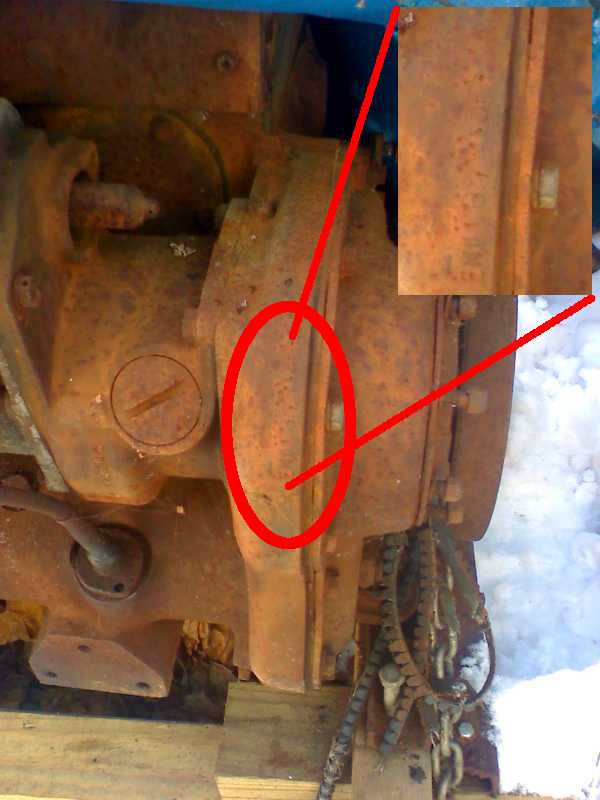

Wheres the engine number on this engine?
have looked everywhere, am getting ready to pull it out soon, it was driven on road for last time yesterday after been sitting for 6mths, had to back of all the brakes and shift it around the block ready to stip it bare.
Grant
Grant I assume it has a Maxidyne 237 or 300 tip turbine? On my 673 the numbers are stamped on the front gear housing on top of where the injection pump mates to it. If its a V8 then someone else here would know. I hope this helps.
Numbers are almost invisible but you can make out the EN part.
-Thad
What America needs is less bull and more Bulldog!

H i Grant, not sure what engine your refering to, but if it is a 6 like the pic Thad posted they are often up higher, along the top, the flat bit at the top. If it came from an 'F' it could be on the back of the block just below the head. If it was a V8 it could be on the pan rail, just above the sump pan or across the top at the back of the block below the valley. Tell us what you find. Regards Jeff. The pan rail drivers side (OZ) about the middle.
Spot on mate, END/T 864,5 and 6 are all on the pan rail on the RHS. I dont think it would be an E9 in a flinny

Hello, thankyou guys, will look again tomorrow, its a 6cyl, was told its a 260hp 6 with 700lbs torque, the previous owner had said it wasnt a 237, but once i find that engine number it will answer it.
i checked pan rail, not there, have checked back of head area, will check timing area tomorrow.
regards Grant
regards Grant
found some numbers up near fuel pump, 5P9973
does this mean anything? vin # is R611 RS 6053
Grant
An R611 would have originally been equipped with an ENDT673C Thermodyne @ 250H.P.
The outward appearance of the ENDT673C is identical to the ENDT675 237 H.P. Maxidyne, except that the ENDT673C would have been a light greenish blue color, and the ENDT675 would have been Gold.
(edit to add: Also look at the top of the valve covers, back then they were marked "Thermodyne" or "Maxidyne" on that flat area on top. That could tell you what it is, unless someone put different valve covers on it at some point)

Grant, that # is the eng # only, it does not say what eng it is. B4 the # it should have eng type, i.e. ENDT 673C or ENDT675 etc. But that chassis # is for an ENDT673C, 250 HP, Quad, On/Off Hwy rear end. Jeff.

it has thermodyne on valve cover also, so there we have it by the looks, a 250hp endt673c thermodyne.
