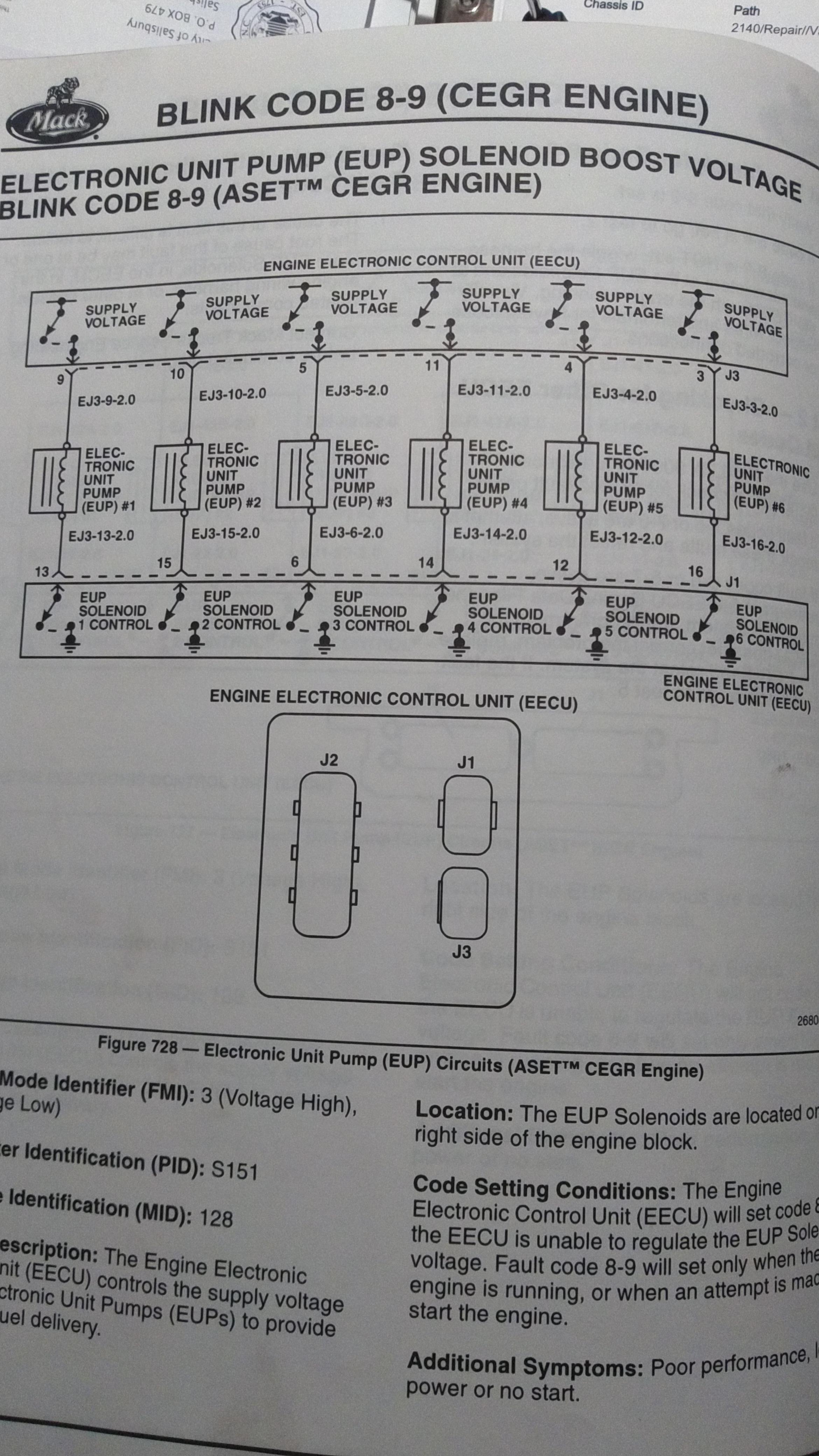

Ok, thanks. Took the eup harness all the way off anch checked everything. All looks good and ohmed good. Reinstalled and now i have codes for low voltage at every EUP and it will barely start and run horribly. Not sure where I went wrong. I am guessing i somehow spread the connectors kn the harness side. Going to have to figure it out.
are you saying you probed the eecu ends with something larger than a small paper clip?  Most folks dont have back up probe kits, so the smallest paper clip in the office will work.. Do you have the pin I.D. for the eecu connectors? it is printed on the wire also. It will tell you where to go, from one end to the other..

What’s crazy is you couldn’t actually see an issue at all. The wiring looked very good, it’s where it was twisted to go to the EPU. It was dark in the shop and under the heat shield and i literally saw sparks and that was a good thing.
Agree being kept in the dark is good some times! 😂 Thanks for posting your fix! Definitely something to try if your search for clues! Turn the lights out!
I have a question,,, '2wdiesel2021'....  Did you happen to record the wire number off of the insulation, on the bad wire?..  It should say something like EJ-3 -41,,, something like that... If it isnt too much trouble to look at the bad wire, by peeling back the loom to read it... if you can't,,, that's ok...  I was curious if it was the power wire for EUP 1,2+3,,,  or the EECU signal wire, for #2..   Glad you got it fixed, and really glad you didn't load a parts cannon and shoot a couple grand worth of parts, due to a bad wire..  That happens a lot..  Good on you!!  Jojo
Joey a guy would think if he pu on a spark or arcing it would be a power wire !
