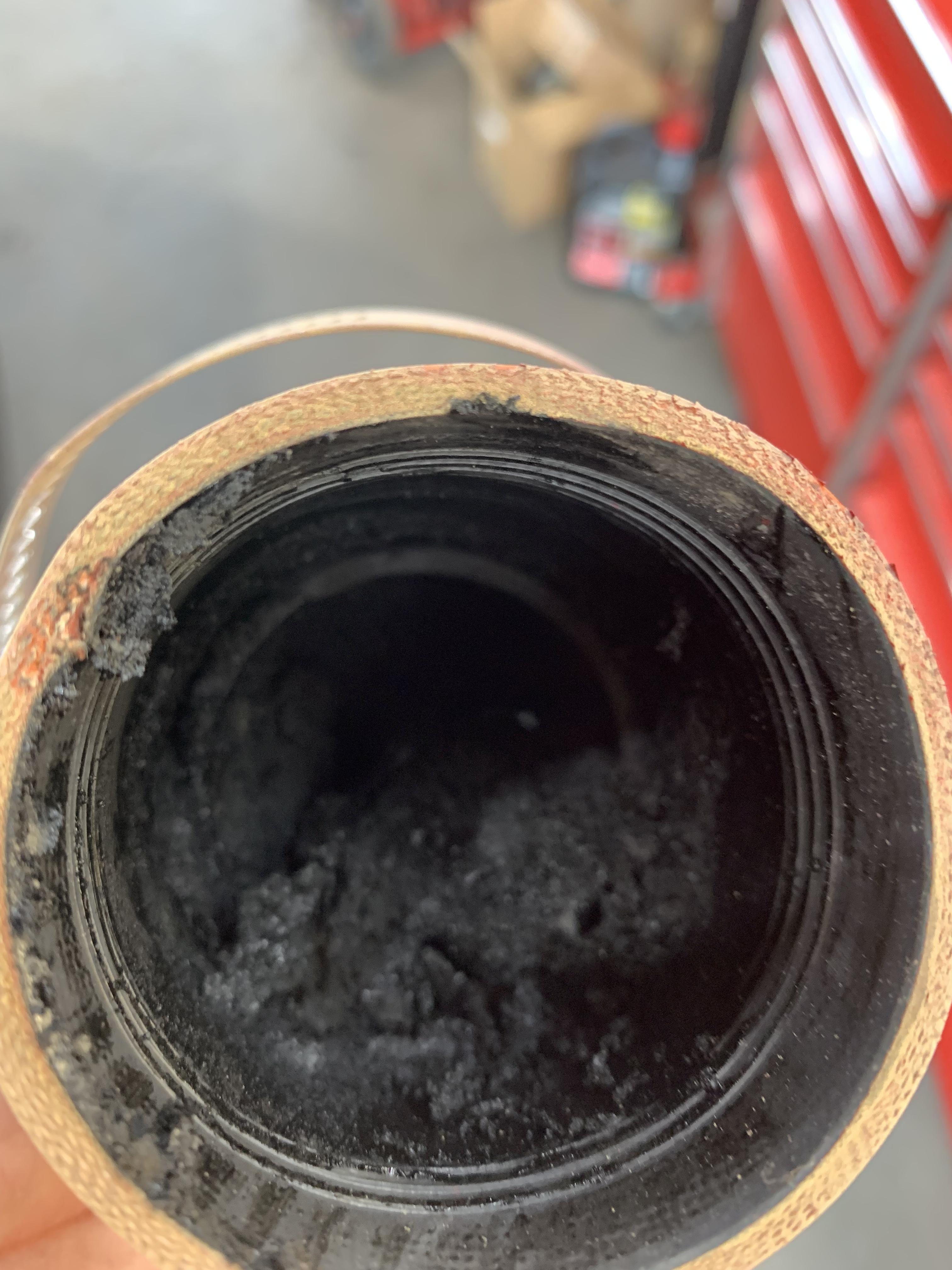

If the ports are getting clogged on the Venturi pipe where the EGR differential pressure sits it tell the engine ECM that the EGR flow is below the target flow rate. Even though the actual flow rate probably within specs , the engine ECM will command the EGR valve to open more to meet the target flow rate . So now you got more than needed EGR flow( dirty exhaust) going back through the engine. This produces more than usual soot to clog the DPF filter. I have had this happen on the MP8 even with the newest EGR diff sensor/Venturi pipe set up. Below is a picture of the newest sensor/ pipe for the MP8. I usually pull them off and clean them on the inside.
