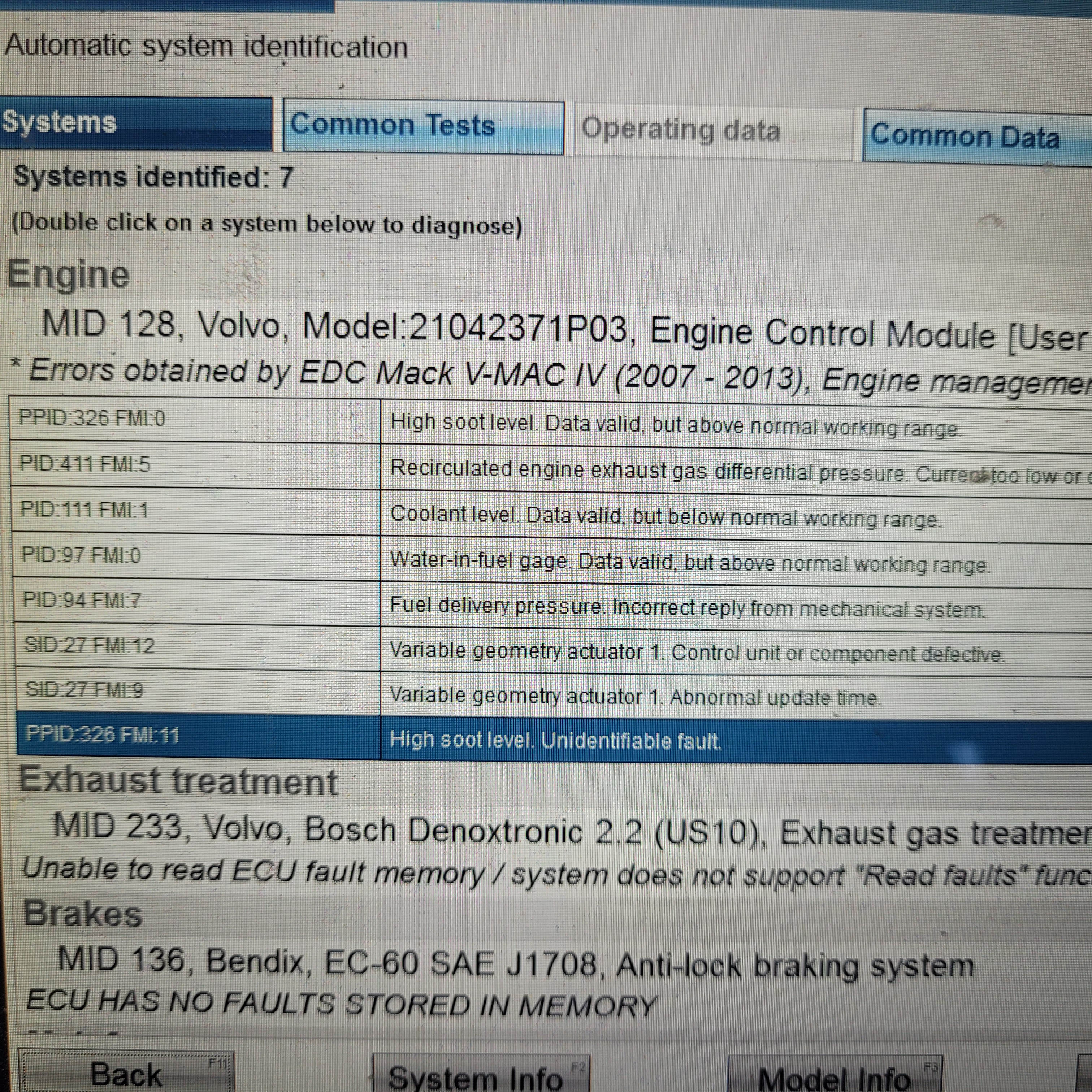

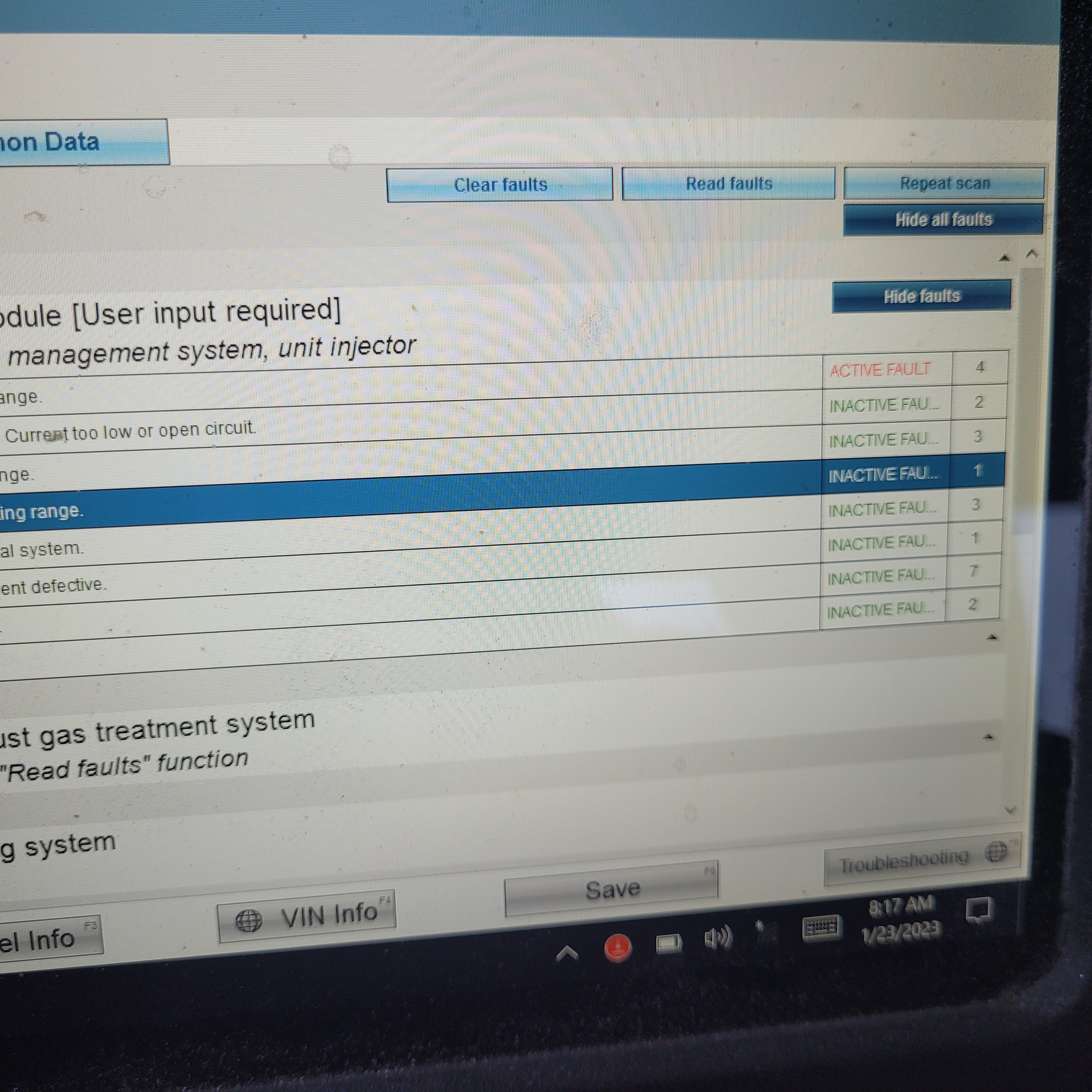

Egr fault mass flow to high
I'm hitting temps in 10 minutes, dpf dp is .490 max. I inspected the dpf and doc, blew them down and and replaced all the clamps and gaskets 2 weeks ago. Mine went the other way, egr valve first. Came back with same code, replaced the egr venturi with the plastic 1 piece and a new sensor, and the temp sensor because the wiring had chuffed bare.

That TSB on the connector pins sounds like a possibility

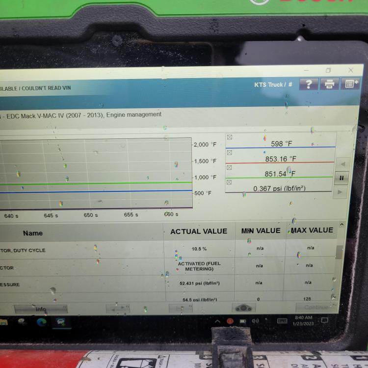

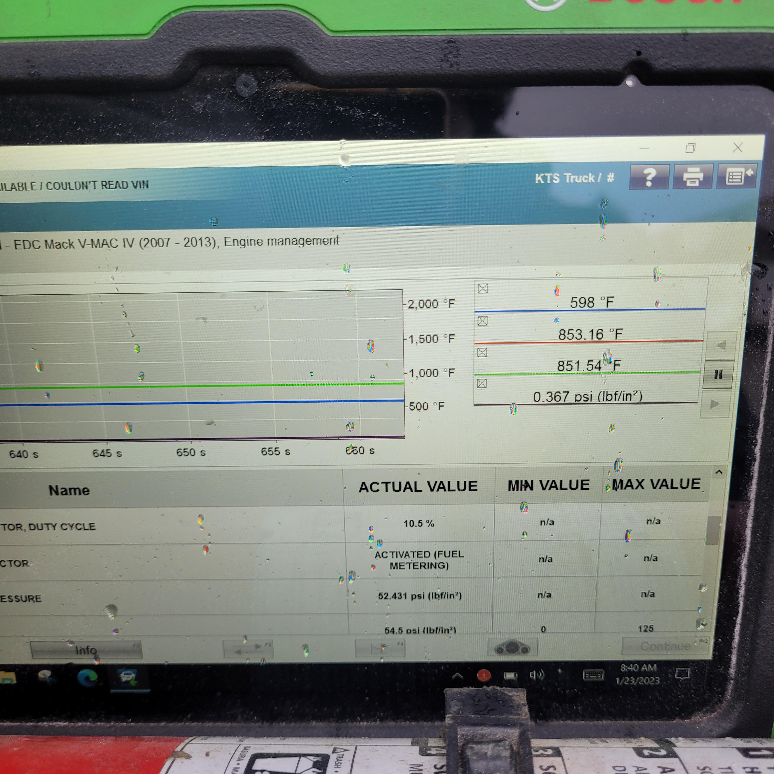

Yeah, showed up yesterday. Temps went over 900 for 10 minutes, then stopped. Soot dropped to 104 from 144. No Codes showed up. It was raining yesterday, all codes popped yesterday except the egr code and that was from when I had it last. Everything is cleared now, running another regen.
Edited by mdixon
In my notes for your model . The fuel doseing rate should be between 5% to 19% to be normal. Your is at 12% which is perfect. 22-29% usually mean clogged 7th injector. This is only for your year model. Other years are much higher. With the key on/engine off , what is your EGR differential pressure? And also what is the DPF differential pressure reading key on/engine off?
