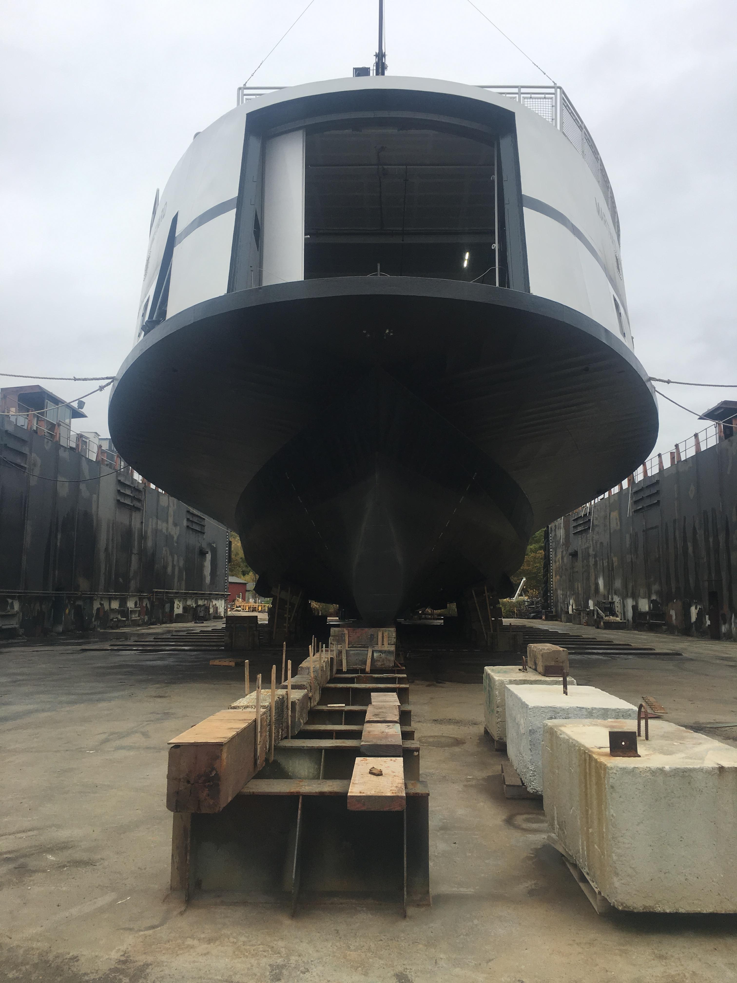

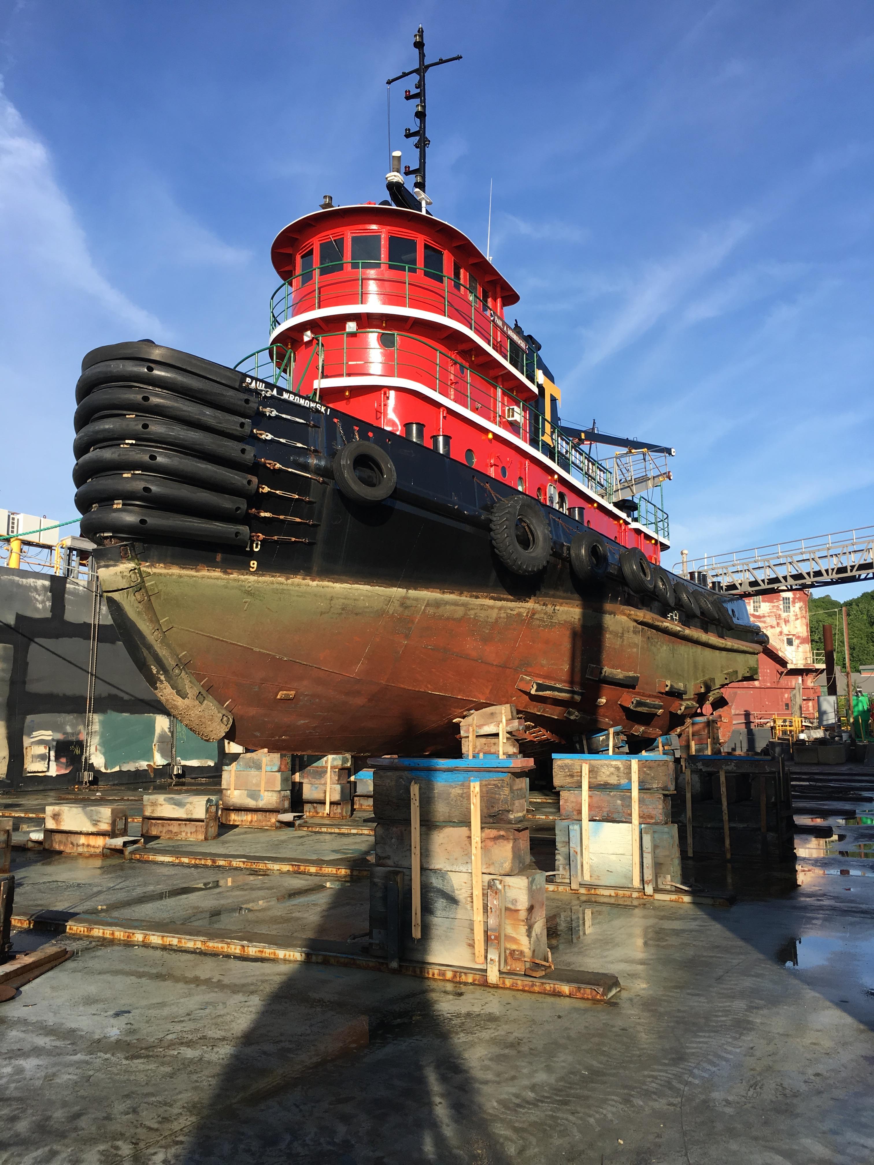

We have a full shop, and it wouldn't be the first time I've made tools for a job. I was OSM for a commercial shipyard before covid, making tools and doing the impossible was just another day at work.

Mostly propulsion  and steering in my department, but I was a pipe fighter, welder, steel worker, mechanic, rigger...
I did a ton of shaft and bearing work, pulling on chain falls and running jacking setups to pull 12" bearing, 20' shafts, 5000lb propellers, you name it and we did it.
