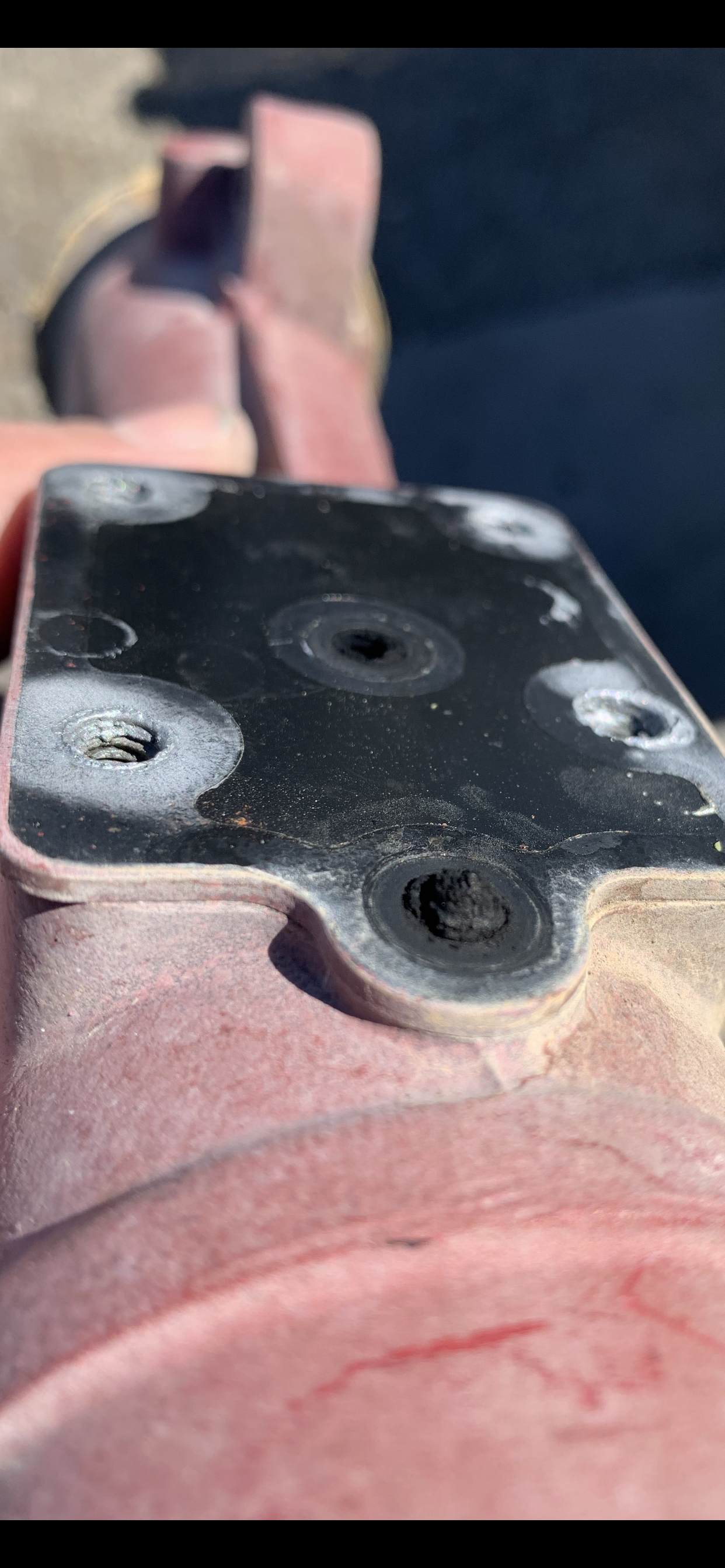

Ok guys so taking it to the shop tomorrow for check up and apparently cups and injectors will see what they say . Mean while a code popped up p0401 and before I parked it noticed what seemed diesel in my exhaust could all this be due to cups and injectors or this a separate issue guys . It was leaking out behind the turbo was dripping form the flex exhaust tube on the bolts on it had a drip of it . I want to say its diesel my smell is not all their got the cold and was stuffed, definitely not oil . Could it be that the 7 th injector is overspraying or what .
On the P0401 code, it’s for low EGR flow. On a MP8 or D13 the flow is measured by the EGR differential sensor which is mounted on the vertical Venturi pipe on the RH side of engine on the outlet side of the EGR cooler. There are 2 holes in the Venturi pipe that the sensor sits over and reads EGR flow and pressure. Naturally this is soot/exhaust that flows through the pipe/sensor. Over time the 2 holes soot up and clog and restrict flow and pressure to the sensor. The engine ECM sees low flow and commands the EGR valve to open farther to reach the target EGR flow and pressure. This happens slowly over time so for awhile your pumping excessive amounts of dirty exhaust back into the engine which causes DPF over sooting and frequent regen  requests. Finally the P0401 sets. There are several variations on the EGR differential sensor and Venturi pipe.  The newest style has large holes in the Venturi pipe to keep from clogging. You can remove the sensor and  clean out it the holes with compressed air/blow gun. The diesel smell smoke from under the cab is probably a leaking exhaust flex pipe and the engine doing or finishing a regen. Seen this many times while doing a parked regen.  I’ll attach pics on the EGR diff sensor later.
https://m.youtube.com/watch?v=AsPtct6bw3M
Here is a video that explains cleaning the ports. Your EGR diff sensor and Venturi may look different but all work the same way and port clogging still happens to the newest versions. The ports are not drilled straight through so compressed air or running something flexible through it is the only way to clean it out. Mack recommends the old pipe cleaners that the old tobacco pipe smoker used to use years ago.
On the early version Venturi pipe , the pedestal that the sensor bolts to can be removed from the Venturi pipe itself. Four small screws hold the pedestal ( that sometimes break) to the pipe. Removing the pedestal makes it easier to clean . Here’s a pic of the Venturi pipe with pedestal removed, you can see the bottom hole clogged solid . This caused low EGR flow codes and daily regen requests.
