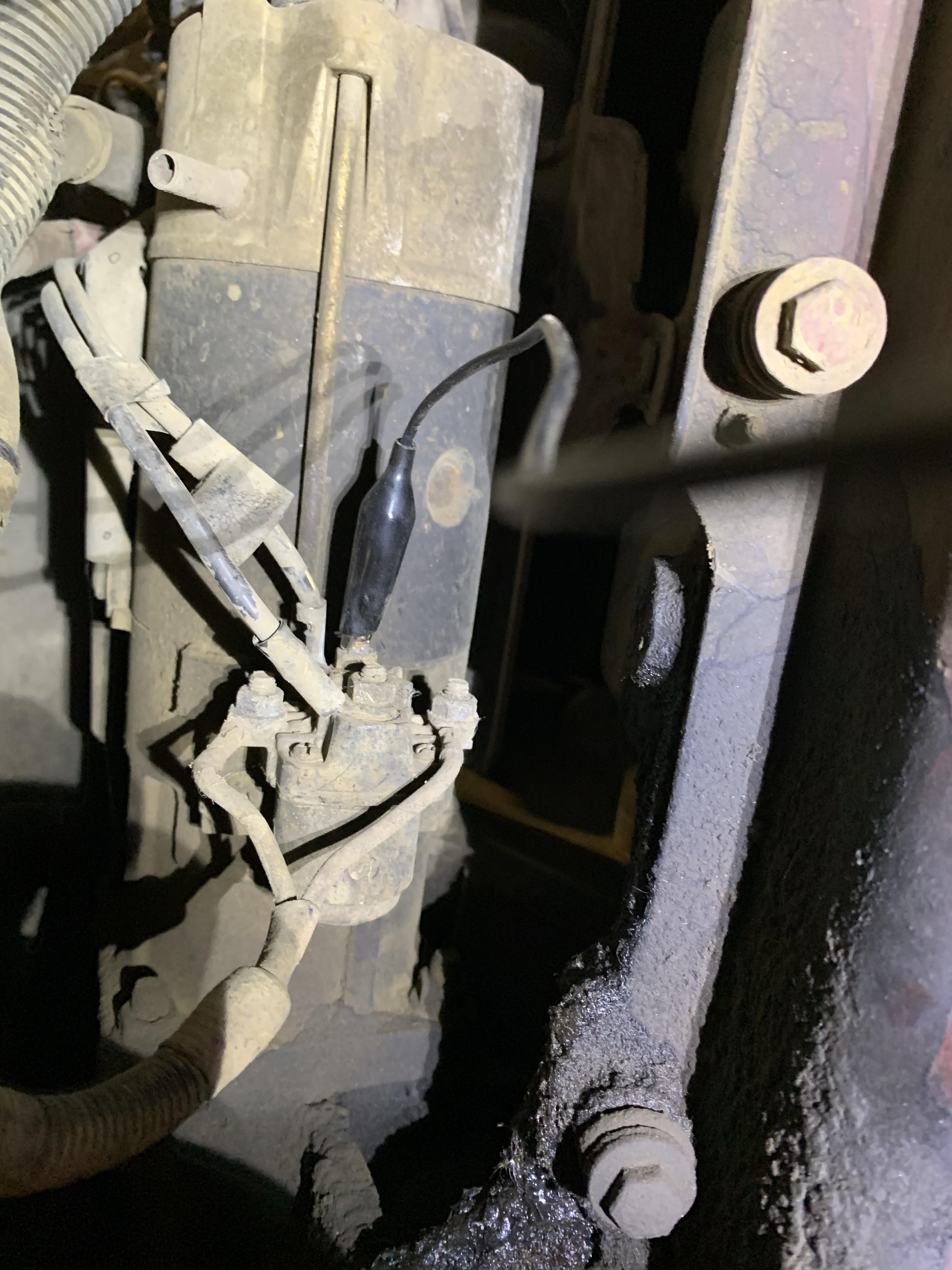

that is odd,  is it possible the celenoid is bad too?  i know you can buy a replacement for about $35.00.  i have replaced them quite a few times.. they dont seem to last as long as the older types, like on a 42 MT starter..  I also see the contacts are dirty. the larger black wire coming from the celenoid should be the signal wire for the starter. volvo uses gray wires as the grounds, black may be 'hot'..  i need to look at one in my  hand to refresh my memory.. i figure that when you power the key signal line, that there would be 12v at that black wire's post..
So the the celinoid one side should be ground and the other a hot when you want it to start.  It started before the trans swap but you had to hold the key for 20 seconds before it would crank.  Maybe there is another safety switch on the ground side possibly?    Would be interesting to look at a schematic.
Ok after some more testing with the key on and I put the left side to ground and apply 12 volts to the other side it will crank.
must be another switch somewhere on the ground.
so until I find that I in theory could put the left side to a ground and the right side to a keyed power through a push button.
I will wait until I have help and see if the clutch switch or something else let’s the ground circuit complete before I do the above.
