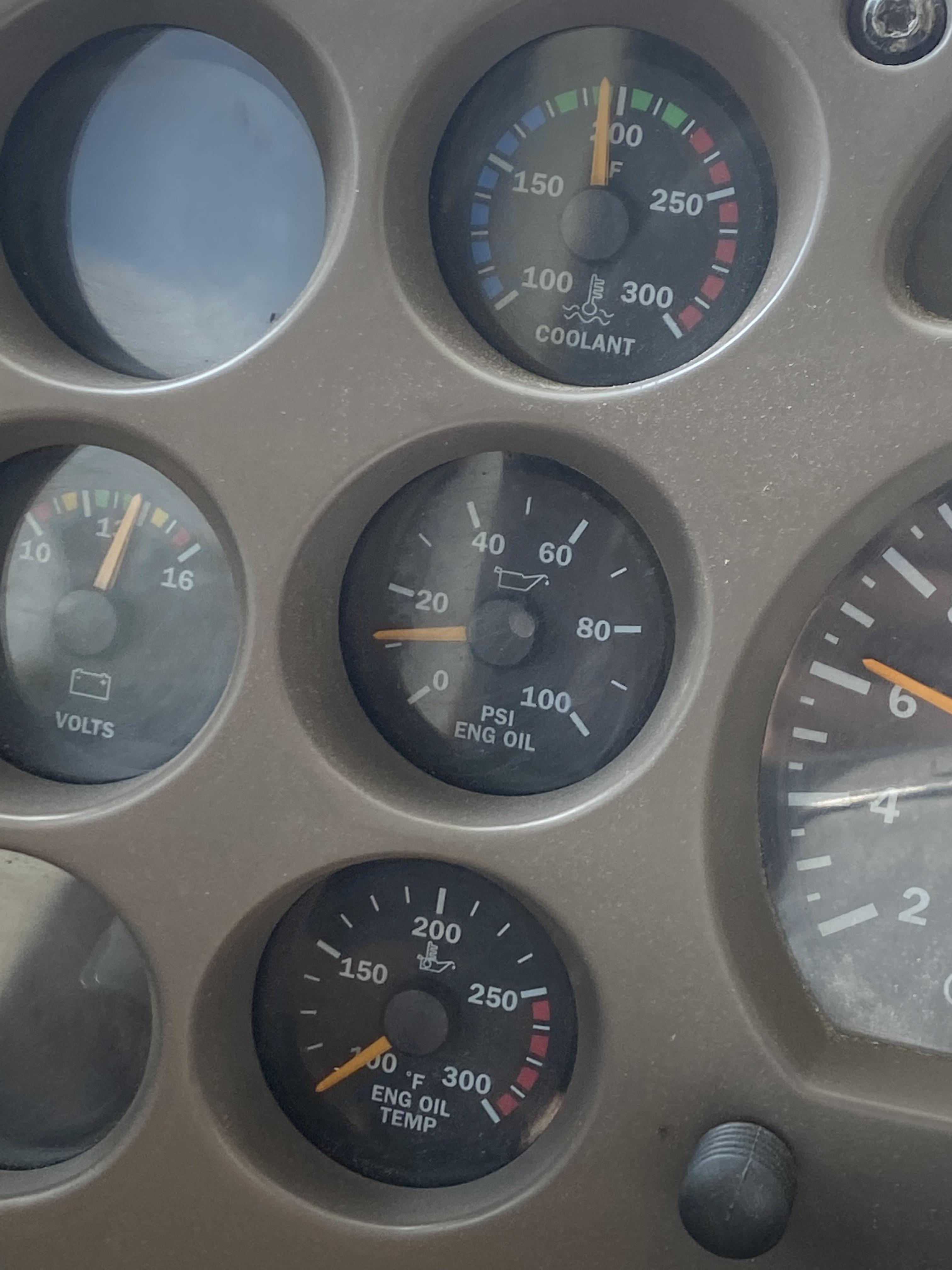

@Vmac3 2007 Mack Chn 613 with a aset 427 in it & it’s got new turbo, new vgt actuator, new boost sensor, new boost pressure valve, new air filter, egr blocked off, oil pressure at idle & to temp is about 12psi & truck has 588k on it

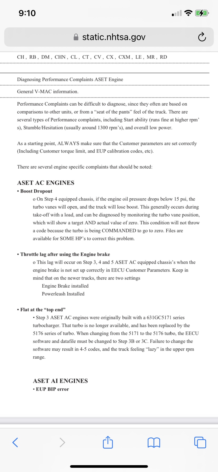

What’s the model and last 6 of Vin and I can have my guy see what software levels are in it
.Sounds to me Mp is on the right path ! Don't think the EGR block is doing it The egr should be throwing a code for mass flo out of parameter! this shows up a few KM after you block it ! Your first boost drop out complaint is pretty exact and some of the other stuff  on the list as well there as well! worth a shot  doing a reflash! Something may have got corrupted in the program somewhere! (not the first time!) Also if all else fails check the ECM plugs for coolant wicking! relatively common on the older chassis! just something to look at!

I see you are getting some good advice on diagnostics..  Did you happen to put a gauge in one of the oil gallery ports to see if the oil pressure is truly low??  I have one on a 12 foot long hose, it rides in the cab with me when I test drive...
I have not done that yet
there are plugs on the oil filter pad..  on the right is 2 ports, sometimes only one sensor, so you can use the other one to get a true reading.   you can also remove the pressure sensor, install a 'T' fitting then put the sensor into that fitting with the pnuematic gauge, and check it,   jojo
