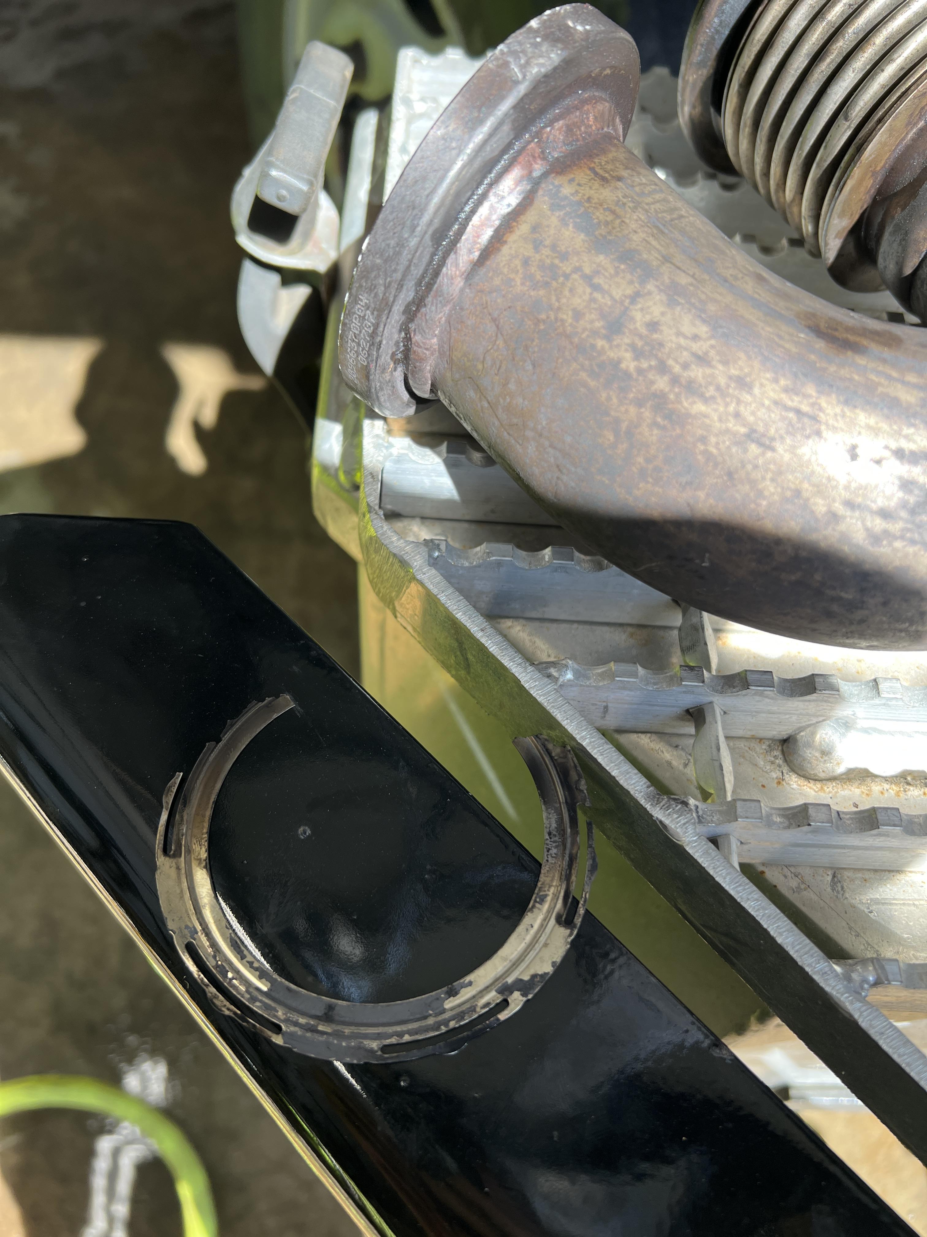

 is the flange bent, from too much tweaking?  They can be a pain at times, as far as the getting them to seal.. I see the flat steel seal in the picture, has been leaking for a bit.  Those little tabs are supposed to be your friend when going back together..  Which truck is it?   Just curios, Jojo
Yup for those unfamiliar! the best way to find those is to do a regen get the squeal going if the truck will allow you to and pour some hot water over the suspect area’s and listen for the sound to change! At least that’s how our guys tracked these down!
Just used soapy water once the truck was cold. With an exhaust leak that bad should be able to find quickly even at idle. Correct me if im wrong, but I believe you wont find any leaks after the egr valve during regen as the valve should be closed? However I do like that hot water trick!
Edited by Onyx610
It was leaking all around but when I took it off, the bottom of the gasket was gone so you couldn’t see it. That half must have burned up to nothing because it was no where to be found. And yes I looked in the cooler to make sure it wasn’t in there haha.
