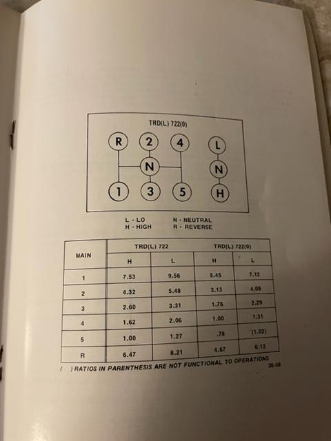

10 speed direct.  That's the "Duplex".  You can split each gear for a total of 10 forward.  2 reverse.  So, yes, a TRD-72 or -722.  Probably -722.  Could be the "L" or not.  Depends on the case material.
the 9 speed (-720 or 7220) was direct in 4th, overdrive 5th, so you typically skipped Lo-5th (duplicate of Hi-4th).  Just went from Hi-4th to Hi-5th.

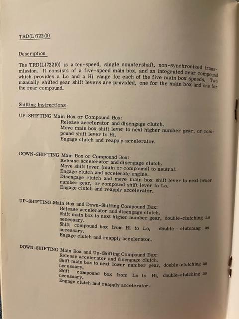

I always loved the split-shifting instructions they gave (like on the bottom of snowdog's post).  They show shifting the main box first in all cases.  I never found that to be true.  If down-shifting the main and upshifting the compound, I found it better to upshift the compound first, then double-clutch and downshift the main last.  Reason is simple.  If you have enough RPM available to downshift the main first, then why even bother splitting it!  Just downshift the main and put your foot back in it.  So, I always upshifted whichever box was going up first, then downshifted the other.  Worked better.  If you learn really well, you do them simultaneously.  But, when you miss one, it's hilarious for everybody else to watch as you try to get them back in, stop, and start all over.  Ask me how I know that!
In reality, you don't need to split the gears most of the time.  You can usually stay in Lo, use 1-5 in the main, then shift to Hi.  Probably start off in 2nd even.

I was told by the owner that this truck is really low geared and that you just took off in low shifted the main through the gears and then shifted to high.
Yep.  You should be good with exactly that.  No need to split the gears unless heavily loaded, and even then it's questionable.  We've talked about that several times on here before.  Empty, you probably don't even need 1st gear.
