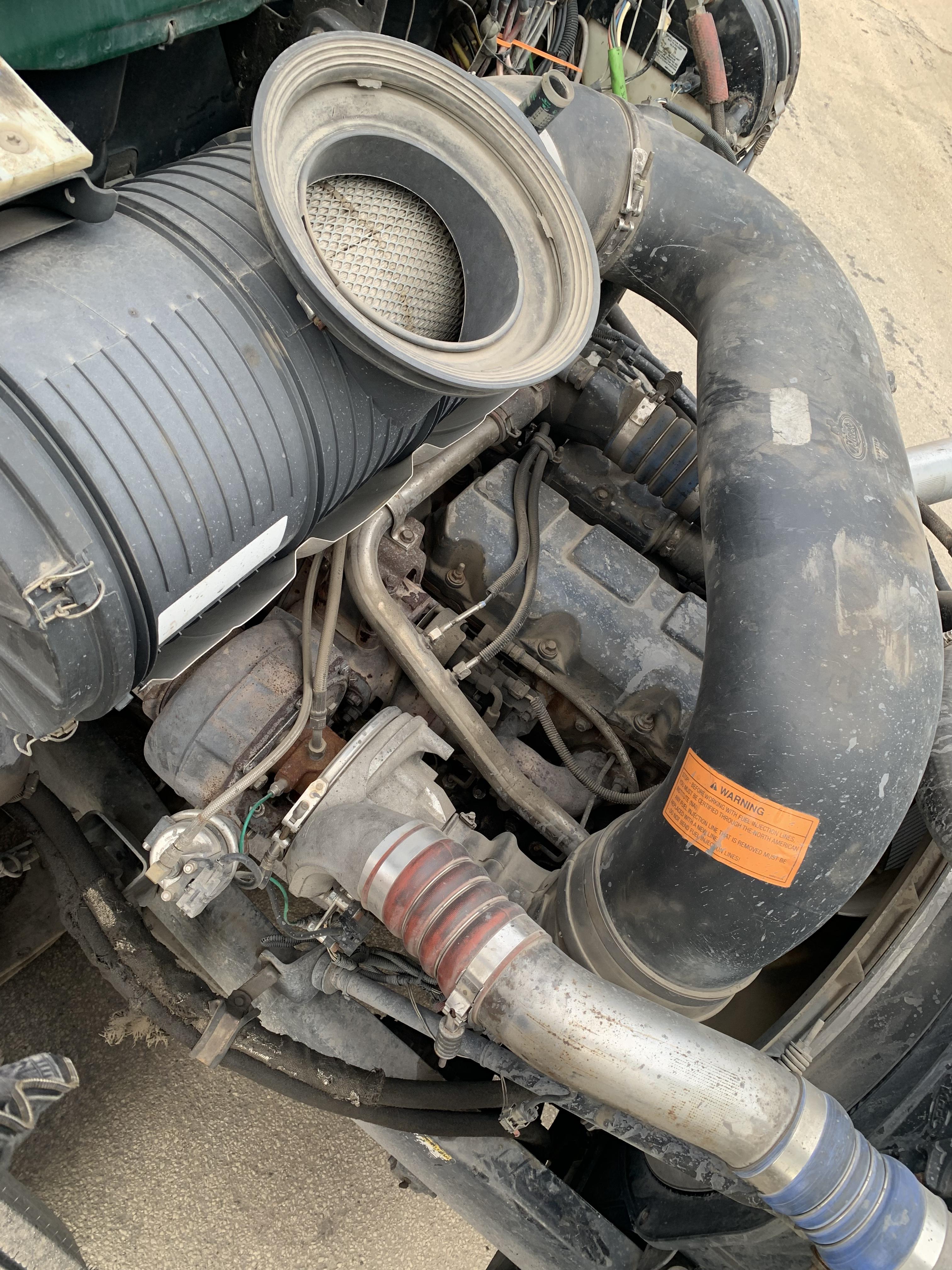

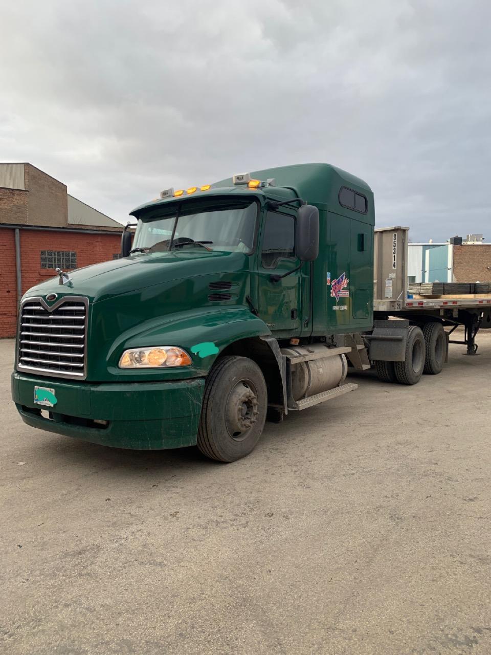

With this 2007 mack cxn613 AC 427 Engine with almost 900k miles.
I’ve had Installed A new ECU, new Oil Pump, new Oil Cooler, 1 new piston cooler nozzle(because 1 was bent) , new Oil Pressure sensor, new Rods and mains bearings. New oil filters along with new 15W40 engine Oil… Even with all these new parts I am still having my main issue which is low Engine Oil PSI/power loss performance. Because this is an ASET Engine; being very computerized… could the “technology”/sensors be the complications to the issue I am having??

I really don’t have much of an update fellas. Just been running my truck like this honestly until it will finally break down and it just doesn’t, not even shut itself off when the “engine shutdown” light come up and stays on… as I’ve said, when it the engine is cold it has no issues at all, until the engine is hot. That’s when the loss of Power/Chugging between gears(at the same time with blue smoke blowing out the exhaust) happens.. there are not leaks anywhere around the motor, I know the problems are internally, so I’ve bought an Overhaul Kit along with some Cam Bearings praying to God that by doing this, will solve all my damn problems with this truck..
