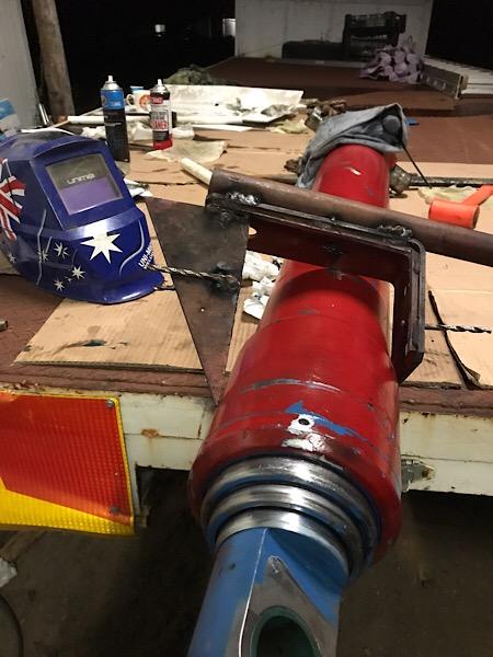

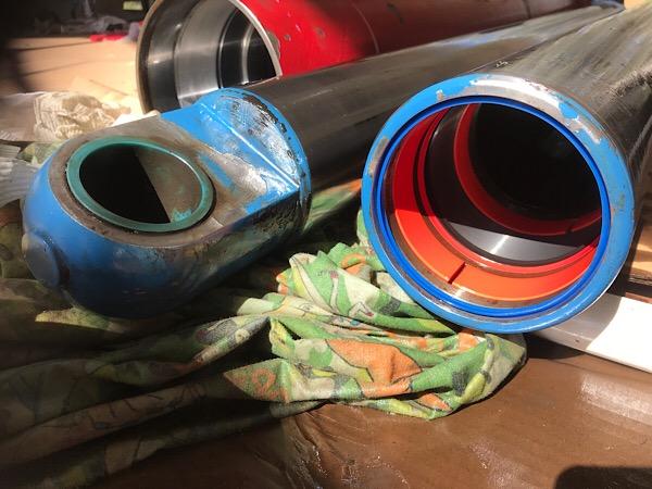

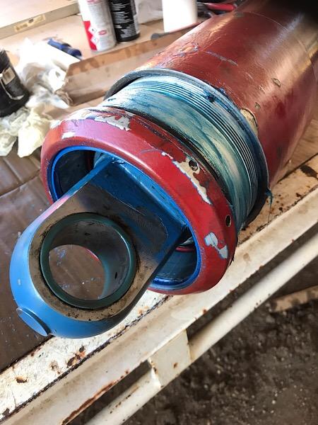

A truck mechanic offered to do this job for $90 an hr Friday morning when I asked around. Glad I decided to have a go. I might even be able to afford a tank of diesel after doing this if she all works Hahaha

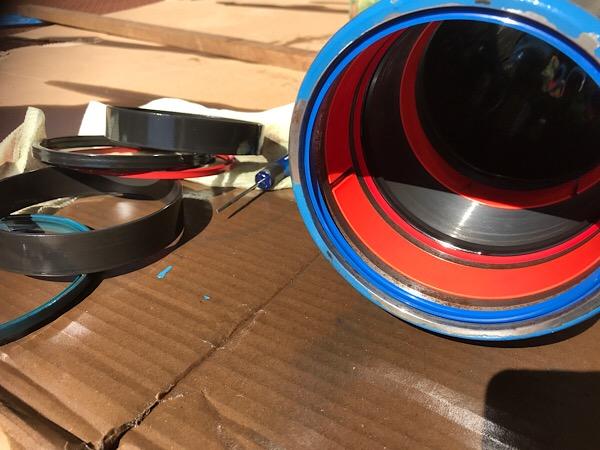

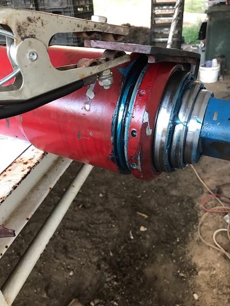

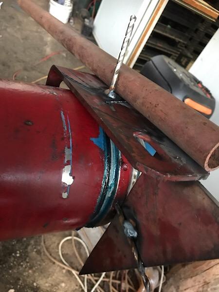

I like pictures on repair type jobs. Silly mistakes can be picked up on by the more experienced and gives everyone a bit of entertainment at the same time. I’m looking forward to getting this rig registered and on the Rd. Glad to find a great Mack forum where I can get a bit of help with things on the truck.
Thanks Guys.

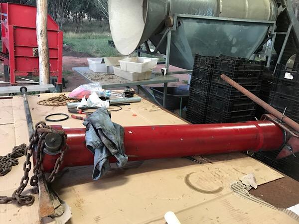

Got the ram back in this arvo and looks like we have had a win. No leaks and it goes up and down but I didnt like the looks of the oil that I released out of the air bleed bolt at top of ram to purge air. Looks contaminated with specks of perished hydraulic hose interior sidewalls. I will give it some new hoses  and a bit of a tank cleanout I think.
