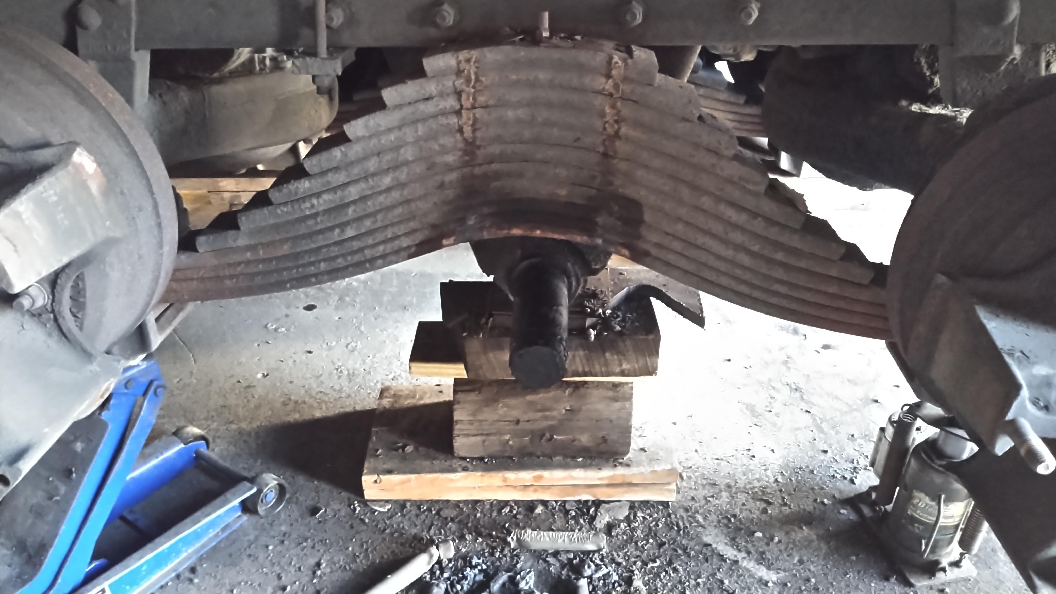

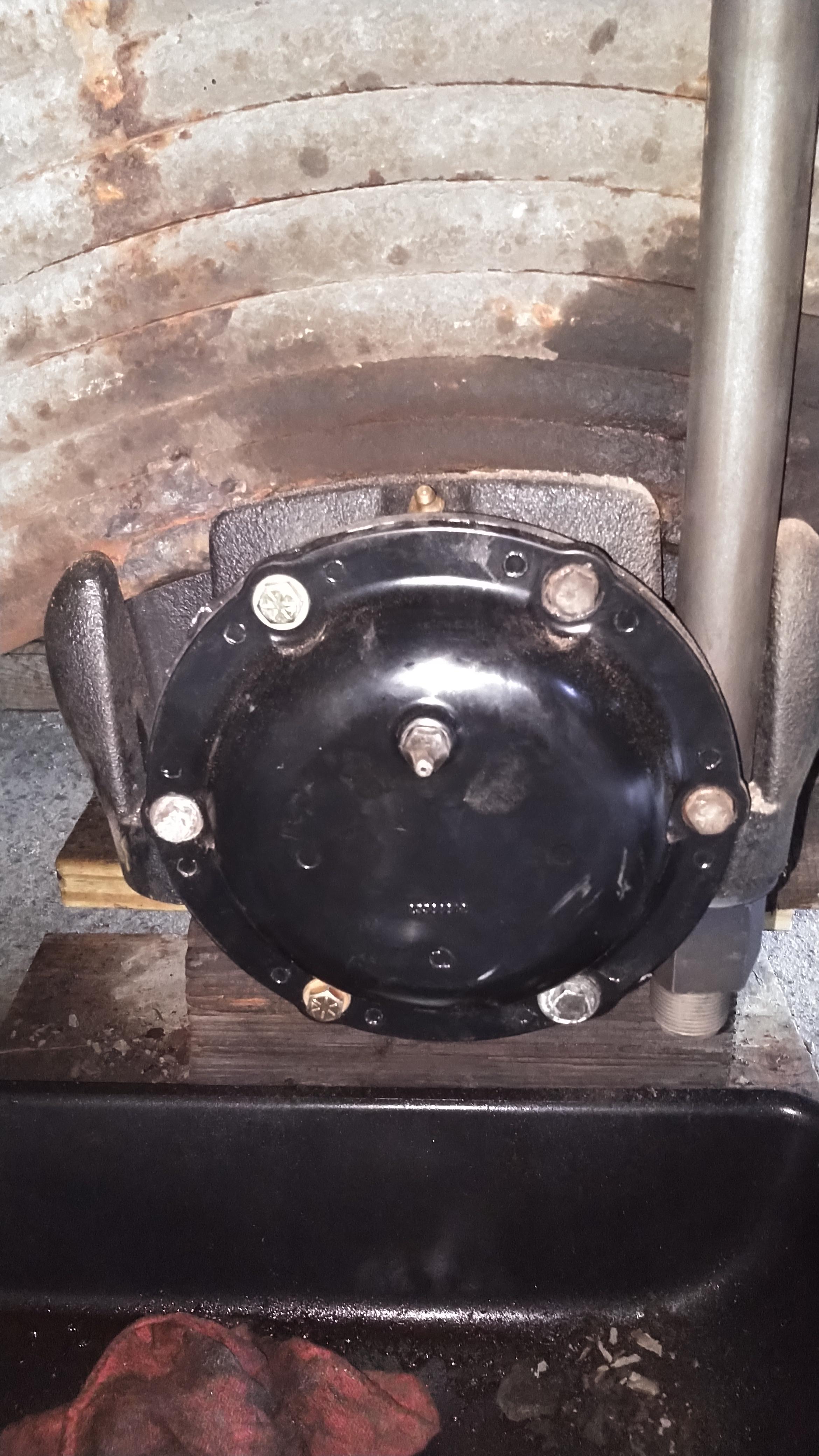

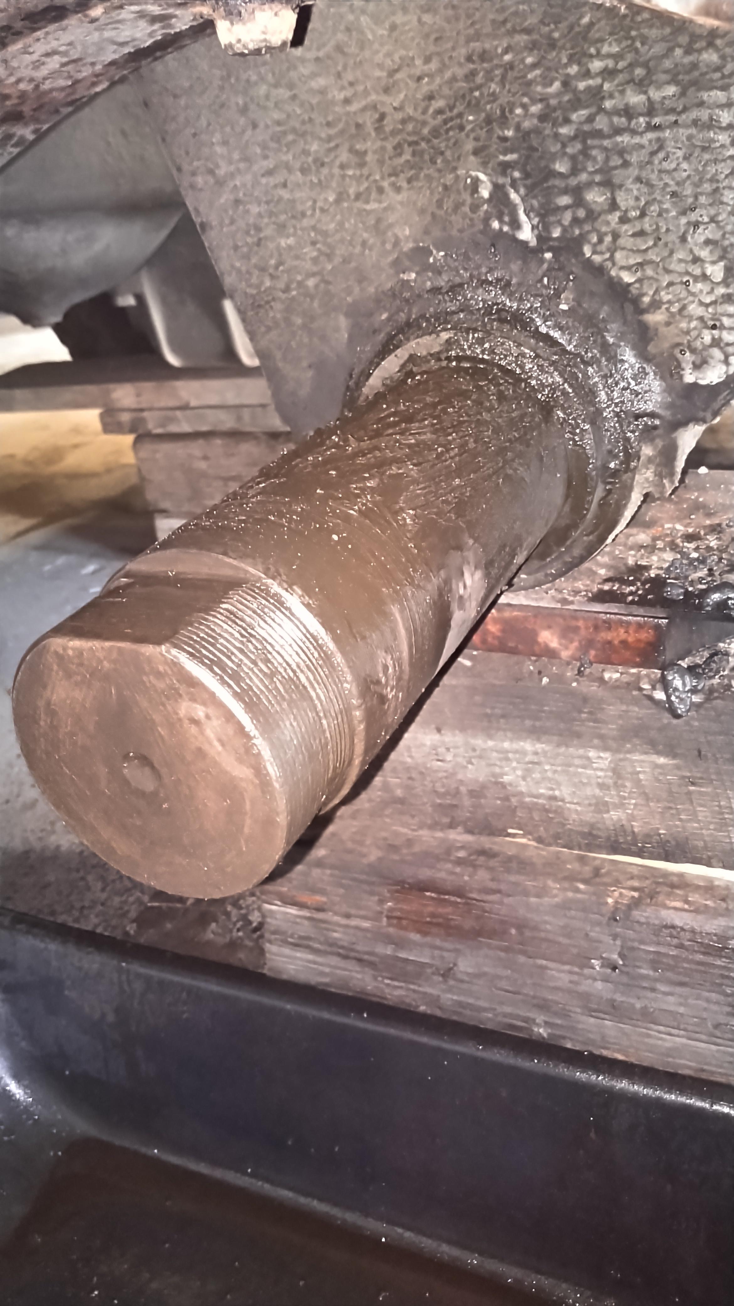

Trunnion bar on our dm686SX broke probably 8 years ago. Don't remember what all was involved, I just remember the bar was about 3 to 500 lbs of solid steel. When it broke the external trunnion stand brackets sat down on the spring u bolts.
I think if I were going to go to the effort of replacing bushings (which I plan to this year on one of my trucks that needs springs) I'd replace the bar as well. I don't think it's too difficult, the rear of the truck frame should get set up on blocking or HD metal sawhorse so that the camelbacks hang. If taking the dump bed off isn't a challenge for you then I'd say that's a prudent safety move that may make access a little easier.
The bar on 44 rears is part of the stand,not removable..

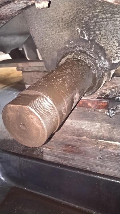

if the stand is good and passes DOT inspection,,, then the axle surgeon can cut out the trunnion bar and weld in a new one.  Just saying,  ive had 4 done,,  it saved a ton of labor and cost...  jojo

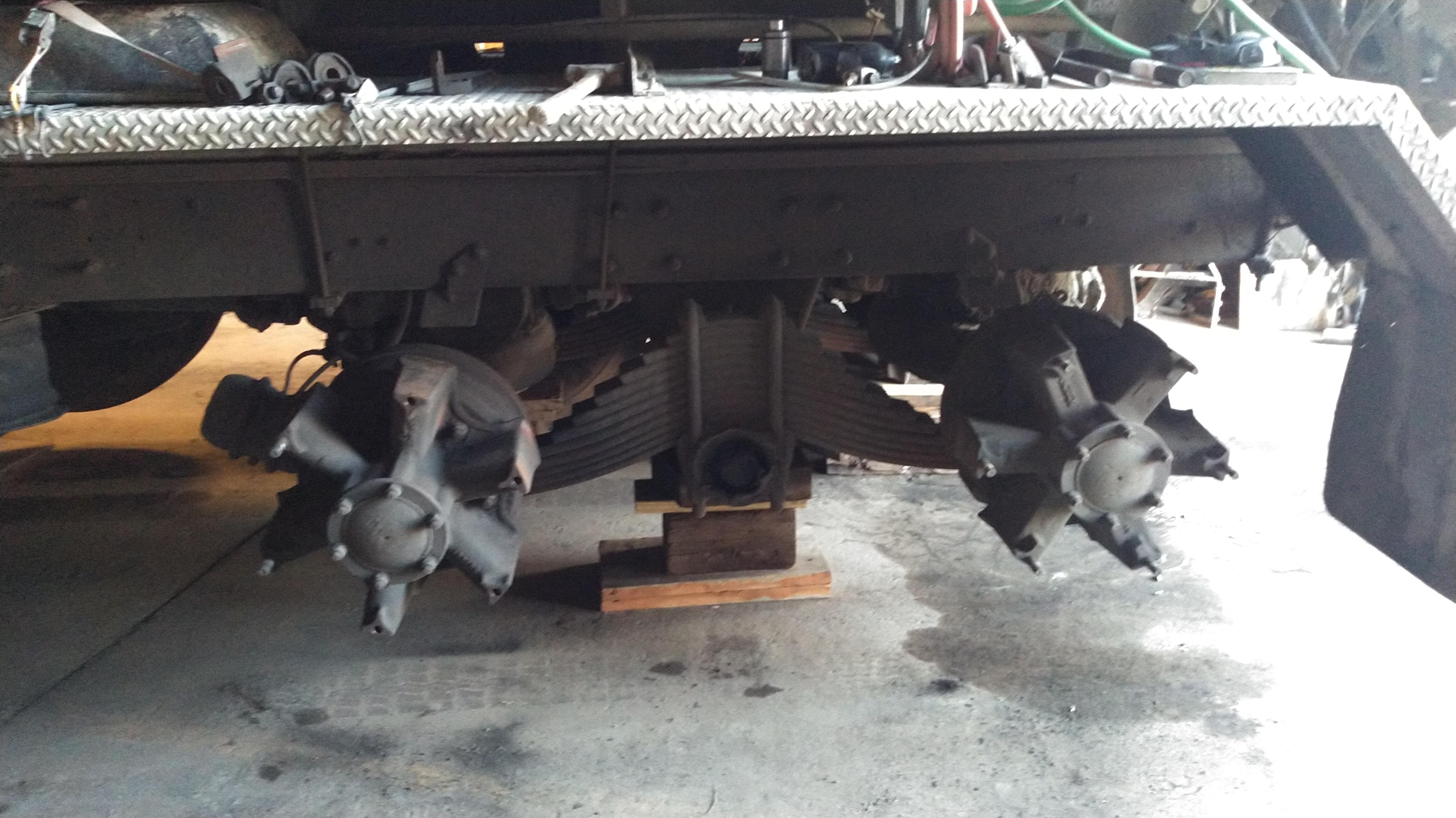

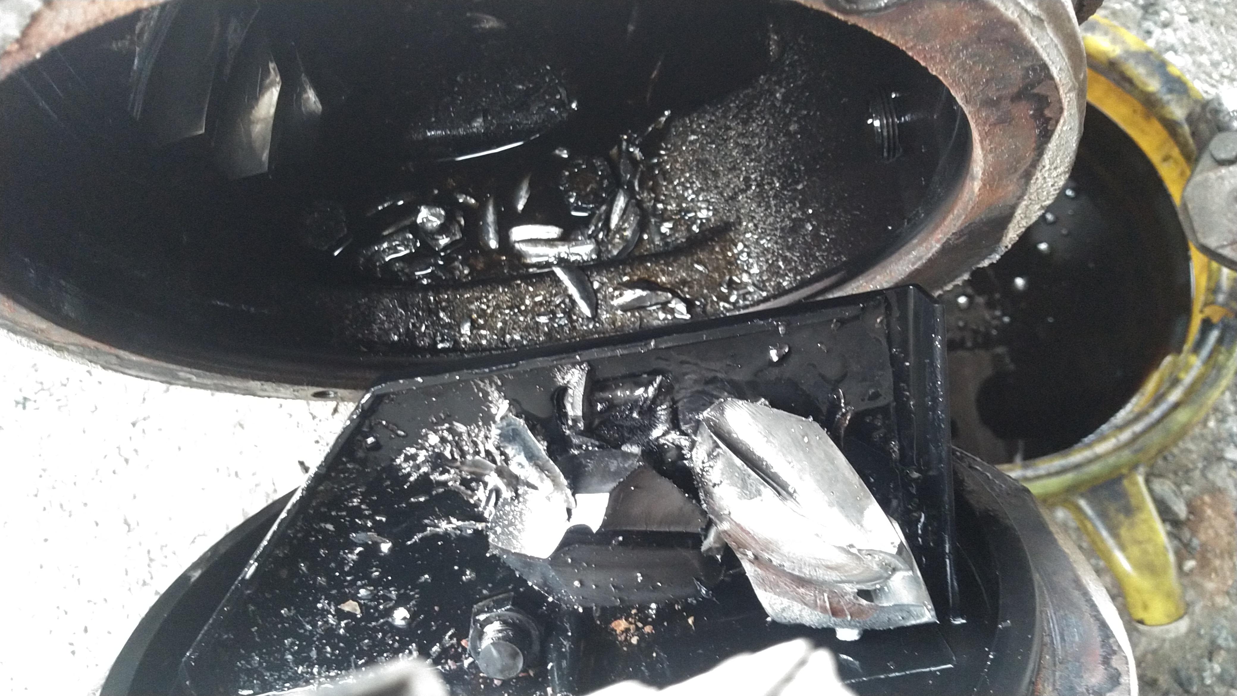

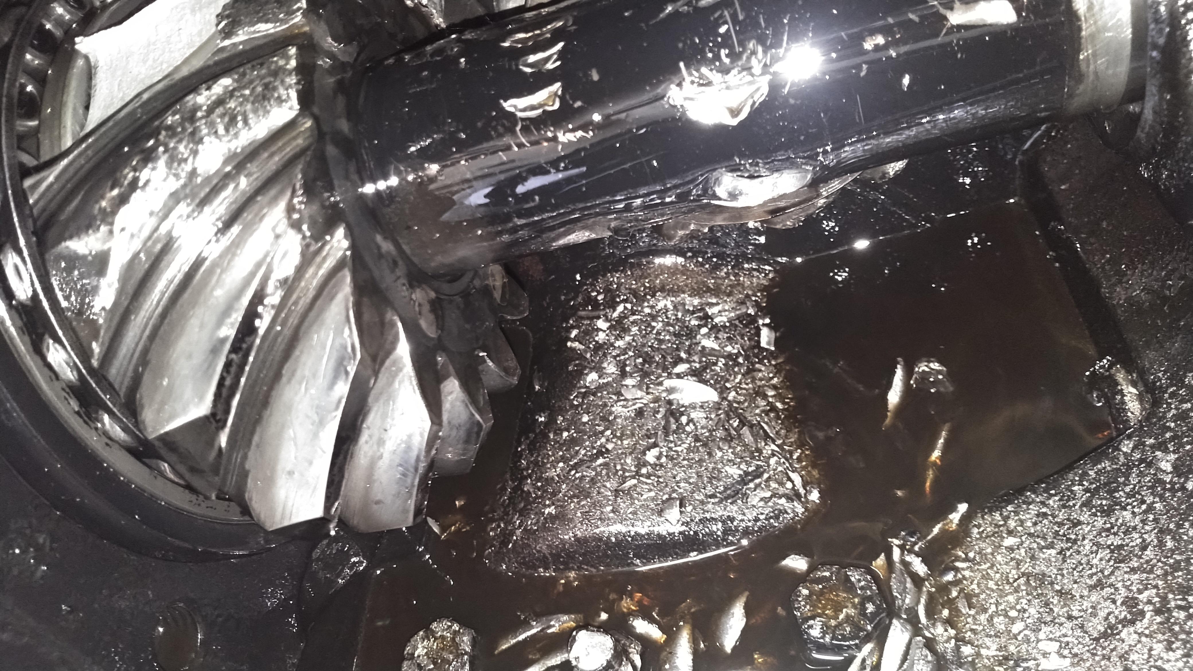

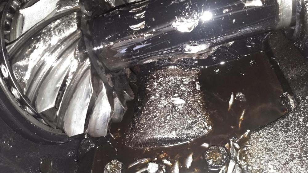

it's great that the trunnion bar was re-usable..  quick turn around..  Im also impressed that you didnt spend 2 hours knocking the saddle out..  I have to pull a Mack carrier out tomorrow,,  I pulled the side cover and gear chunks and teeth fell out,,  driver said he got stuck, then got it out, then drove to the quarry,  on the way out of the quarry,, the truck locked up...   No Sh!t...

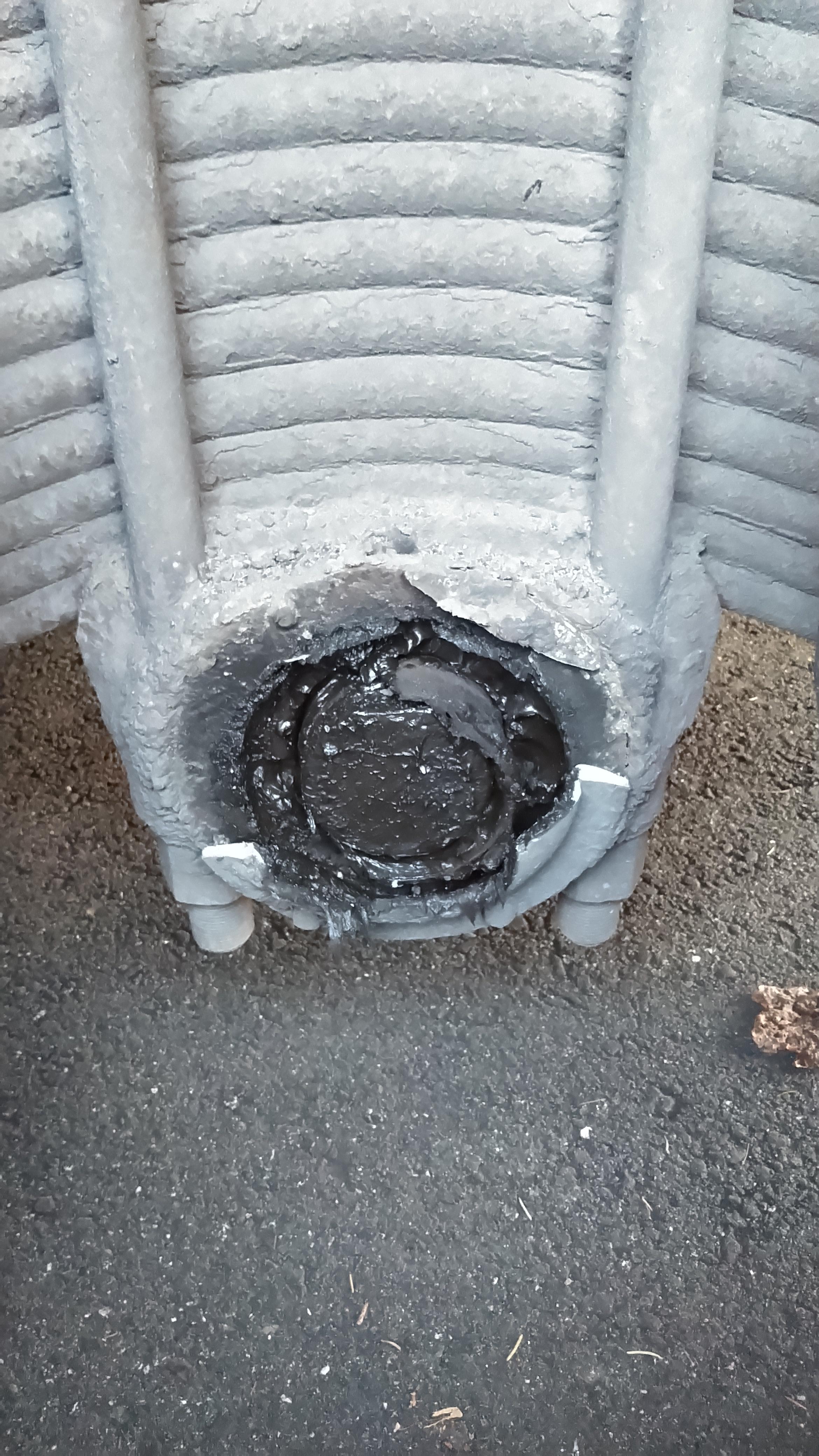

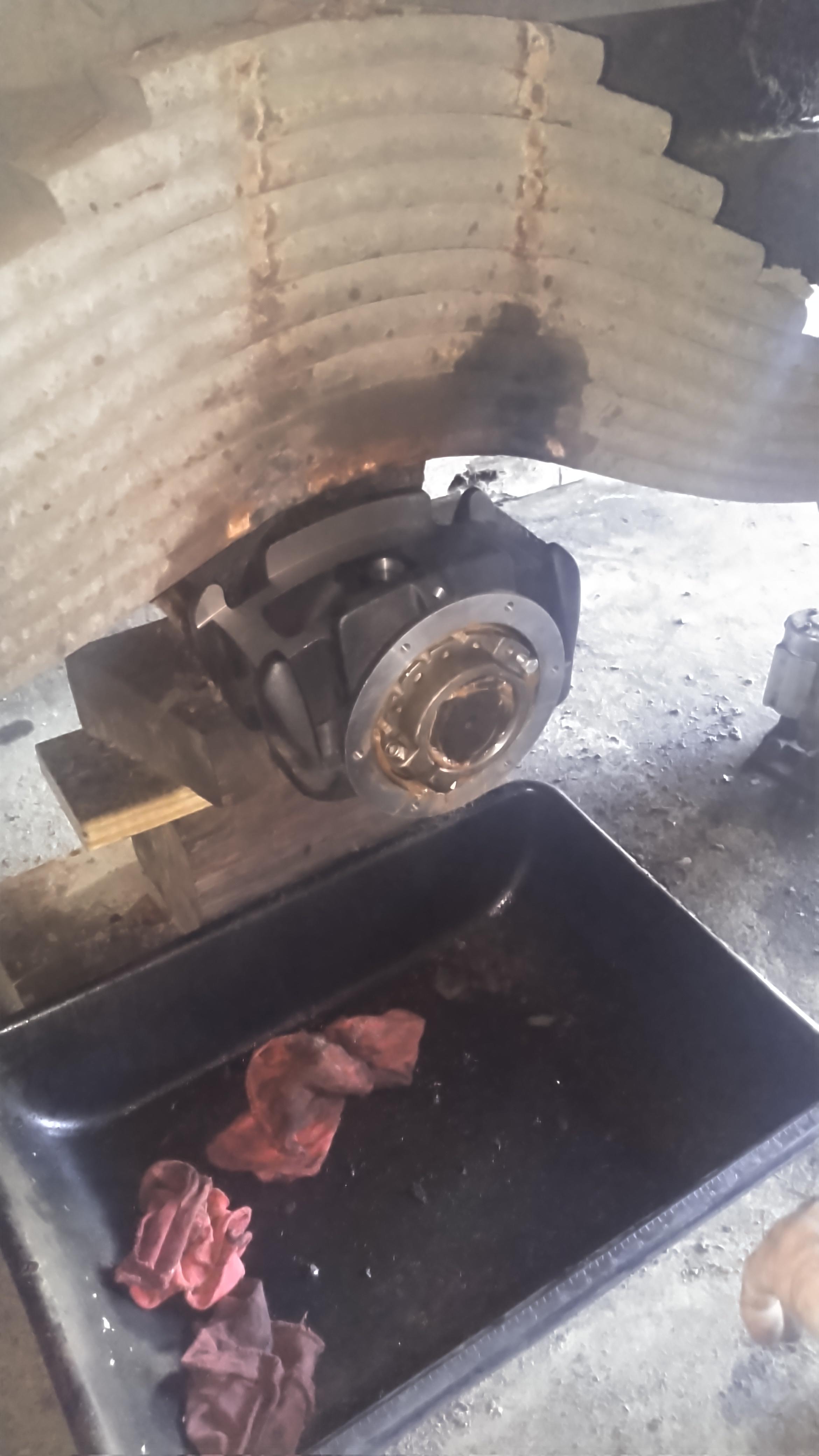

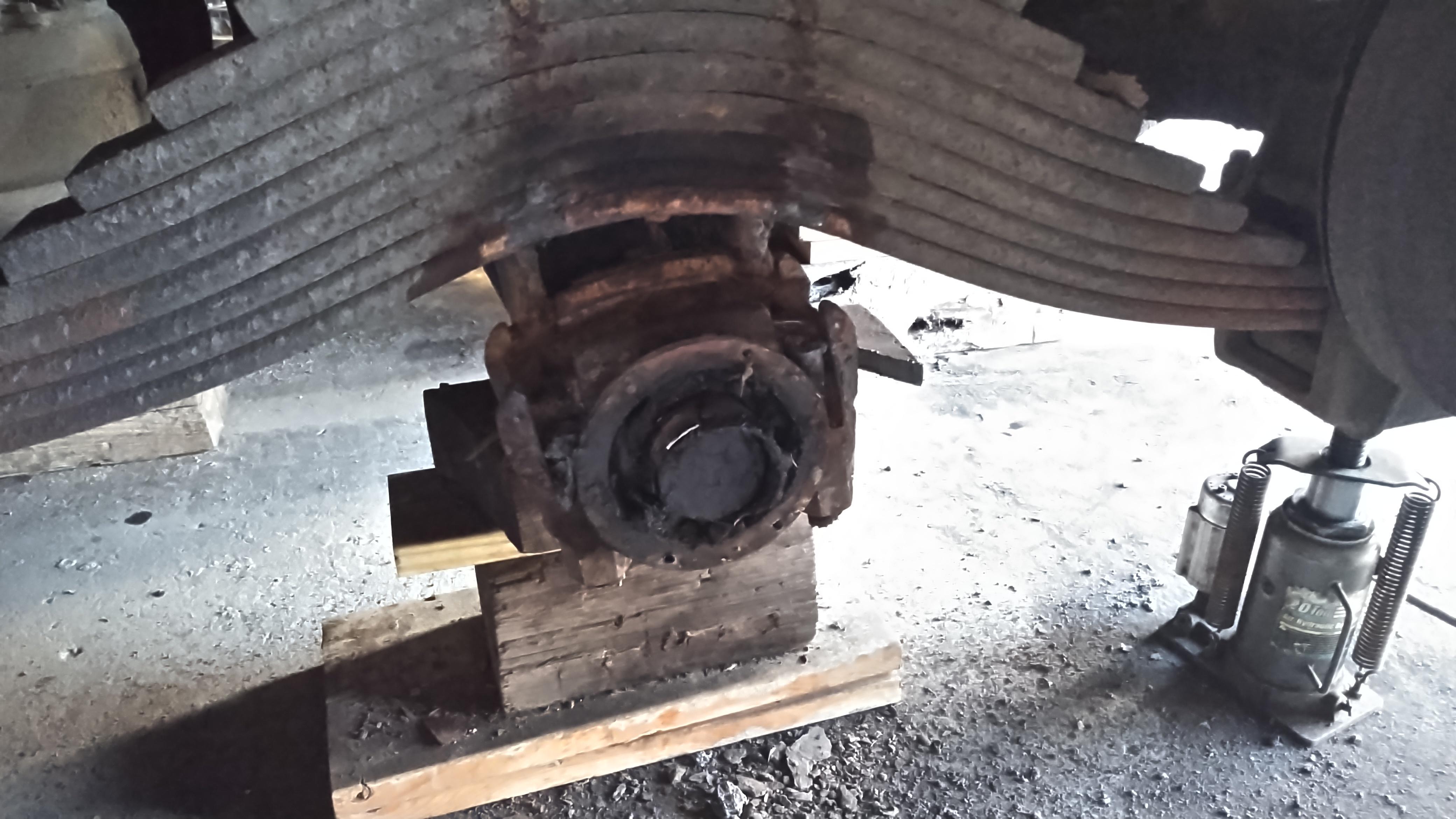

We had the driver side floating above the cribbing, resting on jacks on the elephant pads while we drive the air chisel in between the saddle and lowest spring, right where the u bolt passage is.  Had to cut the u bolt pretty low to get access to that spot. Took us all of 10 minutes to get the truck to drop off the spring onto the cribbing.
Always important to remember that Mack trucks HANG from the rear springs!
