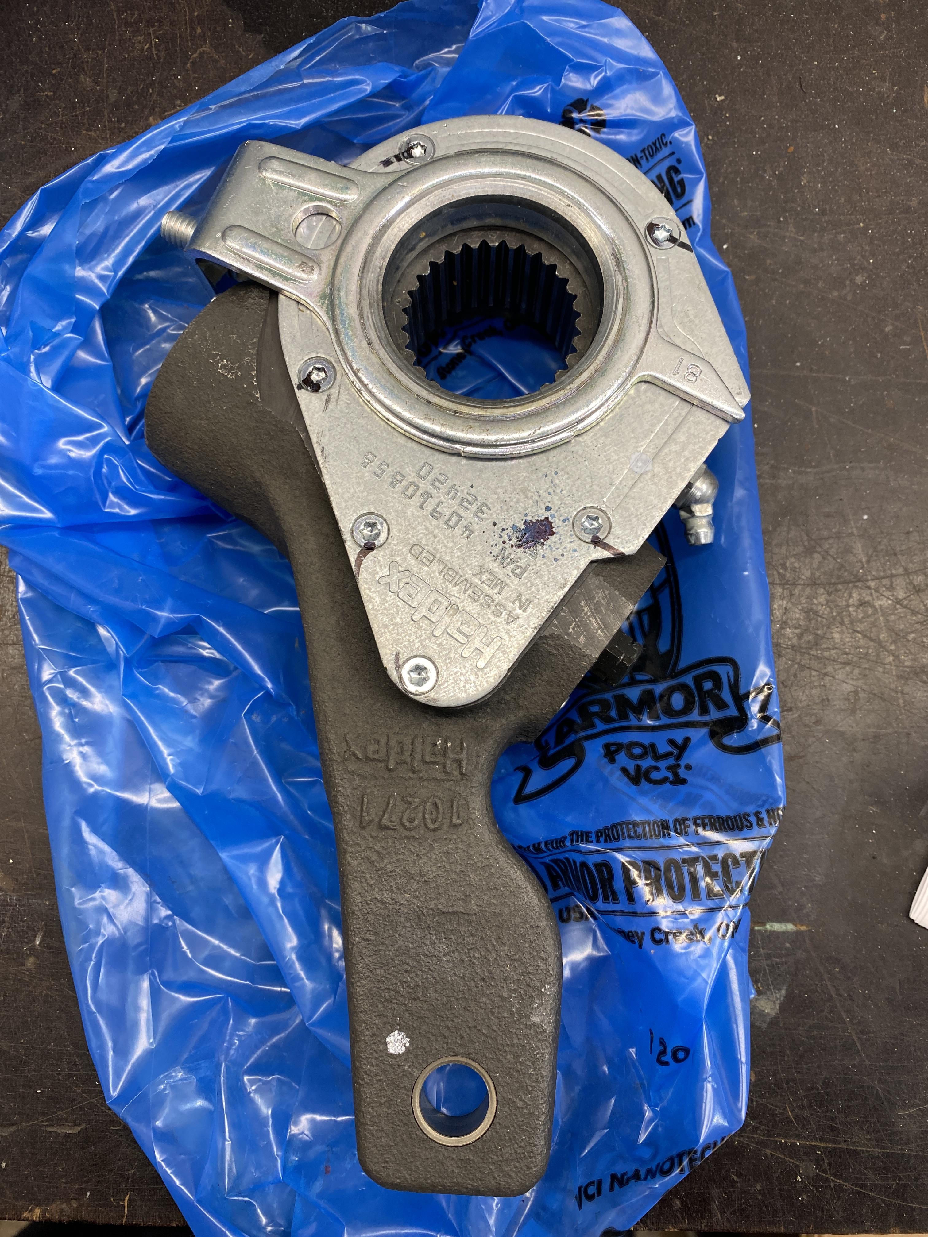

Hi Mackey...  on the RW I was working on, we just put the old, working, manual slacks back on..  rather trying to remove the S-Cam and machining another snap ring groove in it and then try to put it back together..  jojo
I get it...  Being pushed to get the truck out of the shop, can cause more harm than good in some cases..  ..But you got yours fixed,  so thats good..   jojo
1 hour ago, mackey58 said:
They had the s cams out cause they needed bushings but when your pushed get stuff together. I dont mind manual, but sometimes that collar dont pop up .no matter how much you keep them greased.
Helps before pushing the collar down, give it a dose of penetrating oil.  Terry
yes terry,  I have done that and then use a socket or wrench depending on the room to do so, and moderately tapped it with a hammer rapidly until I could feel it pushing out on its own..  jojo
