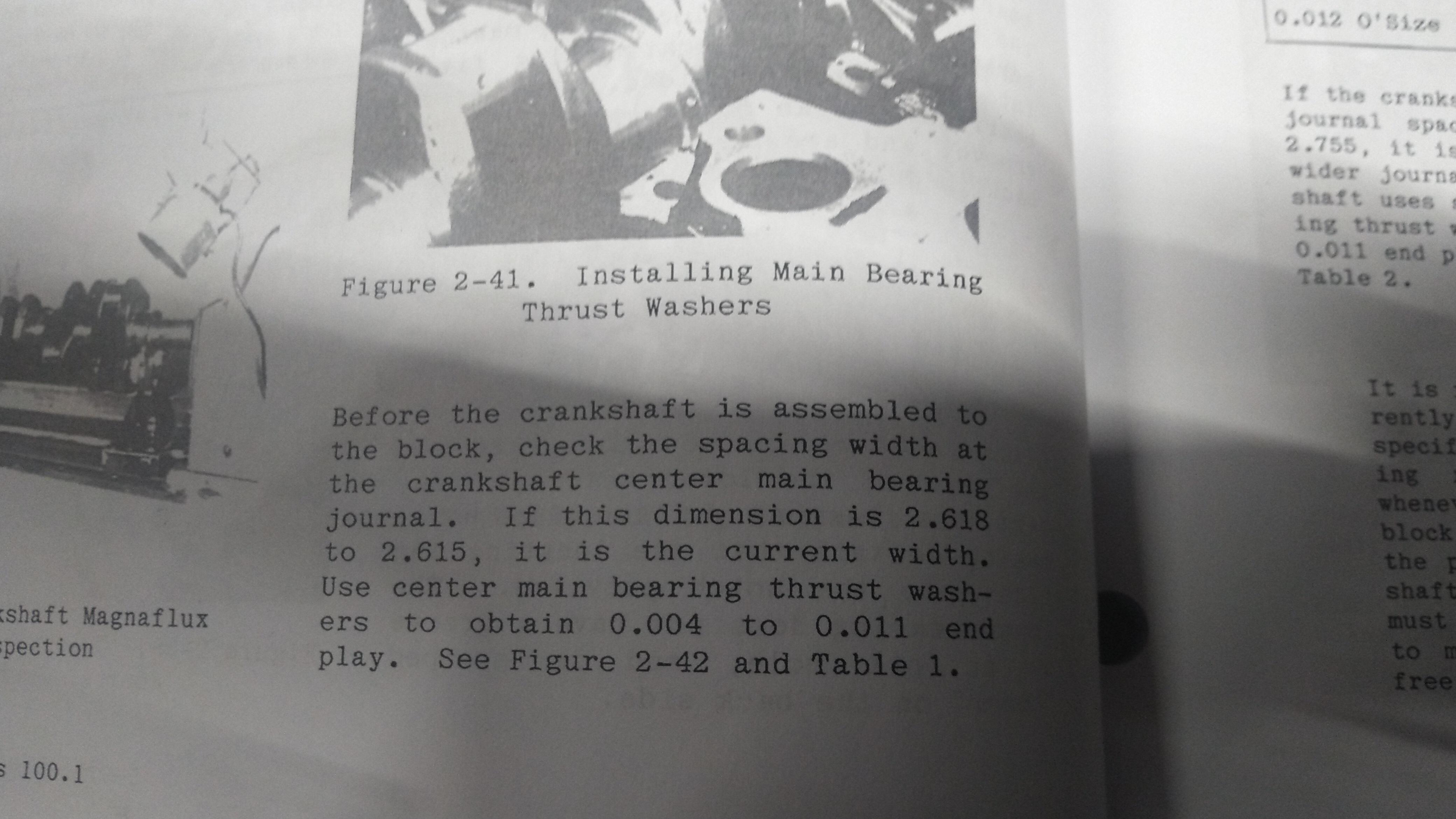

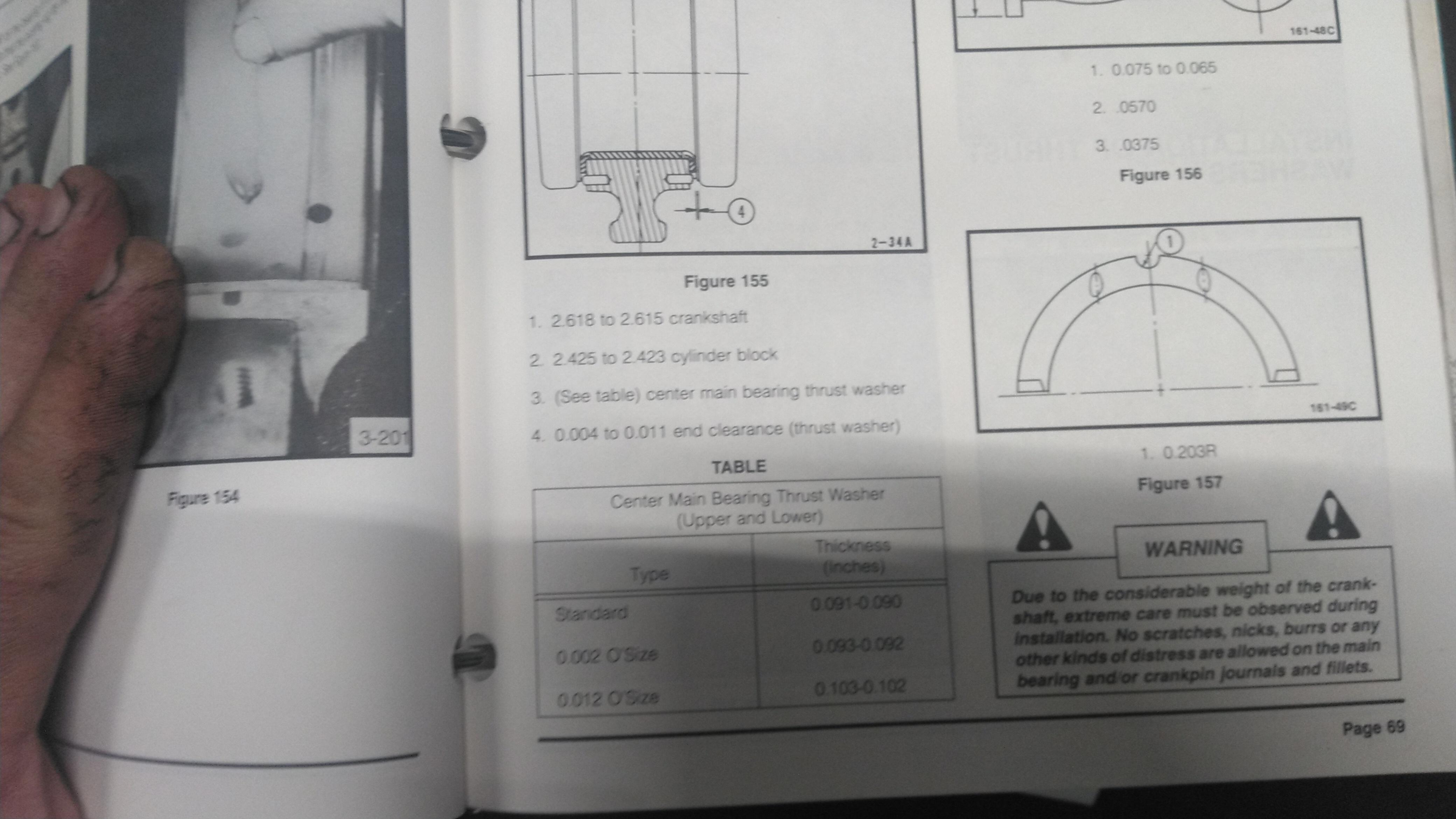

good one Mech...  I have a 3/8" car brake line that i use..  it works too.. simple, cheap, and these tools work..   I was close on the crankshaft end play...  It's .004"-.011"... the first pic is E-6 2 valve, the second is E-6 4 valve..jojo
