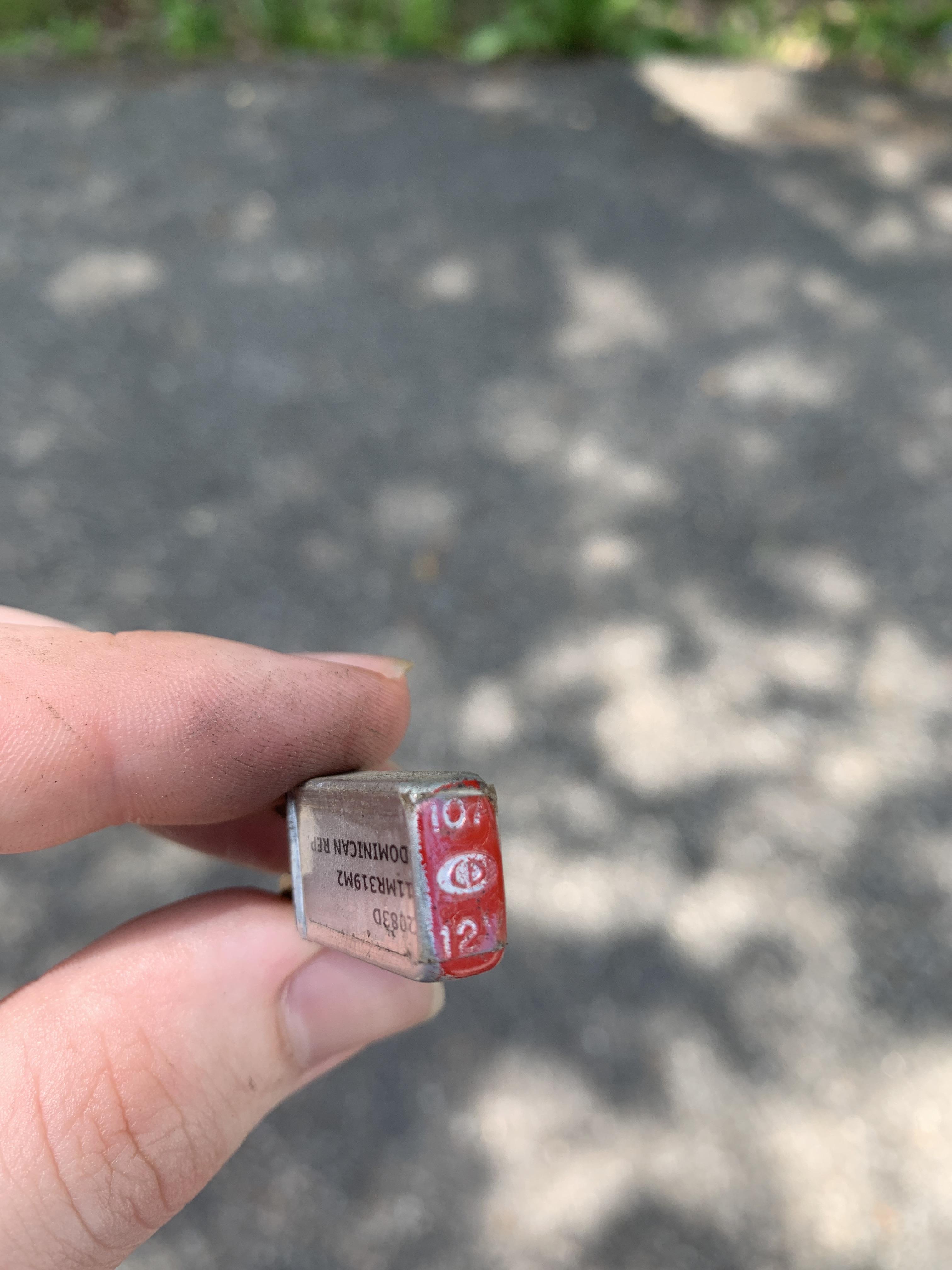

That’s a circuit breaker, you can test it with a volt meter or switch it with a known good one and see if that fixes it.
I was at the dealer picking up my speed sensor, and I was talking to the guy at the counter, he brought up a good point. If that circuit breaker was bad, I wouldn’t be getting the 12v at the plug, I told him I jumped the plug and still no lights, he said there’ a good chance that the bulbs could all be Burnt out. So I think I’m going to try to figure out how you take the cluster out so I can check the bulbs

I checked the circuit breaker for the gauge lights and it had continuity. I tried a different circuit breaker, same result no gauge lights. Not sure if there’s a delay for the gauge lights by themselves. I may have to end up taking the cluster out and looking around.
