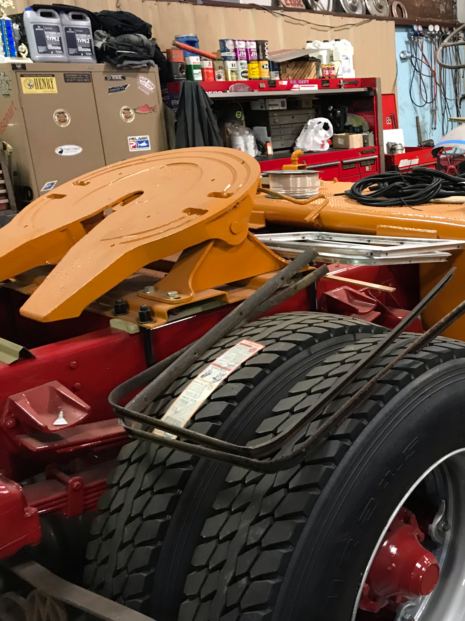

Possibly a corrosion reason?
Paul, I DO NOT think he will have a problem with rego as our rules are not a strict as yours, especially for antique / historical plates. The States do not have the "engineer" certification rule after every little change that you do..
Brocky
1 hour ago, Hayseed said:
Yep, there has to be a Minimum 5mm Gap between the top flange & the Base plate..
Also those Angles wouldn't comply down here either.. they have to be longer than the Chassis rails are apart..
Rust is one reason , but the main one is on our Rough terrain they're touching & the chassis flex will cause rubbing that may cause a fatigue Crack in the Top Flange of the Rail..
back in the day; 5th wheels were mounted with only long u-bolts ; way too much movement. most all wheels mounted later were bolted to their own  plates which were bolted to angle iron bolted through the frame rails not the frame flange . as stated earlier, with out the main frame plate  on the 5th wheel too much flex would be on the chassis. of the 50-60 + 5th wheels i mounted while at Mack none were direct mount to the frame. all were either welded to angle iron   bolted to the frame (sliders) or bolted to the iron that was bolted to frame (fixed).
Same Here Too... i think It was mid/late 80's when  they banned U-Bolt fixing of Turntables here..
^^^^^ This is the way the  law has required since the Mid/late 80's
Pages 12-15 here explains It...
 https://www.nhvr.gov.au/files/201901-0643-vsb6-section-p-tow-couplings.pdf
"Be who you are and say what you feel...
Because those that matter...
don't mind...
And those that mind....
don't matter." -
I've seen a bunch of trucks with u-bolt mounting that had blocks of steel welded to the frame rail flange to keep the thing from moving back and forth. Of course, they shouldn't be welding on that flange.
welding on the flange would ultimately crack the flange. many of the u-bolt set ups had flat stock welded to the 5th wheel and ran along top of frame having other end welded to rear of frame rail location of less stress . another thought, when days of u-bolt mounting took place, trucks weren't (on a regular basis) carrying 100 K payloads. still find myself totally amazed  looking at old pictures of loadbeds hauling huge construction equipment using chain drive tractors. air brakes ???😄 no. had friend tell me of him loading old cable excavator on flat bed ; when he started up rear of trailer the tractor lifted off the ground and away the whole unit went, tractor was the only source of brakes (hand brake)..LOL
The biggest problem with U bolts I believe was to keep things secure they are done tight
The tighter the U bolt is done up the more it deforms the chassis and bends the flanges in making the whole show weaker
To get around this issue people had nice cut bits of wood that fitted really neat in the chassis to stop the fangles getting squashed
These bits of wood had to be hammered in as they were a very neat fit
The bits of wood also had a groove in them that the U bolt fitted neatly in
This stopped the wood coming out and the flanges getting squashed
In the end I think it was just easier and cheaper to bolt angle iron on and be done with it
Paul

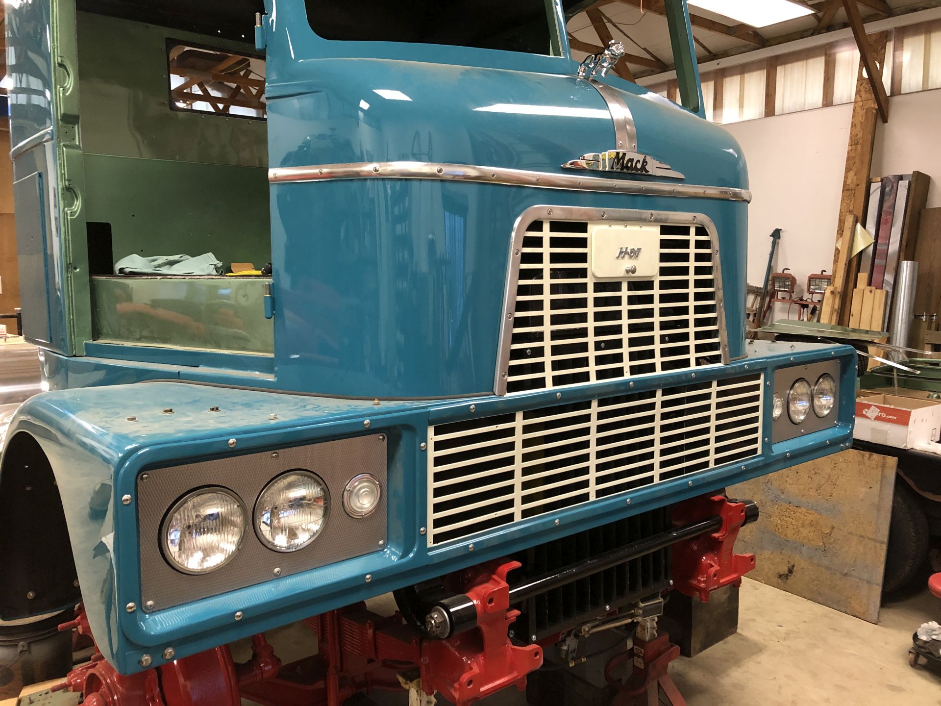

Looks great!
That's definitely one of those moments we spend months of work to enjoy for a few minutes. Ok, you can pull it in time for a quoter an hour. Or for a few hours, days or weeks :)
