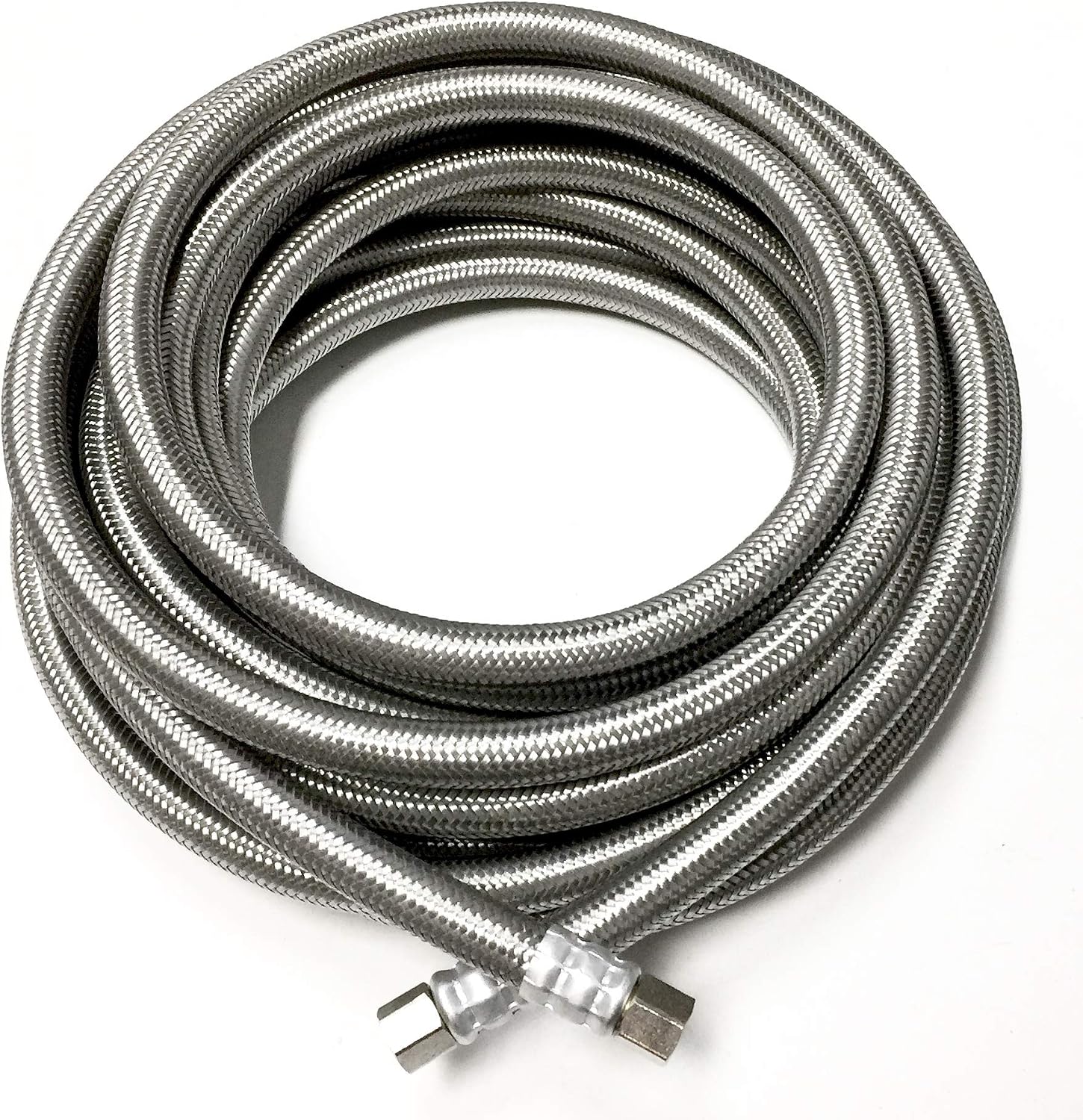

My husband said that he could blow through it until it heated up and it would swell up inside of the hose once heated and he couldn’t blow through it.
The only place open 24/7 that may by chance have that braided hose is Freightliner in Houston. This tank has fine metric threads and I’d bet that Mack is the only place to get it. The new air tank had an extra hole so we had to get a plug from Mack this morning.
Thanks again! I’m grateful for your input. I do believe we are back in business...with a whole new air brake system😂
I always run type "K" copper pipe for the discharge of the air compressor to the drier, or wet tank. This is a heavy wall type copper pipe and work hardens when you bend it but excels at both cooling the discharge air from the compressor, and condensing out the moisture due to the cooling effect. Don't attempt to bend type "K" pipe by hand as it will readily kink in the bending area.
I've seen the newer "teflon" stainless braided discharge hose used a lot and it works well but is expensive; albeit much easier to run. Anything needs support and both types require supporting that will preclude "drooping" or vibration to keep from moisture "pooling" in the line which will cause "slugging" of the output air.
