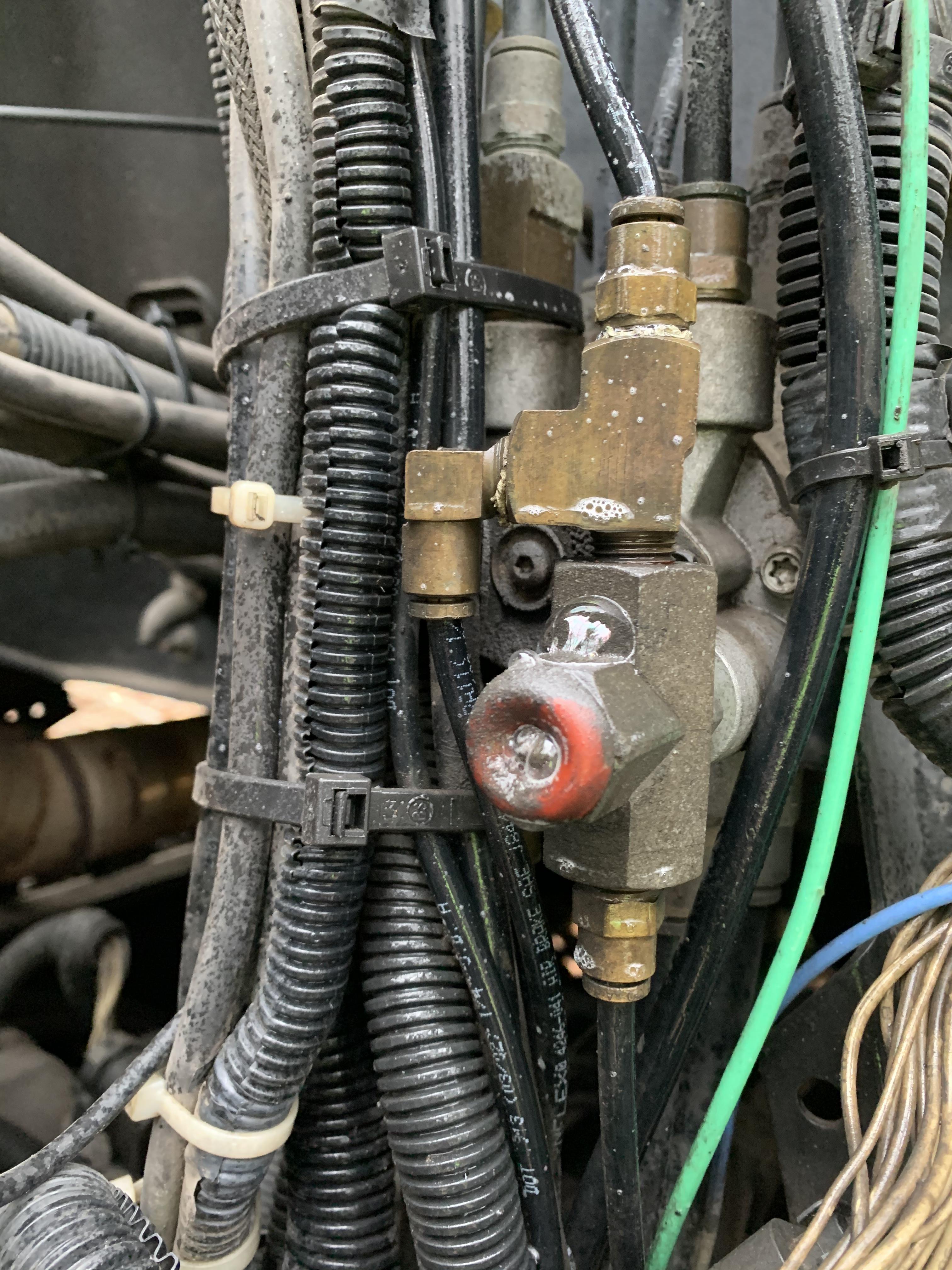

So little update, today I was able to install the new pressure valve. That I purchased yesterday. Take it off try to put the end one one, and the threads the wrong side. 40 min back to the dealer got the right one, put it on and it’s still leaking. ( I didn’t snug it up enough) so I gotta take the fittings off and do it again tomorow. While checking I put the parking brakes off and noticed this was hissing air. Only did it 2ce though so not sure if it’s just coincidental or not. See second video.

stsrted the truck and let it air up until the governor shutoff. Shut the truck off. Could hear some air leaking from the front of the truck, o opened the hood and started spraying airlines. Not exactly sure what this thing is or does but it was bubbling at the red part. Secondly I confirmed that when I flip the switch to drop the lift axle, the green needle dropped. So it seems that there’s a leak somewhere in that system and when it loses pressure, the axle drops. It’s a start. Hopefully when the rain stops o can lift the bed up and start checking under there. As well as the brake cans as I have a feeling that could also be a culprit
The green needle is for primary air. The red is for secondary.  The lift axle should be operating off of a solenoid.  When I'm the up position the solenoid will provide air to the lift bags and when in the ride position the air will go to the ride bags.
Now if you have a loss of air when I'm the up position, you'll want to check the ride bags. Then check the solenoid. Check the supply line for the solenoid which is very likely coming from a "red hat" pressure protection valve like you have in your picture.  I am pretty sure the CL pooping is different than the current generation trucks as the newer trucks have an air\elec solenoid pack near the right side front of bogey cross-member.

That little red cap valve ??   That truck can ( and likely does ) have more than one. Might find one on an air tank you can see from under the truck .  And they could be on either system.  Make liked that particular brand back in that era
3 minutes ago, Dmurph2016 said:
Isn’t that the valve that I just replaced? Not on the tank though. I’m going to assume the way it is setup is the way the body manufacture set it up, not sure why you’d go messing with what’s on what system?
The valve in the pic you posted is one of the old style pressure protection valves.  It will close when the pressure gets to low to protect against too much air loss which could seriously affect controlled braking.  Once you lose too much air your yellow button will pop out and your spring brakes will lock up.

Prior to Volvo dictating air piping Mack piped lift axles to the primary tank with a pressure protection valve.  I remembered when they changed it at the plant.
1 minute ago, Joey Mack said:
Isnt that used on this chassis  for the VGT air supply? I need to look back at the year of this truck now.. i forgot.
Mack liked that valve, they used it on several things that weren't brakes and used air
