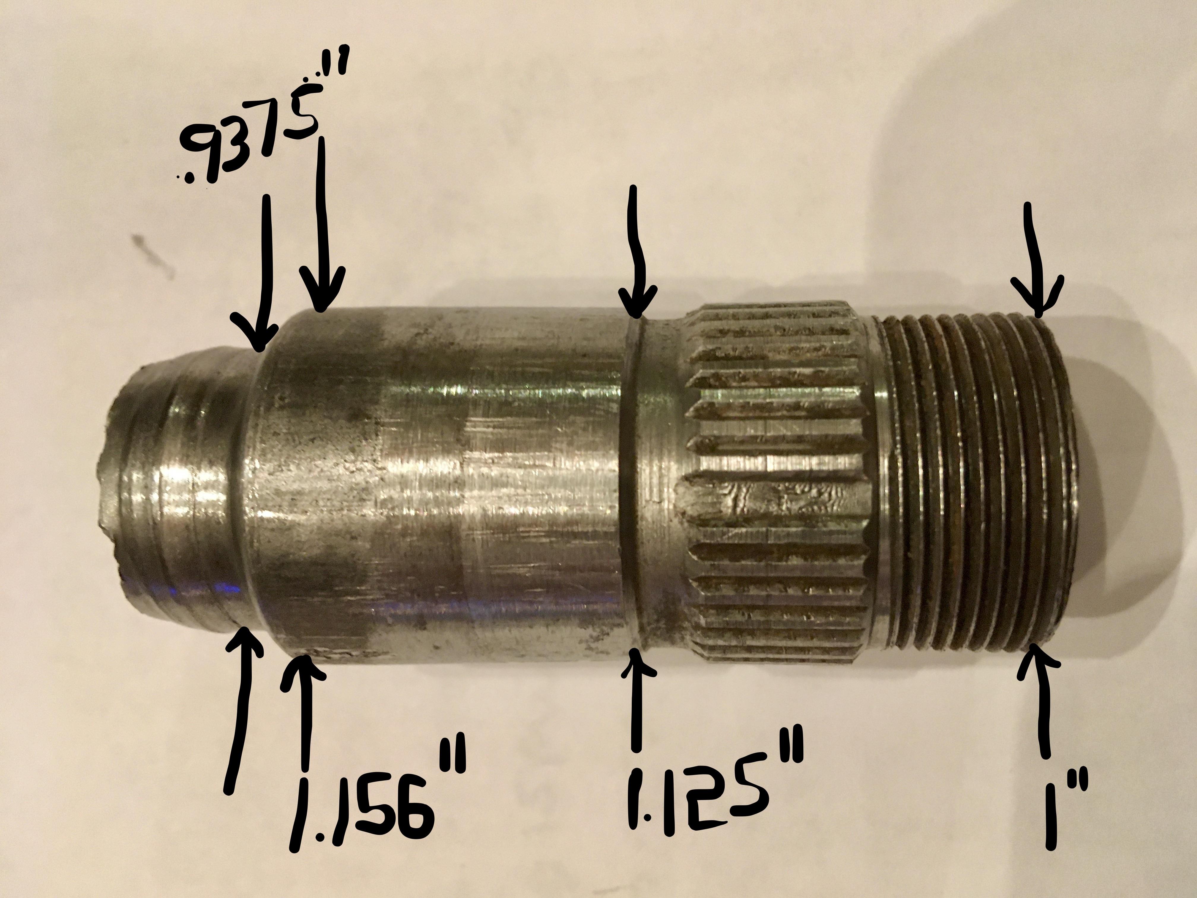

I found some differences in boxes. Just happened to have the box for my B-73 laying on the floor. That shaft is 1.125” OD and tapers to .975 where the u-joint is. The steering wheel end is larger and 1.125”OD as well. It is a Gemmer box and worm and roller, too. A quick measure of the OD should determine what shaft it is.
Matt, Excuse my crude sketch- I got dimensions with a divider
Thread width
Matt,
Excuse crude sketch-used a divider
Thread Width                   1"
End of taper                     1.125"
Start of taper                   1.156"
Inner Bearing width        .9375

I think you have a heavier shaft.  That B-42 shaft only measures1.00” max over it’s length. So your’s is heavier like the B-73. Well at least we know it won’t fit. Sad part for me is that I was saving a really nice, crack free, 22” steering wheel from my B-42 for the B-73. I only recently took the steering column apart for paint and now I know it won’t fit, so back to the cracked one. Crap.
Let me ask around to see if I can find you one.
