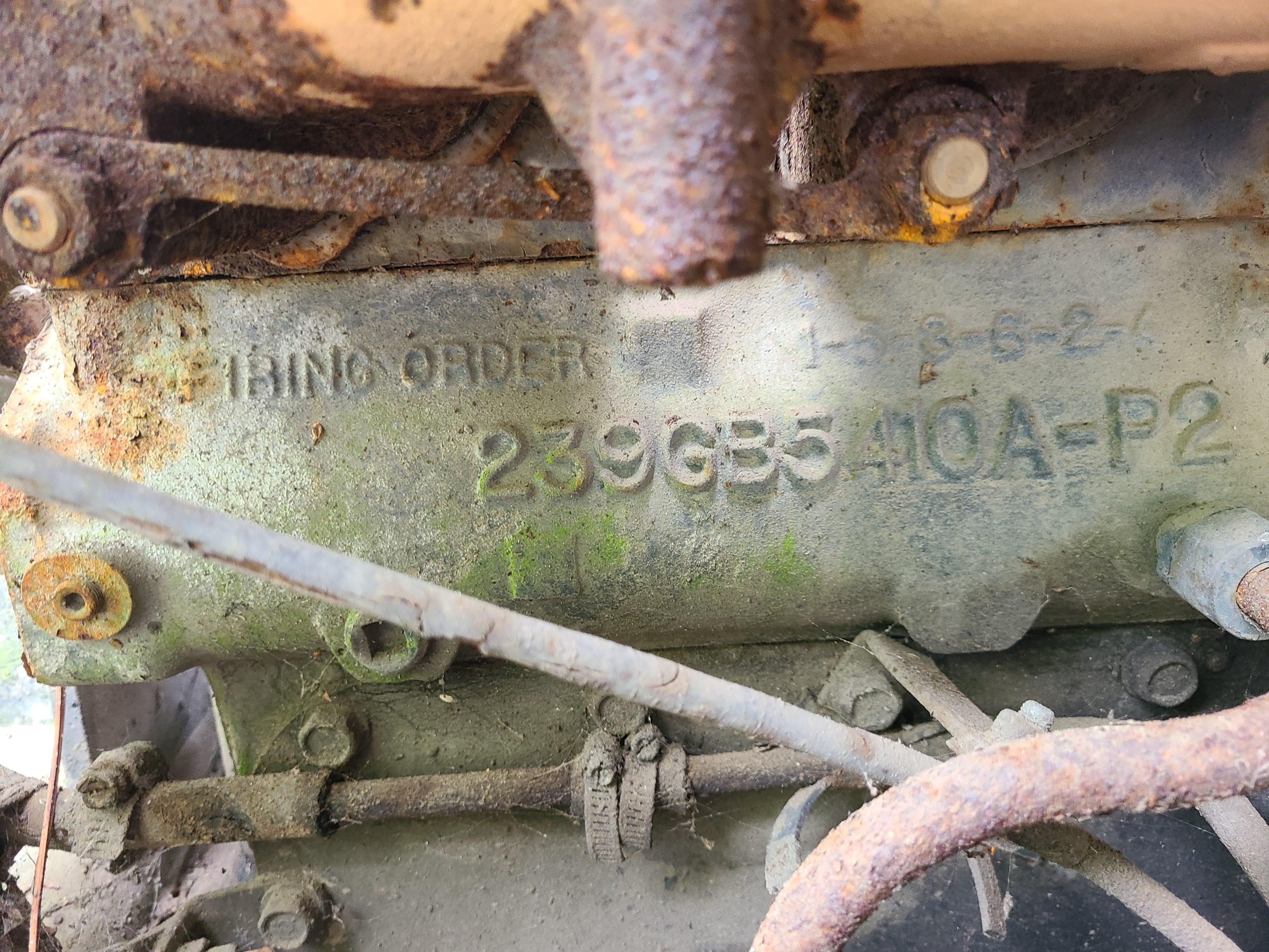

Looking at your pics , I can tell you that it is not a 350 4 valve. It may? be a 350 2 Valve . But I thought they had 2 oil filters plus the rotor . You just have the 2 oil filters .
If you look behind the injection pump ,under the exhaust , there should be an id plate.
Regardless, that motor comes in different hp , all are VERY reliable .

The engine looks like 2V E6-350 which was installed in MH's before 1985. It must have a chassis mounted intercooler in front of the main radiator. Very reliable engine and the most of parts are easy to fing and cost reasonable.

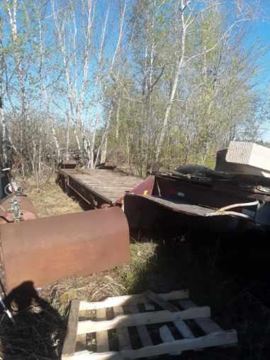

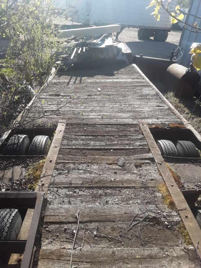

Right now, I am not sure exactly what the plan is. I am documenting it on Youtube for fun but it will for sure go back to work on the Farm at some Point. I ahve a 40 foot flatbed that is goin to go with it.

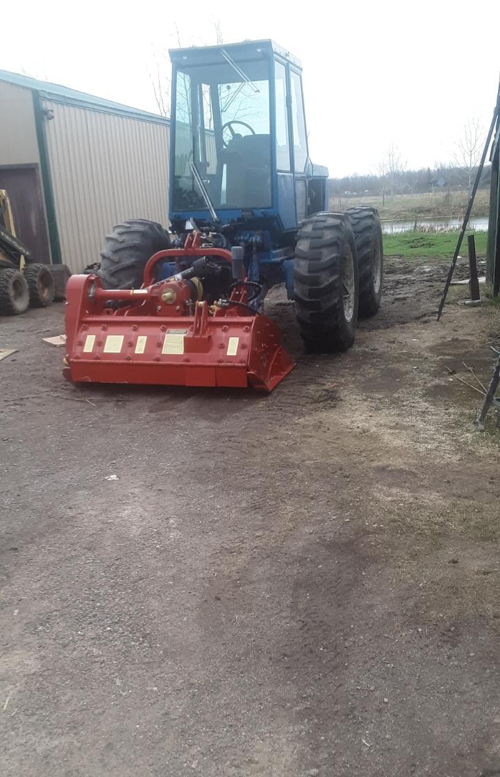

It is actually a Versatile 256 in Ford livery. the PO had all blue so he painted this one to match.

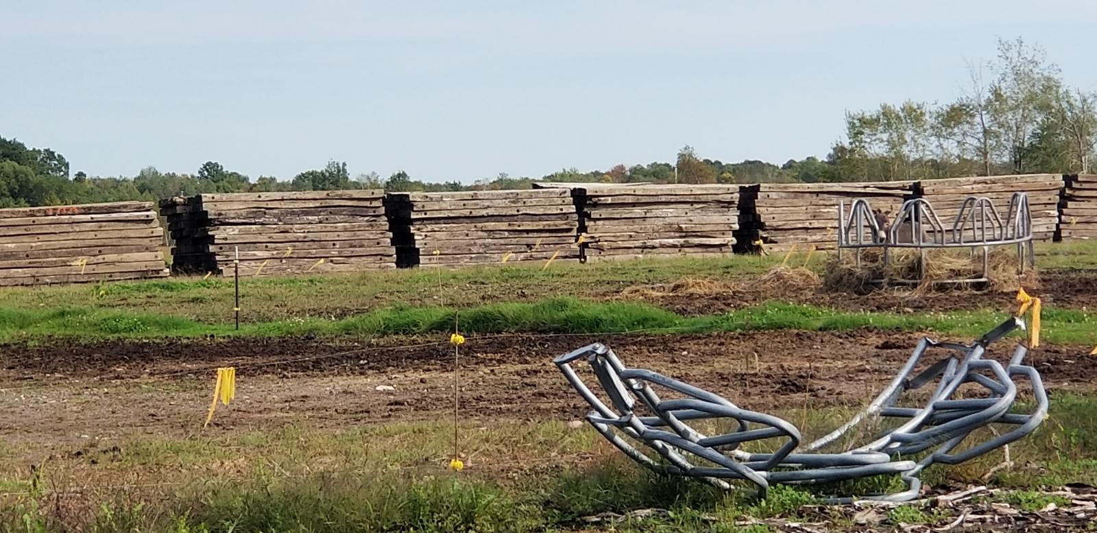

I got the pedal off today but it took a saws-all and 3 hrs to get that pin out. It was completely frozen, I just started pouring lube on the piston.  The Swamp mats in the photo actually came from the utility company, they used them run power line roads but the Army Corps of Engineers made them take them out so I got a boatload.
