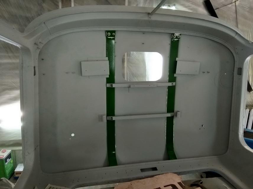

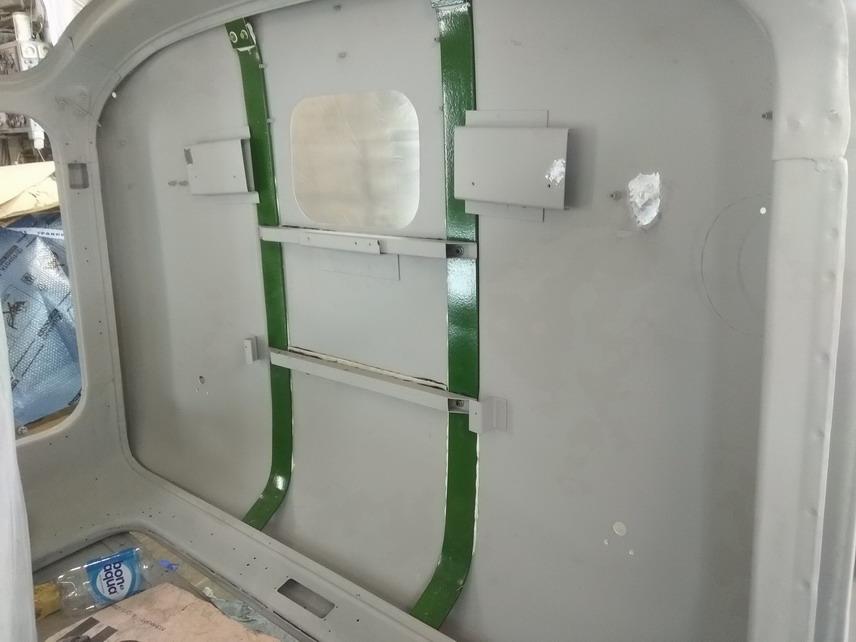

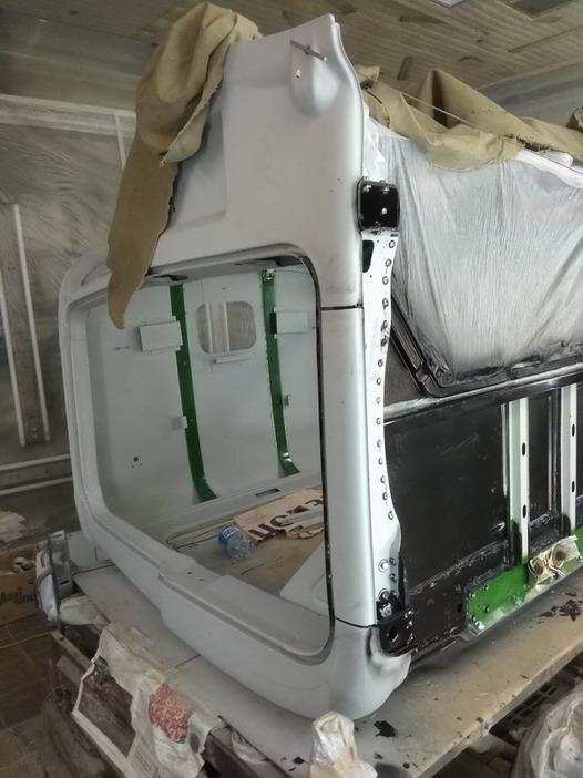

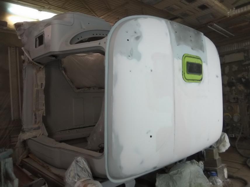

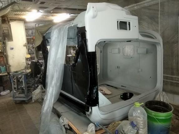

I might be calling the continue as a Part #3 since it was done in a paint shop and mostly by a buddy of mine who enjoys figuring of how some primer or clear coat is better or better to work with and also a big fan of sanding, spraying, polishing etc.

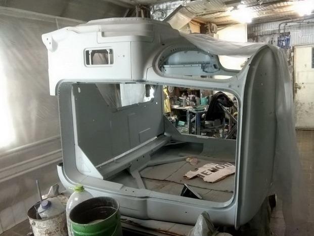

After primering the cab all over with self-etch stuff he applied two layers of another primer-filler off the same line of materials as prescribed by the producent. Than sprayed black acrylic paint onto the bottom covering also the areas which were supposed to be closed such as rocker insides and the rear floor channel. The reason of painting was more efficient water protection since primer is not supposed to resist water. It sure can to some grade and it might be enough by practical reasons but I preferred to double secure the matter since the worth of that additional effort was tiny relating to the whole value of the entertainment.

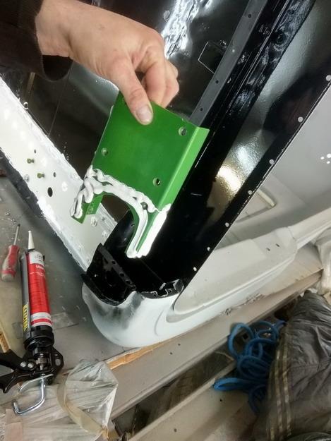

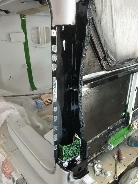

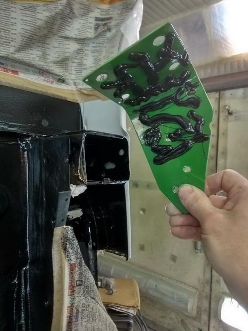

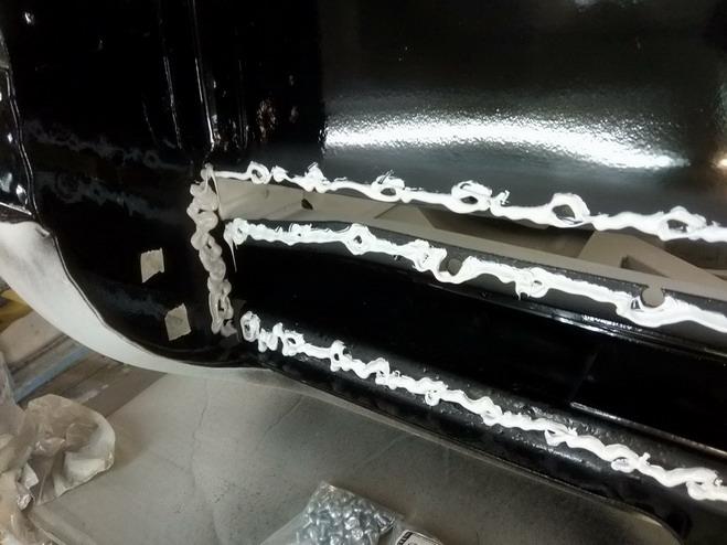

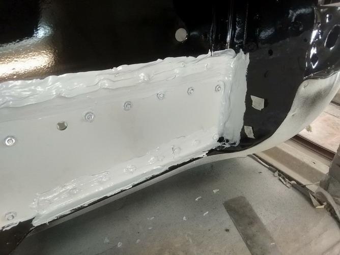

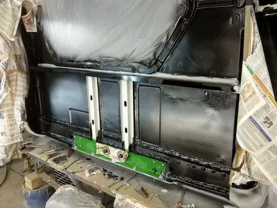

After the paint set hard enough we prepped areas to install a patch to close up the floor rear channel. The patch was also painted but on the side facing the channel inside only. It had happened when a lot of parts was painted it was not enough paint mixed so my buddy saved a bit of paint. The outer side would be painted later anyway so no issue. I just explains this point because the pictures show the patch covered with primer only. But in fact everything was under control:)

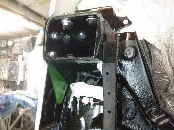

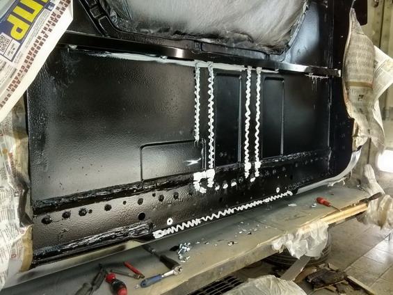

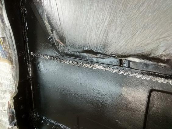

I took my helper guy for two more hands in action. Being 3 in number we applied zig-zags of sealer from a tube, glued up the patch and attached it with half a hundred of 10-32" machine screws and nuts. Than smoothened up the excess of the sealer forced out of the seam by brush and added some onto the screw heads and other spots. Turned out as 30 minutes of hectic work with extensive solvent hand wash afterwards.

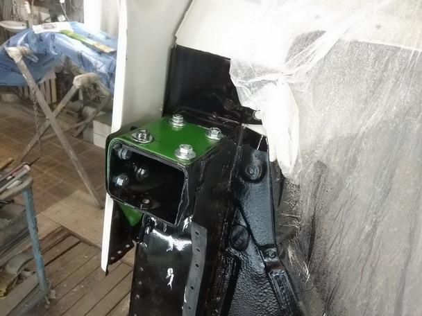

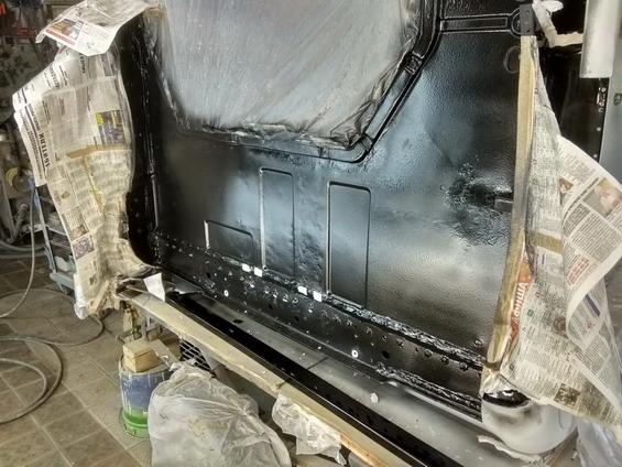

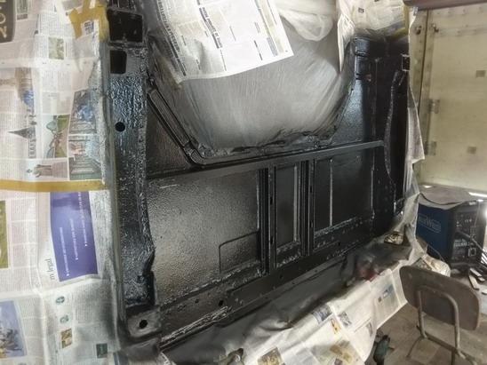

A layer of sprayed sealer was applied onto the floor underside. After that we could install the sub-structure. Put sealer, installed the channels and attached them with bolts and nuts as was designed.

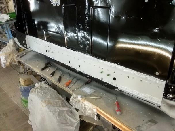

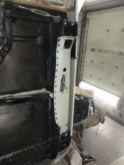

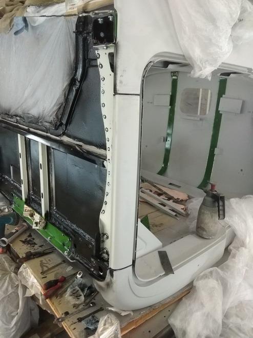

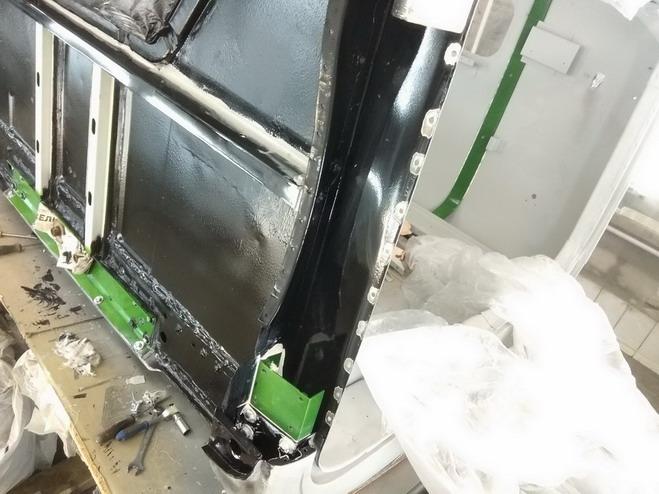

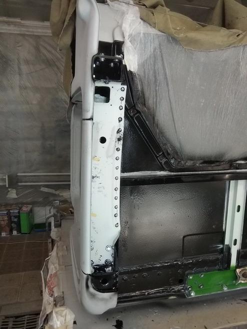

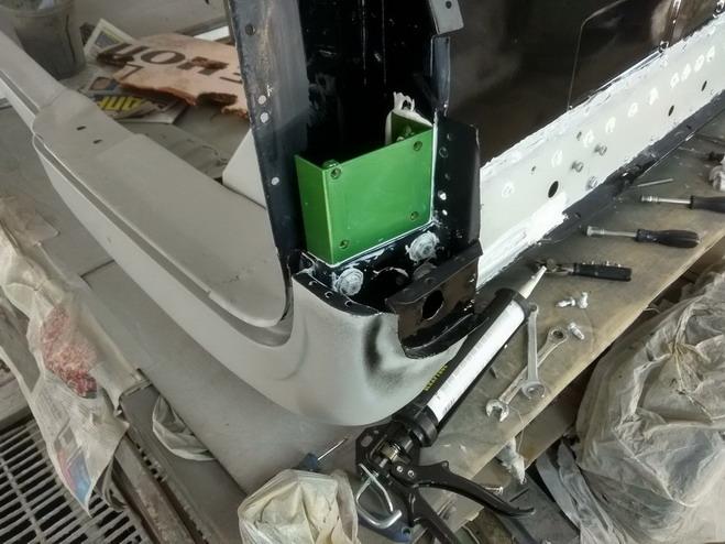

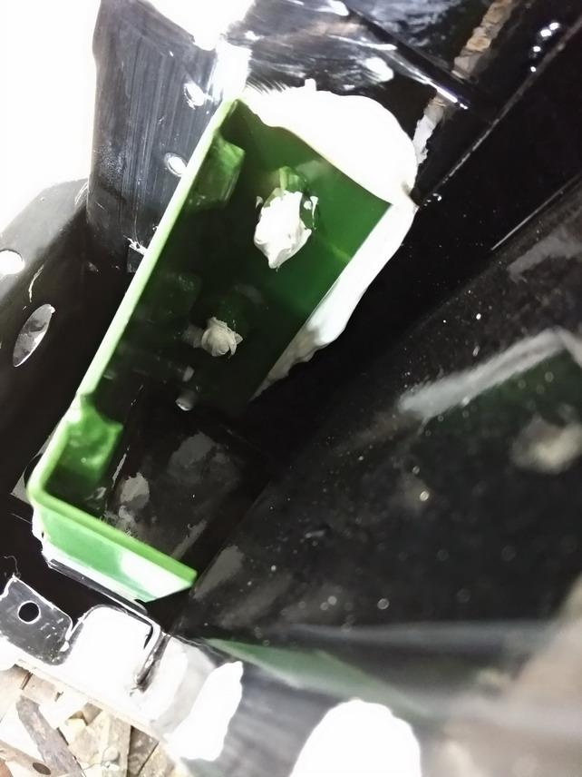

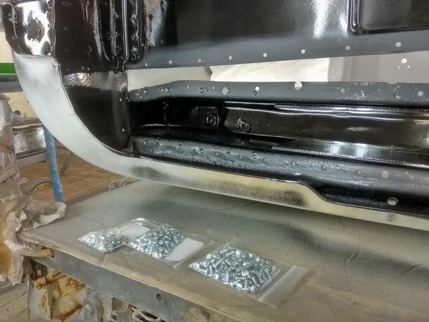

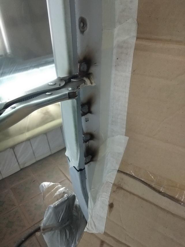

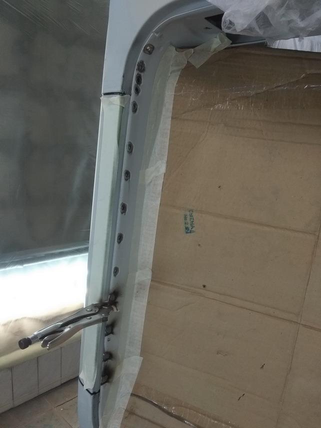

Prepaired to install the rocker panels. There was an issue I couldn't attach the upper edge of rockers to the sills with screws because of no place to hide the heads/nuts. So had to weld them there. Cheered up myself by being able to apply primer to the inside of the seam. Also that area would be along the top of the rocker inside and water collects along the bottom so seemed Ok. Ground paint off over the holes drilled for welds to not be burned up.
The body guy welded the rockers with door sills. Than ground the welds and put self-etch primer to the seam by brush so it spilled all along the gap.
A bit more time passed and the whole floor underside was covered with spray body sealer and than painted for better water protection and easier dirt cleaning.
