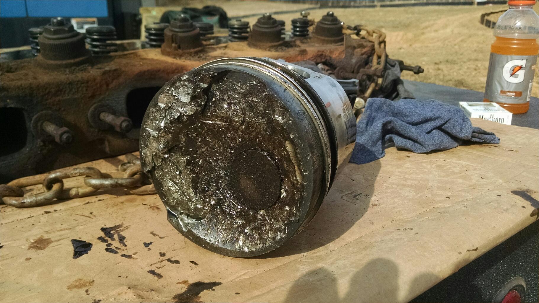

This is a caterpillar 815 compactor I know not a mack or a truck but ..I found this one 5 years ago and took pics to prove it...
Complain of compactor was light tapping in engine but its so loud no muffler hard to hear tap..but I hear miss in engine
Cylinder number 4 on head its one piece head btw
