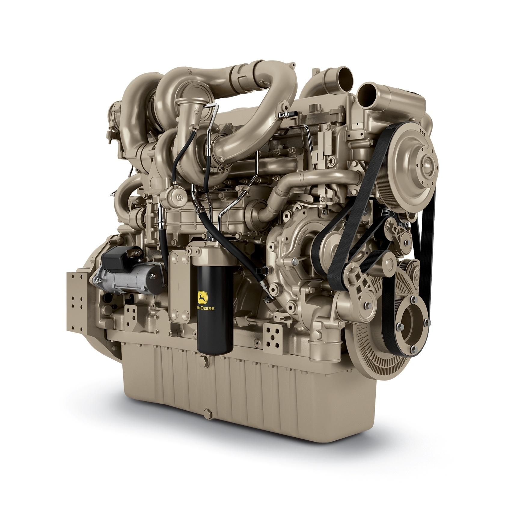

Adapt the John Deere 13.5 liter engine and paint it Gold.  I just calculated the hours of our oldest 13.5. It would have the equivalent of 1,370,000 highway miles on the original. They can top over 600HP. It burns a gallon every every 300 hours, but at 34,000 hours that ain’t too shabby.
Edited by Mack Technician
1 hour ago, Maxidyne said:
Great engine, but can it pass EPA highway emissions standards?
Off Road has caught up since since OTR lingered in final 4. So DEF and SCR equipped.
Had a rookie operator fill the 13.5 engine crankcase with diesel fuel and hammer on it for 40 minutes before his trainer figured out what he had done via conversation. It pitted (starved) one overhead cam lobe at the end of the dinner table. Sent a pic to reman center. Told them the hours and what I wanted to do. They said “Go for it, engine’s old enough to be considered spent for reman, won’t hurt anything as far as future core damage”. I put a new roller arm on and ran it. That was 5K hours ago. Tough 🍪 cookie.
Not much aluminum on the motor. Not built with payload savings in mind like the Mack E platform was. Cast iron intake, cast bell, built for counterweight at rear of machines.
Could consider this the new maxidyne gold tone. Great to see they got rid of the compounding turbo, damn things kept breaking all the exhaust studs like the Mack AC use to. Too much VGT turbo weight. They even dumped the VGT and installed a waste gate. Different block than 13.5 base engine. Oil pan isn't going to work.
Check out the EGR flow from right to the left side single EGR meter valve. Keeping in mind the water pump is lower right side driven by the small belt. The flow through housing makes you scratch your head. First it looks like a EGR charger system, its not, but maybe a second cooling stage.
sorry but  Deere tier 4 motors are absolute junk 8r 9r combines and pickers are the most expensive crap shoot you will ever sit in.  will we thrash to day or does it run 5min and shut down for no reason
We’re pretty happy with ours. We have the JD Service Advisor software and the turn arounds have been fast.
