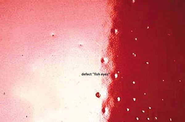

The other thing about silicone is that paint hates it, and any slight silicone residue will result in "fish eyes" in the paintwork which can be a PITA. If you do use silicone or suspect there could be some about then wipe down the primer coat with silicone removing panel wipe (or even diluted household bleach) before putting gloss paint on.
Paul,
Do you mean of applying silicone sealer before putting a layer of primer and paint being put onto? Or onto already painted surface? And which kind of silicone are you talking about? A common gasket sealer from a tube? I'm pretty sure there's plenty of sealers used to apply on body parts for example to seal weld seams etc. Or are those products should be ment as poliurethane, not silicone?
Forgot to mention it looks like you’re having most of your work done that’s the best way if you can’t afford it since most of us don’t have a whole lot of time you wind up waiting a lifetime to see any results I bought marker lights from Amazon and they’re too big but I’m going to try to use them anyway.......bob
On 12/14/2019 at 4:30 PM, Vladislav said:
Paul,
Seam sealer and the like should be polyurethane not silicone. You are right about gasket sealer though as that seems to be silicone based, but applied in small quantities.  What happens with using silicone (the household type) is that tiny flecks and smears disrupt paint applied later
