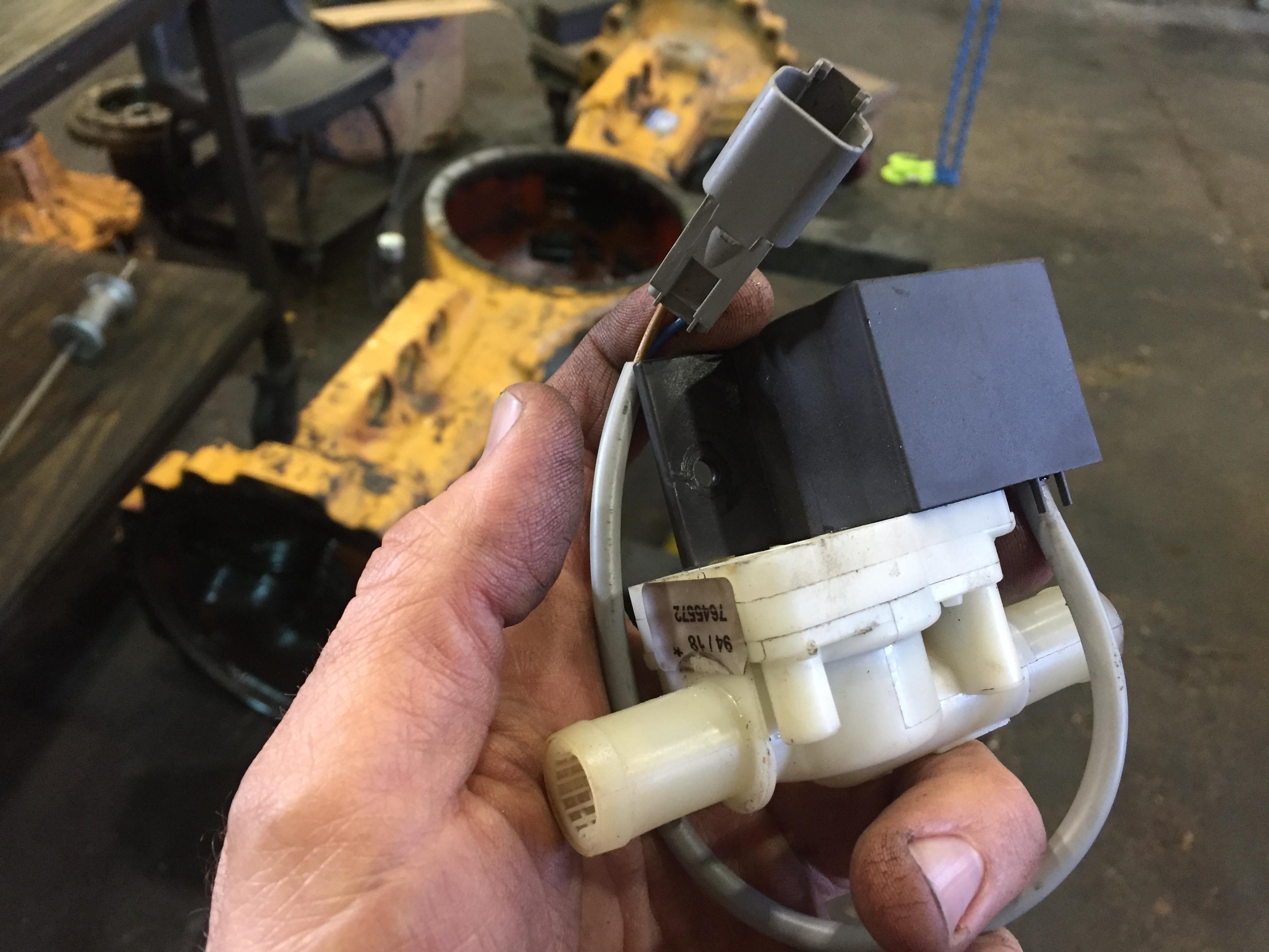

Cheap fix. Change the coolant control valve and make sure it strokes full closed with your dial-dash controller.

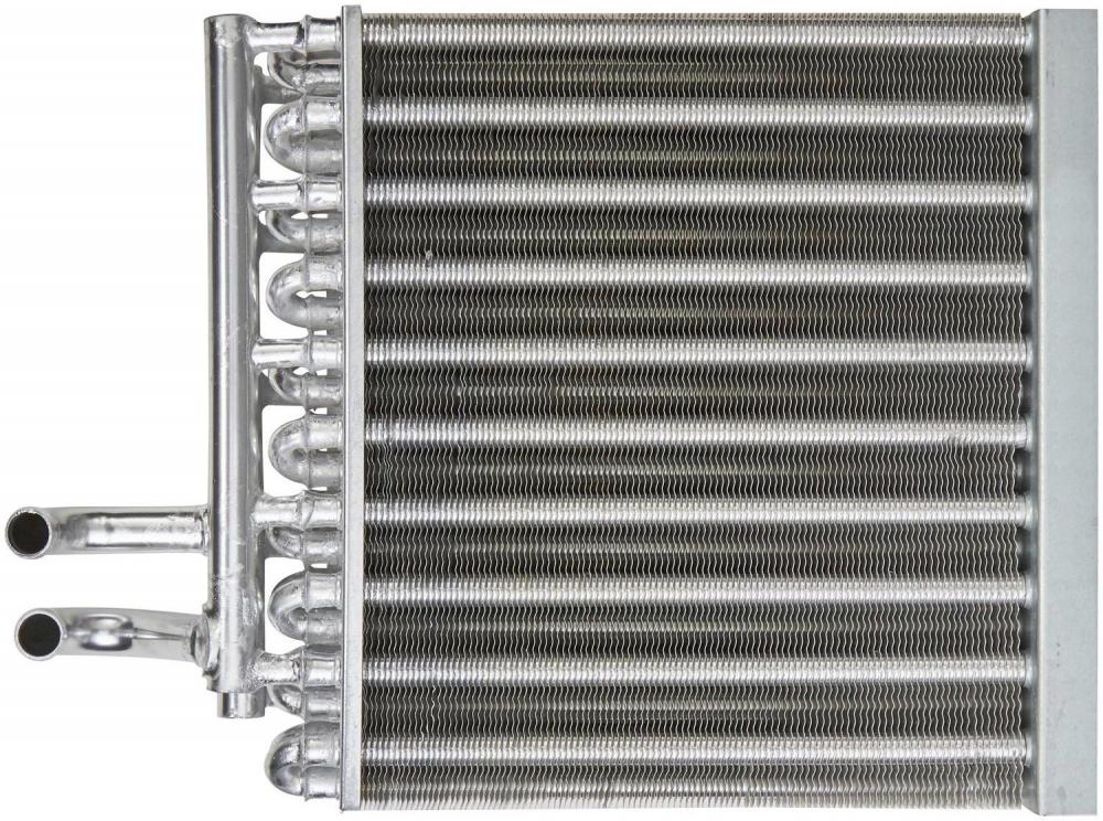

This is the heater core that I have in my truck I want to make sure I have things hooked up correctly also... Can you help me identify the inlet and outlet on the heater core. Is the inlet(supply) on the heater core is the top port? Also from my understanding about the hoses the hose that comes from the block is the inlet(supply) line that goes to the inlet on the heater core. The way you see the picture is the way is goes it goes into the dash of truck when installed
Edited by msbulldog601
Keeping mind here, it’s not about getting better heater core performance. It’s about getting better A/C which means no heater core flow. You can reverse that core and have great heat.
As a general rule you inlet on the lowest point and outlet at the highest point, the dynamic behind displacing air.
Edited by Mack Technician

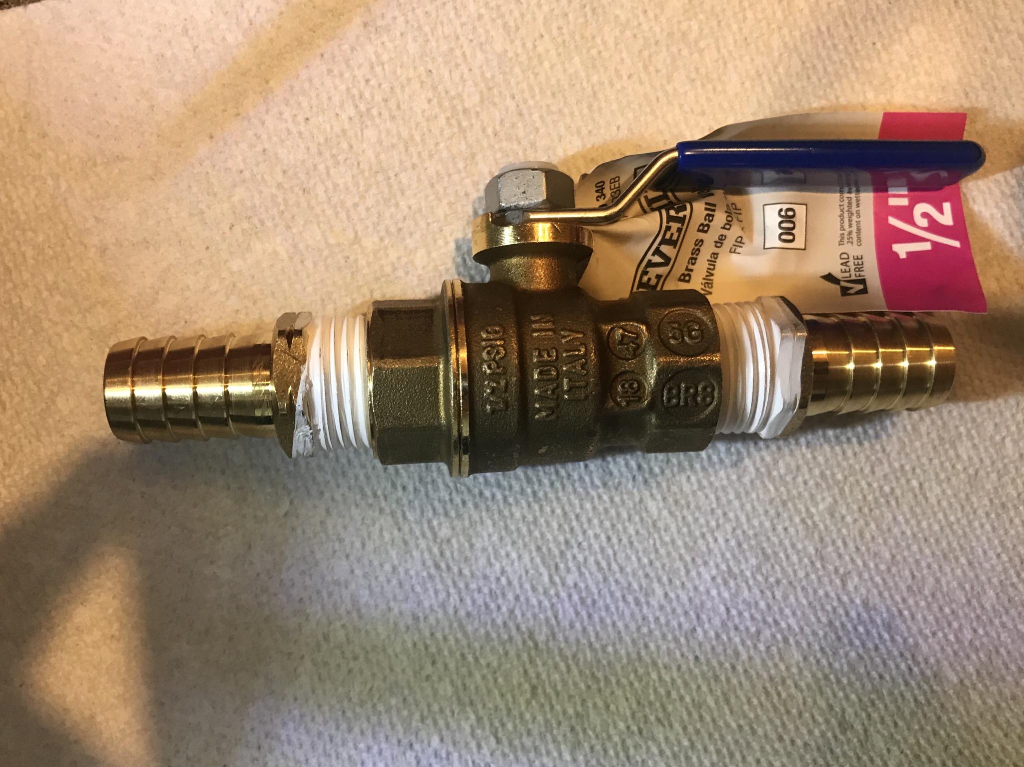

I’m gonna install this manual ball valve on the same line that the stock water valve is installed on just before it so I won’t have to remove the stock one because of the cable that’s connected to the stock valve. What do you think?
It’s a cobble, but it will work. There will come a day when the temp starts to swing cold in the morning and hot in the day. Your going to get pretty damn tired of popping your hood twice a day when you could have just replaced the failed controlled water valve and been done right.

They dont last. The ball valve will outlast the truck. Just rig the cable to it.

I may go ahead and replace that as well just for that reason and season just turn the the ball valve to the open position but I have some insurance(ball valve) installed when it gets back hot when I’m running the a/c.

Hahahaha, that would be awesome. Tell ya what, I’ll apologize and take back my cobble comment if you send me a pic of a successful 1/4 turn valve cable-controlled retrofit.

I mounted my ball valve to the engine side of the firewall. I took the handle off first and mounted it at a spot with a hole. Then I put the handle back on in the cab side of the firewall. Still have to turn it in and off on a cool morning ... but I don’t have to pop the hood. I just reach down under the dash above the throttle pedal. Works like a charm.
