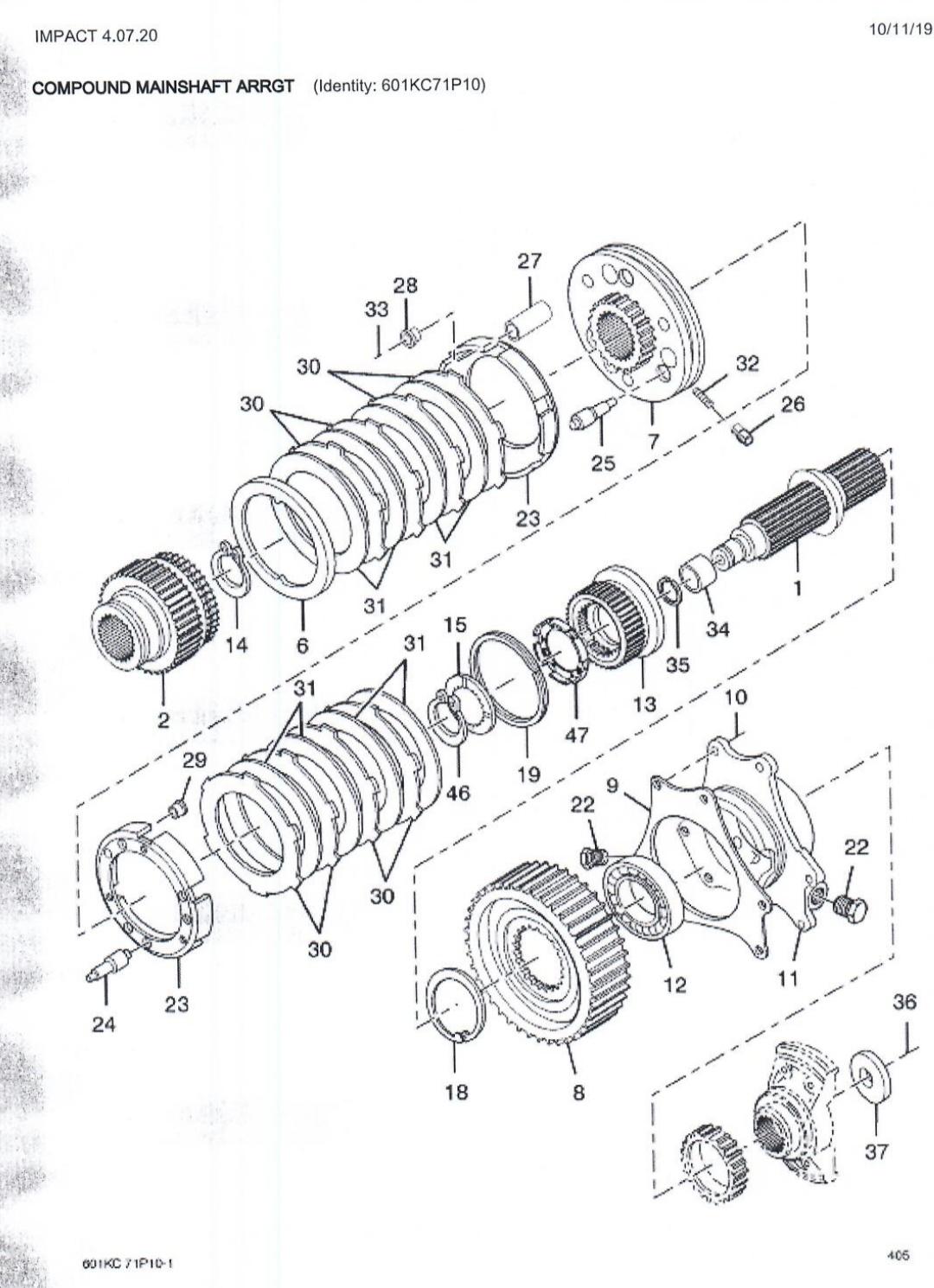

The parts highlighted in yellow need to be replaced?does Pai have a whole assembly for sale?im trying my local mack dealership but I'm afraid all these parts would just add up to a reman unit.
I would, yes. Don't reuse snap rings.
If your paying shop labor rate a guy could easily end up with a reman.
Get your Mack dealer to quote it up as complete and then do the X-over to PAI and see if it's worth it. They have the whole unit part #'s.

I would be doing the work myself..mack just quoted me 758 $for the synchro....parts guy said it covered parts 7 to 19 on the diagram I attached.not sure if that's all I would need...and it's not even here in houston.would take 4to5 days to get.
They don’t make a complete kit for job, so be sure you get the full package as itemized parts. Some of those shifter seals are high dollar if they’re teflon. I wrecked one my last go round, bought another, then went and asked to use the compressing tool at the dealership.
