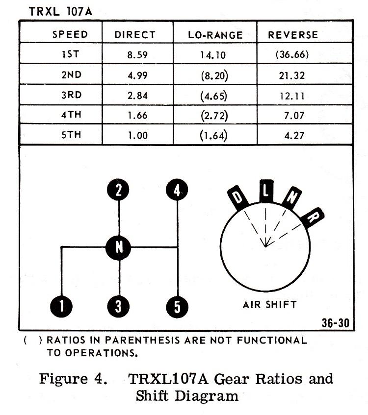

I always assumed the 2 stick Mack trans was the only multi reverse speed trans, apart from Lolo/low/high. What other Mack transmissions can you shift gears in reverse? How recent have these transmissions been produced?
I run a concrete delivery company and multispeed reverse is King. My 8LL is junk, hangs up in gear for a second sometimes even when shifter is in neutral. 8ll is good 95% of shifts, other 5% it hangs up going in or out.
Even the air shifted single stick six speed Mack transmission can be shifted in reverse. TRDL-107A which is a very good transmission also.
I'm going to be pulling a TRDL-1071 from my R-795 pretty shortly. Nothing wrong with it but it needs to go to someone that can use it. 23:1 reduction in low gear. It is two stick.
My mechanical e7-350 needs more than 6 gears, it's a dog at 40k-73,280 lbs on most of the hills here even with an 8LL. I'll keep the 8LL til it blows up, but we'll be building another truck in the next few years. Nice to know what options to look for.
