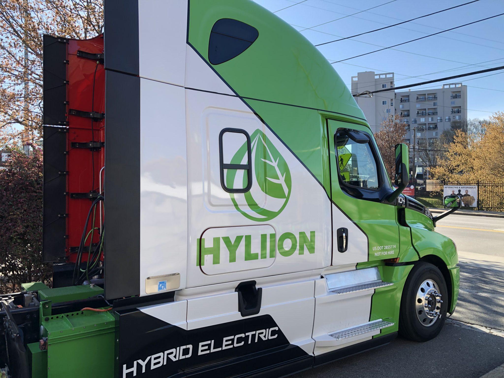

ATLANTA, Ga. – A Class 8 electric hybrid Freightliner Cascadia with the Hyliion e-axle, and a fully-electric Peterbilt 220 with Dana’s electric drive system were made available to the truck press for quick test drives during the spring meetings of the Technology & Maintenance Council.
The hybrid-electric new Cascadia is essentially a conventional 6×4 diesel, converted into a 6×2 diesel with an electric tag axle. Energy is captured during braking and while descending grades, which is then stored and discharged through the e-axle – powered by Dana motors – when the truck is accelerating or climbing hills. This provides fleets with over-the-road fuel savings of as much as 12%, depending on route and terrain.
The second element of the fuel savings, according to Hyliion account manager Matt Gold, comes from the electric Bergstrom auxiliary power unit (APU), which is also powered by the electric motor. It allows fuel savings of 5-10%, depending on which type of APU it’s replacing.
The e-axle provides up to 115 hp and 1,500 lb.-ft. of torque. An algorithm within the control unit determines the output based on grade and terrain. From behind the wheel the truck has the feel of a normal diesel-powered vehicle, but on uphill grades the extra torque provided by the electric motor give it the ability to pull away.
Gold said the target fleets for this configuration are those who operate in hilly terrain and currently idle overnight or use a diesel-fired APU. Fleets operating on flat ground are not likely to get the full fuel economy benefit.

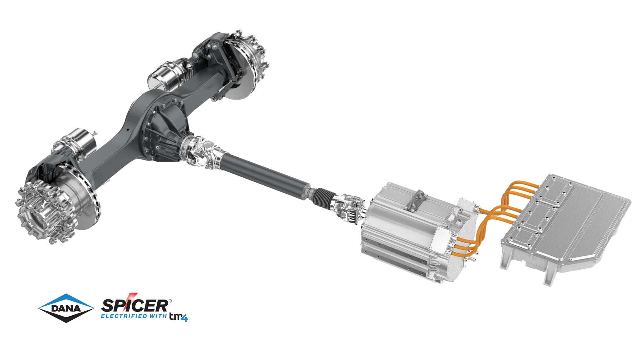

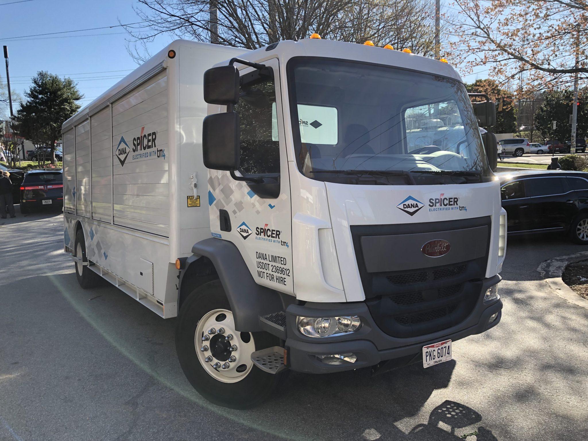

Also available for a short drive on Atlanta streets was a Peterbilt Model 220 with a fully-electric powertrain supplied by Dana, and its majority-owned subsidiary TM4 out of Quebec. The truck was upfitted by Nordresa with an urban beverage hauler body. Spec’s included: a Spicer S130 single reduction medium-duty single drive axle; SPL 100 driveshaft; TM4 Sumo MD HV2600-6P electric motor; a C0200 inverter; and a 93 kWh battery.
The electric motor and inverter were supplied by TM4. The powertrain boasts an incredible 2,036 lb.-ft. of torque, close to that put out by the Cummins ISX15 15-liter engine. The truck can start on a 23% grade and maintain a 20% grade at 20 mph. It boasts a top speed of 70 mph and has a range of about 100 miles between charges. Basically, the truck can do everything its diesel-powered counterpart could do.
Harry Trost, senior manager, product planning with Dana, pointed out these aren’t proprietary parts. In fact, the motor and inverter are in more than 12,000 vehicles in China.
“So, this is production-validated, not a prototype,” Trost said.
There is also little in the way of compromise when it comes to payload. The diesel engine and transmission are removed, and the battery management system drops into its place. Trost said the vehicle weighed 14,500 lbs unladen, which offered pretty much weight parity vs a diesel.
The truck was completely silent at start-up and the torque was abundant upon acceleration. I barely needed to touch the brake to stop, as the regenerative braking brought the vehicle to a standstill while feeding energy back into the batteries.
