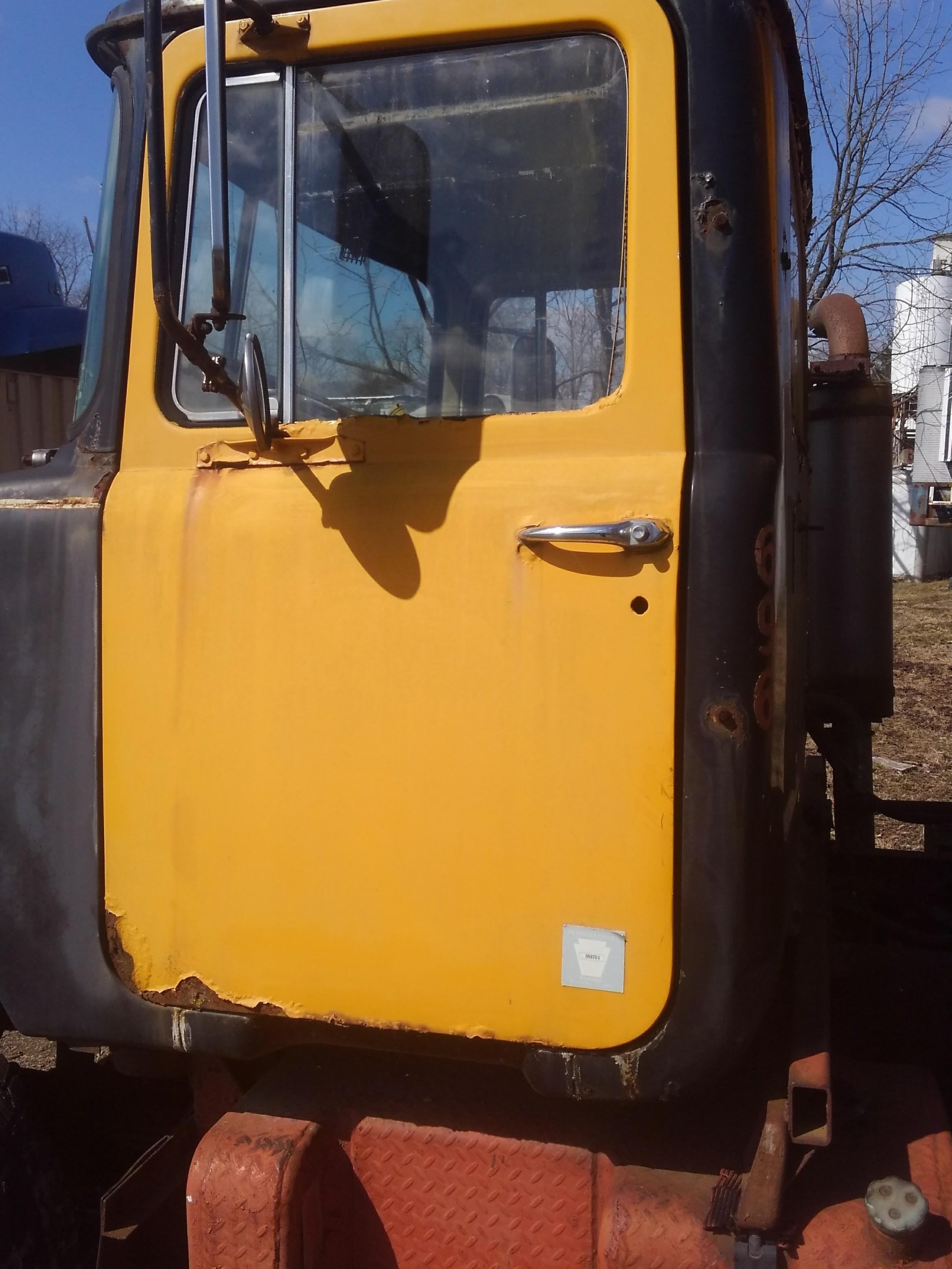

So to throw everything off, here's a picture of a 1976 U685T flatback cab with long handles. Has the tan plastic interior that was used up to the end of the R series.
I think it was indicated that the flatback was pre 1973.
Just noted that Mr Hancock indicated the U model stuck with the flatback cab. Where would I look for a cab designation?
